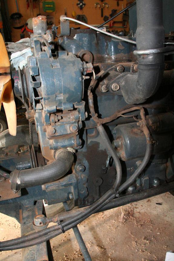

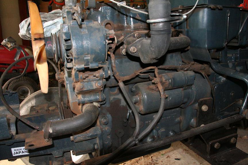

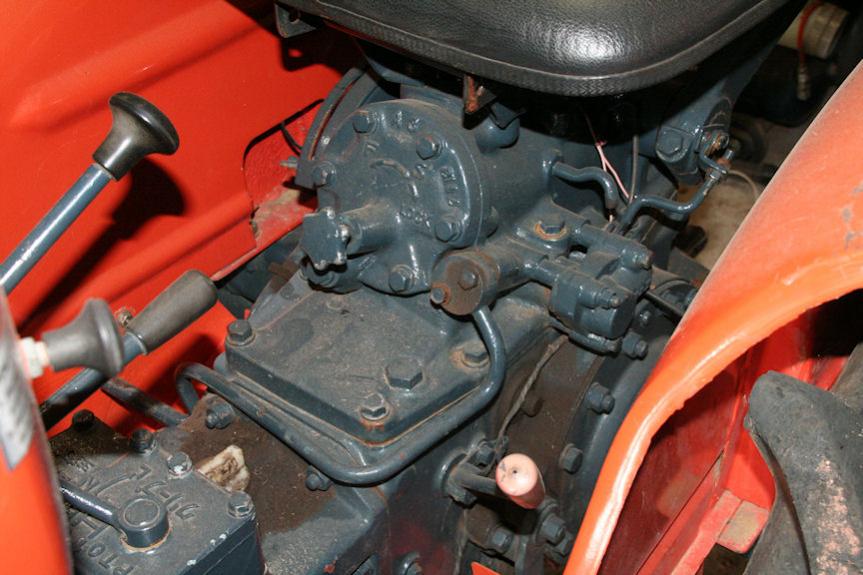

Here's some photos of the engine to see if they spur any other thoughts in you wonderful people.

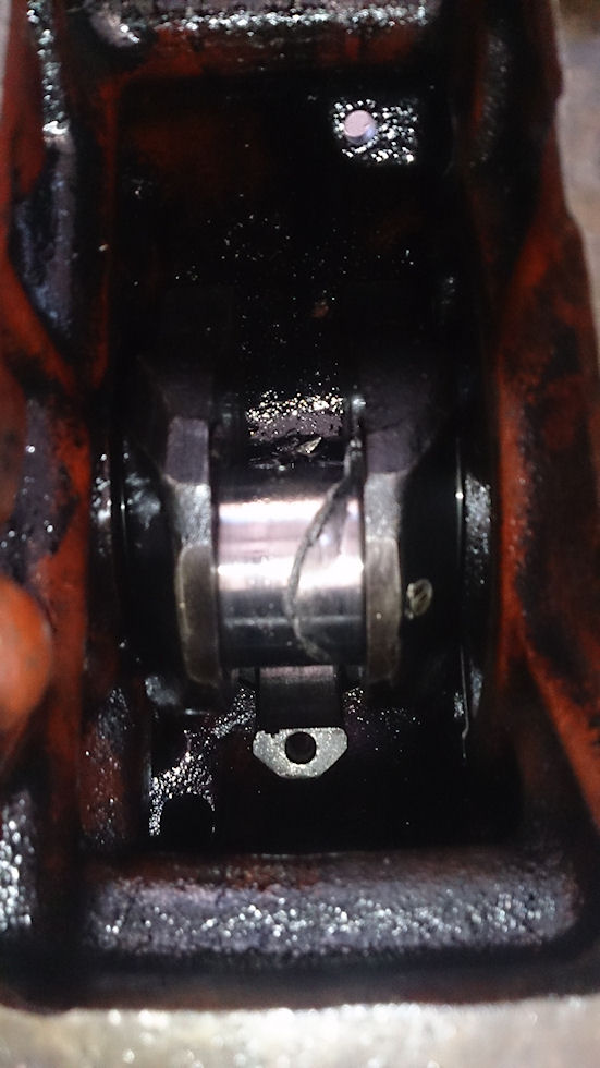

That left a mark -or two. Any damage to the block or was it contained?
The block looks ok - but it looks like it's been on the way out for a while based on some of the wear. There is a lot of metal shavings all through the block.
Which means that not only is the crankshaft busted, and the conrod bushings destroyed, but the cylinders, rings, pistons and crankshaft main bearings are all very suspect.
Which almost certainly means that I'll be better off replacing the engine rather than trying to recondition this one.
