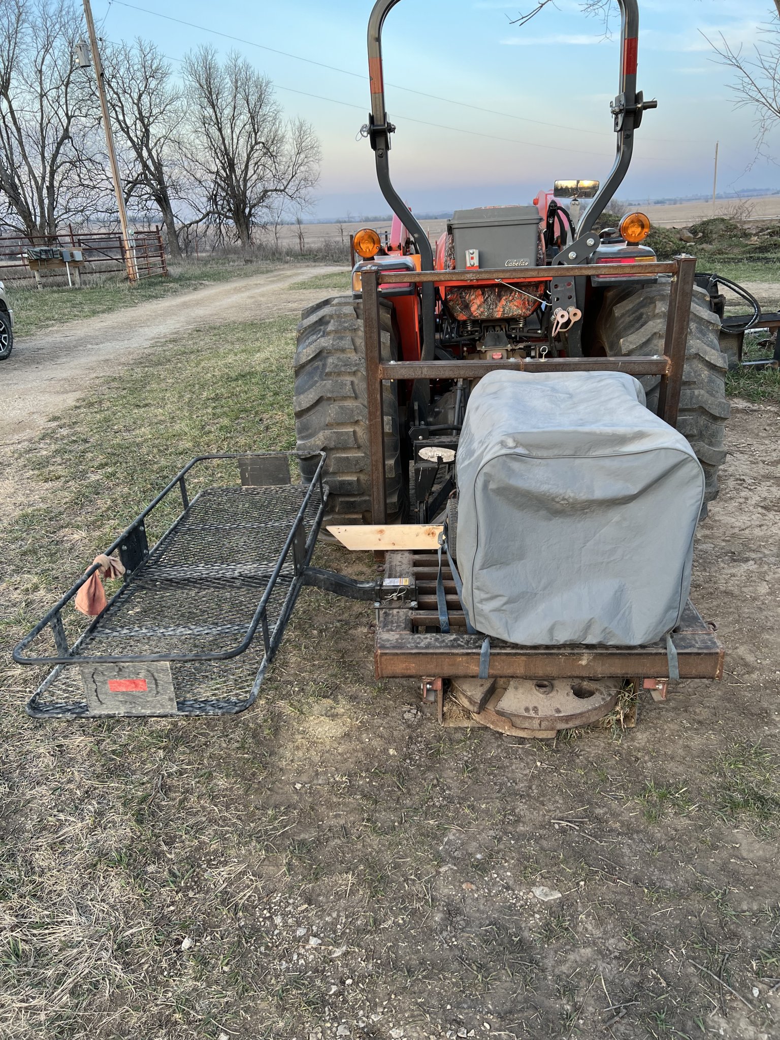

I have some fence to build. Part of this fence is in some hard to reach places. I’m planning to use my tractor to access these places, so I need to be able to carry all the necessary gear with me. View attachment 123771 View attachment 123772

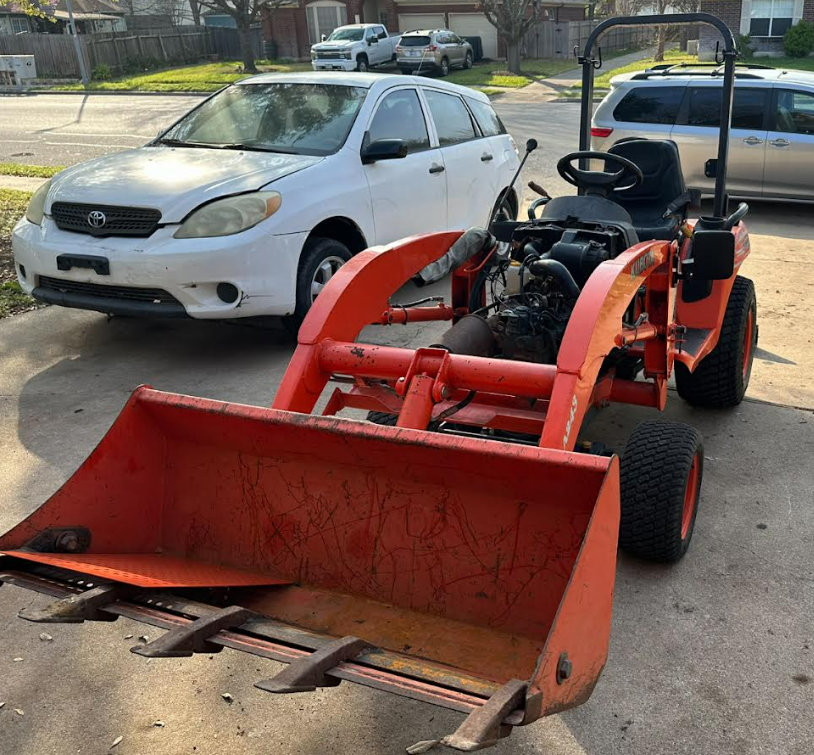

More progress today, confirmed one of the safety switches is bad, now just a matter of which one. Engine turns over and sounds like it has good compression, used a remote starter switch. My initial guess as to what is really wrong was confirmed as well when I removed the fuel line after the first filter and diesel barely dribbled out. The seller complained it was bogging badly.
I drained about 2.5 gallons after disconnecting the other side of the filter. It was fascinating to see the water contamination bubbles. I am putting a new filter and pump on tomorrow. Getting excited!
Hi, been awhile without updates. I condemned the D902 engine, cylinder 3 had some pretty bad gouging and it would not chooch. I found a D722 a few hours away with 500 hours, and after some months its now installed and running great. I would not recommend such an attempt unless you have patience, welding skills, and more patience. The motor mounts had to be cut and rewelded, the radiator fan, shroud sits a bit too high so more cutting was necessary. The D722 oil pan also didnt fit, but after trimming the cross member it now fits. Happy times ahead with a BX2350 neutered to a BX1850. Learned a boatload along the way. Next up is the Toyota Matrix will get a new engine, but who cares about Toyotas on this forum? :)

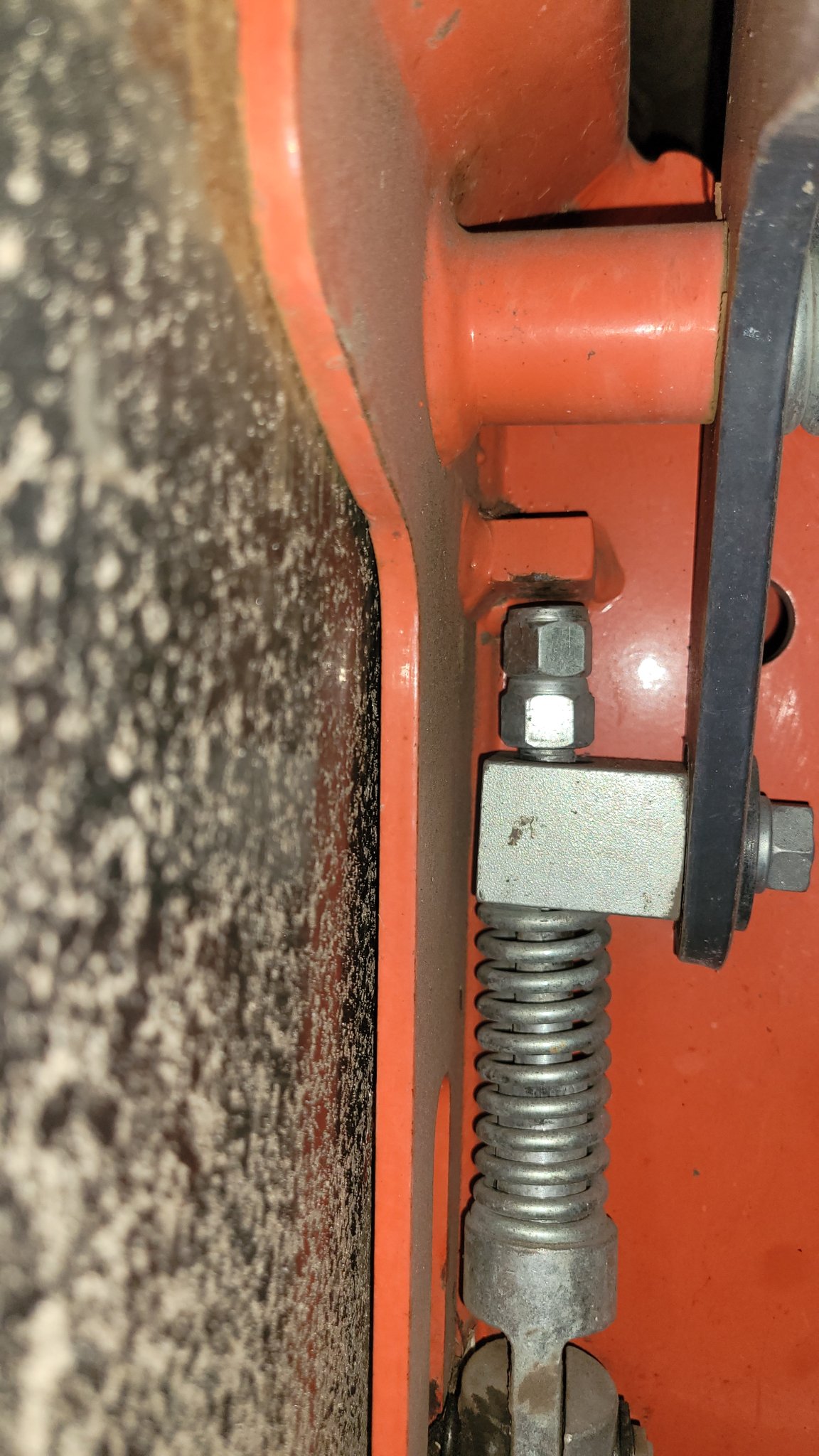

Under heavy loads the locking pins "bounce" a bit, to help eliminate the bad design by Kubota, add a second nut above that spring, I will provide you a picture later, to further explain. Grapple work is notorious for also bumping/knocking the lock lever arms because of wooded stabs or roots pushing through the grapple towards to SSQA. My grapple now has 3/8" heavy plate to prevent debris reaching the locking arms. Additionally, you can also secure the locking levers with some heavy duty zip ties, rated at 150lbs break strength or more.
Adding a 2nd nut on top, helps eliminate some of the pin slop.
Closer look, at me nuts! LOL

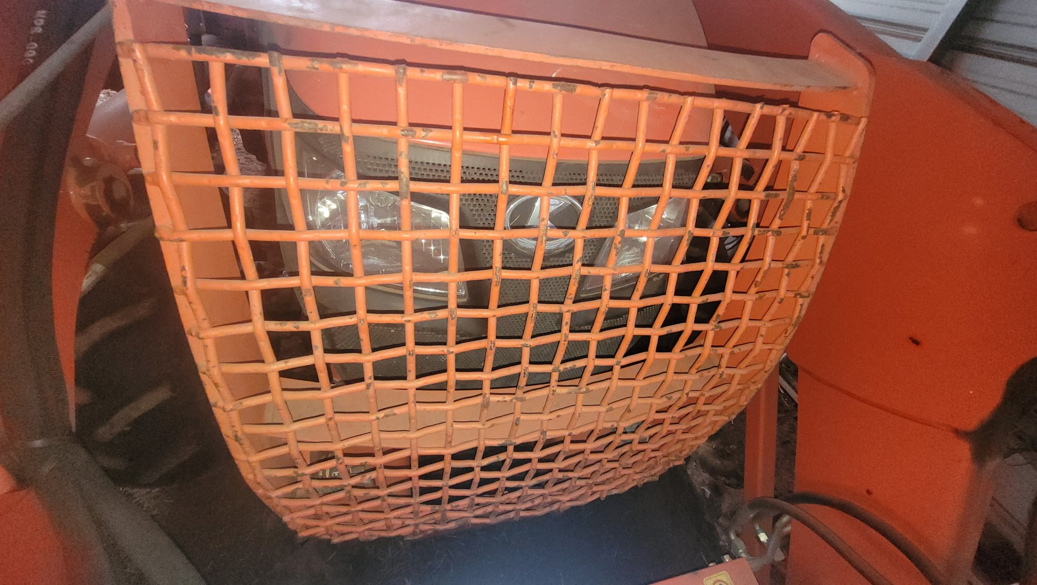

Even with heavy wire mesh, and added plate to grapple, I still managed to get a stab pushed through the cheap grill plastic.

You know the Matrix and the Pontiac Vibe are basically the same car as far as parts go? They were made on the same assembly lines at the NUMMI plant in San Fransisco. You may be able to find parts you need by sourcing from Pontiac or salvage yard Vibes.

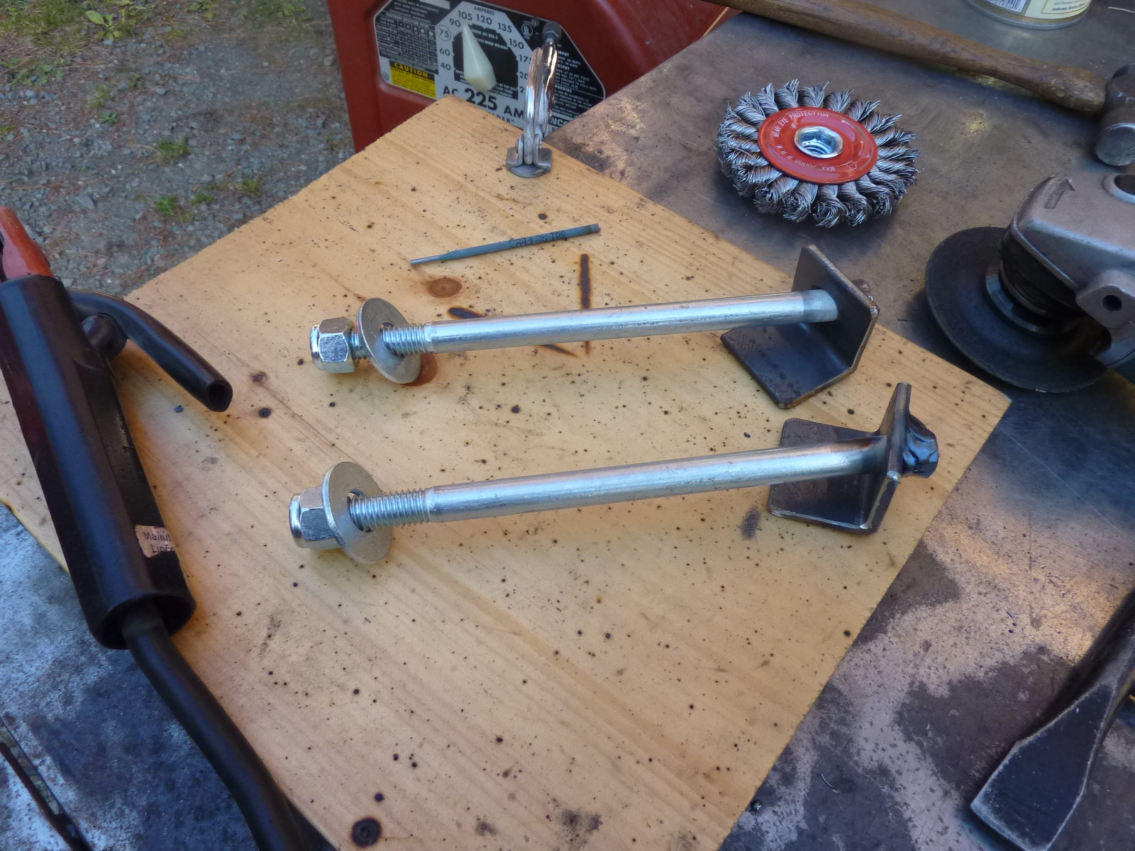

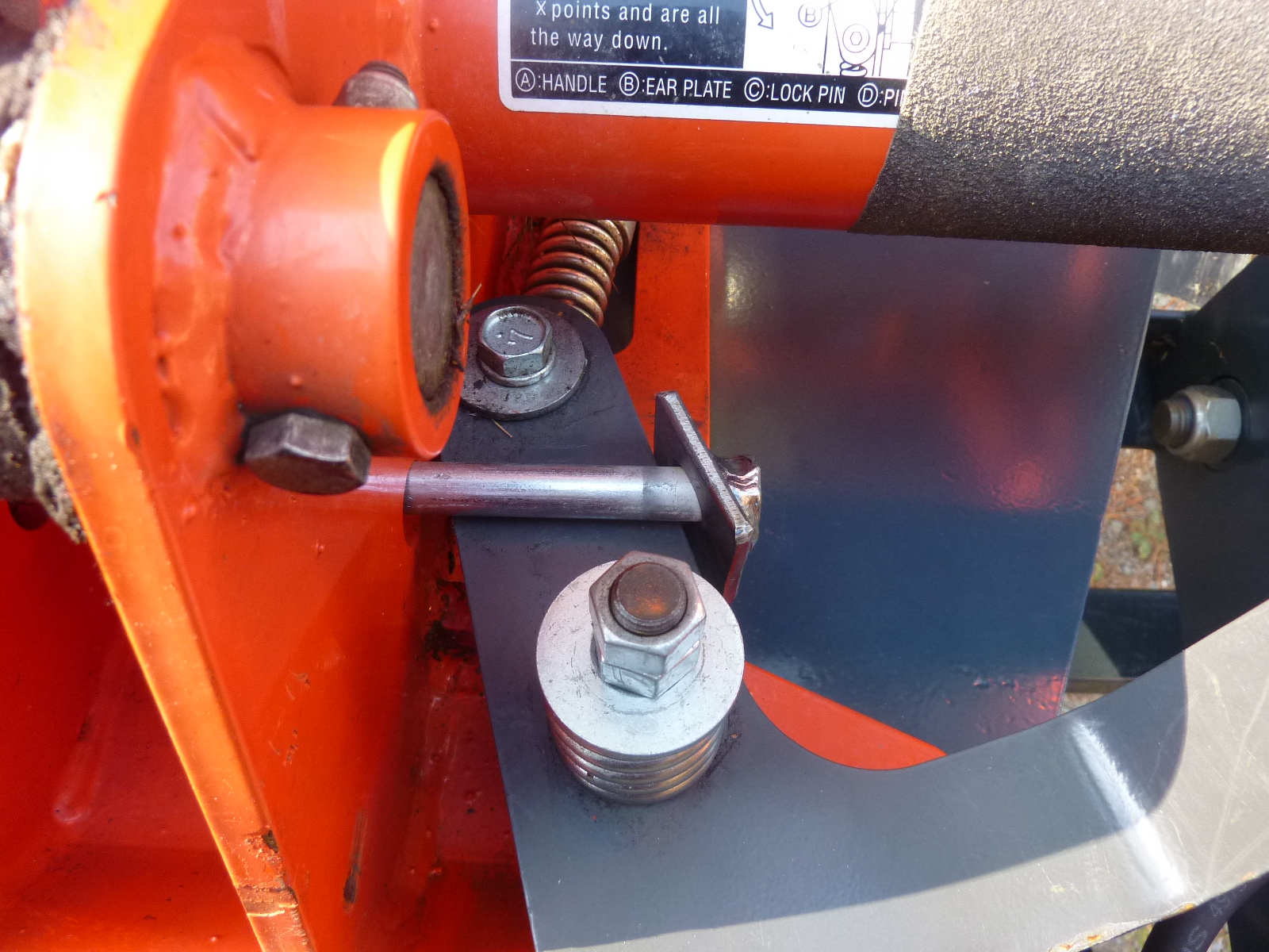

I had some slash push up one one the SSQA lever arms and one side of the grapple came off. I made a couple clamps that hold the levers closed. Long bolts that pass thru existing holes. The pictures show locking nuts but I changed them to regular nuts and I put a hole in the bolt and use a pin to retain the nut. That way I don't need a wrench to switch implements.

Nice fix.
