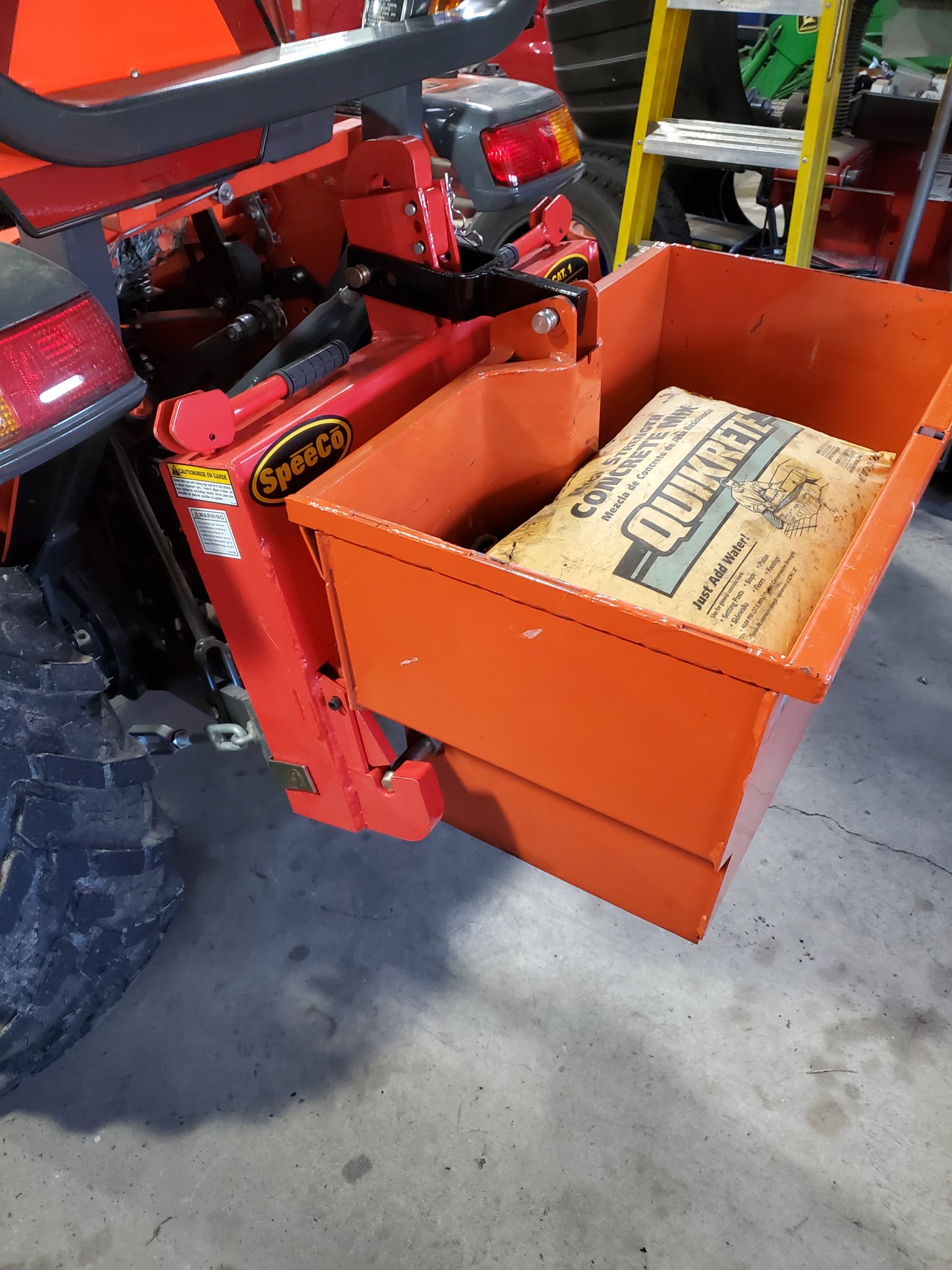

Looking closer, maybe if the top link used a hook it would be further rearward.
He mentioned the QH being close to the lights. The way it is, damage to the tail lights is likely...eventually.
🤔 Is the TL extension necessary?

Yeah, that's what I'm saying. Get rid of the extention and use the hook.
I've heard that some attachments top connection is too narrow for a hook though.

We're thinking alike. That ballast box design is odd. A good side photo would be helpful for our (mine anyway) speculations.

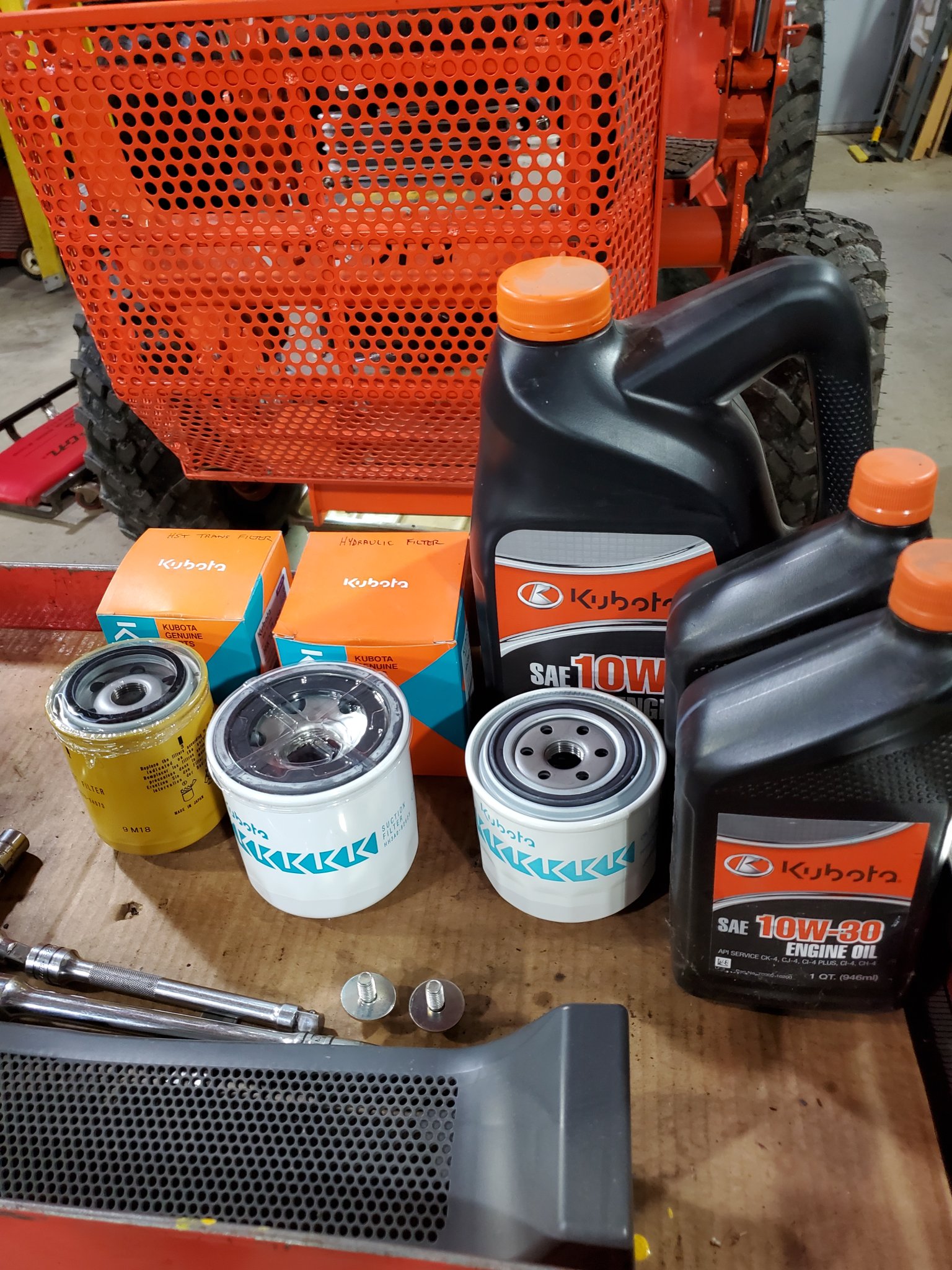

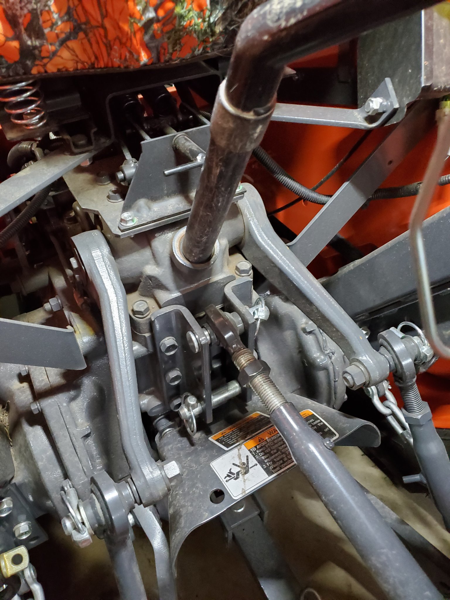

...Once the 50 hour service was complete I got to the fun part. Installing the new SpeeCo Quick Hitch, which I discovered, could take out your tail lights if you're not careful. View attachment 118492 View attachment 118493 View attachment 118494 View attachment 118495 View attachment 118496
Isn't that the old style Kubota Ballast Box - which has been replaced by the WB-10?
The old style (yours) was never intended to be QH compatible. That's why it's been replaced by the WB-10.
It's also why you have your QH tilted so far back and have a top hook-up extension on it instead of a hook.
You'd be better off just connecting that old style ballast box directly to the 3 point.

That explains why it looks odd.
Maybe weld some extended ears on the bottom.

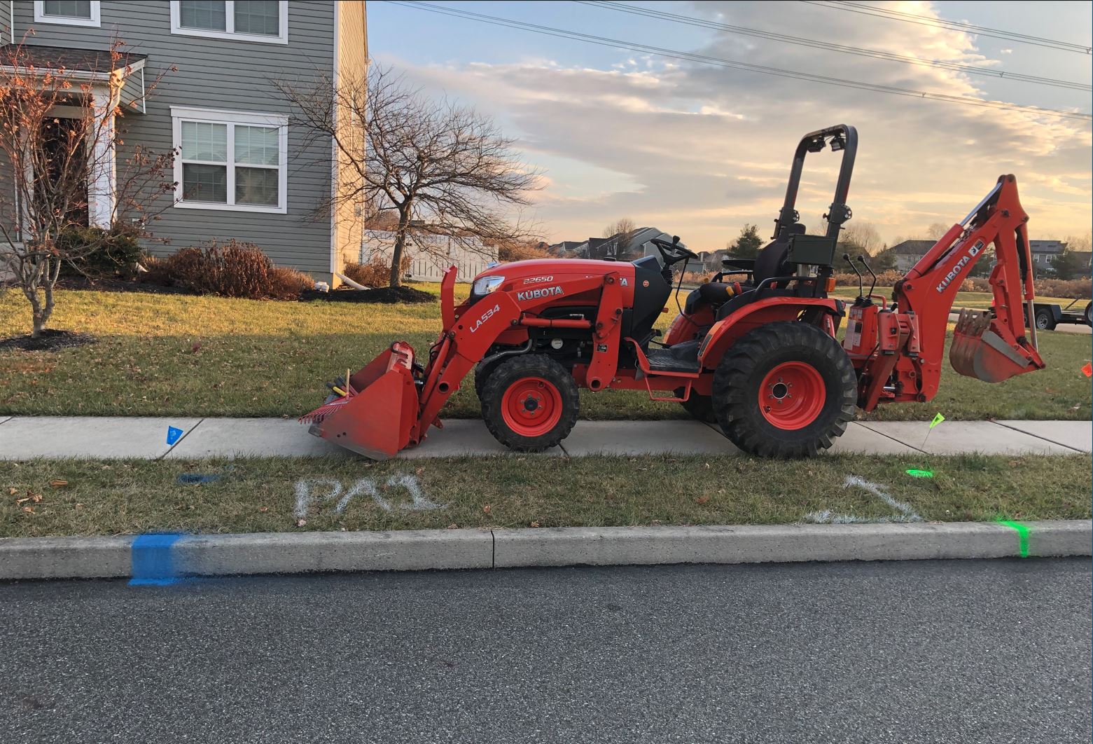

small water service repair this am with the backhoe this time. all went fine.
start
diggy/repair
backfill and done. load up and head home.
Got the google 5 star review before I even made it home. :)

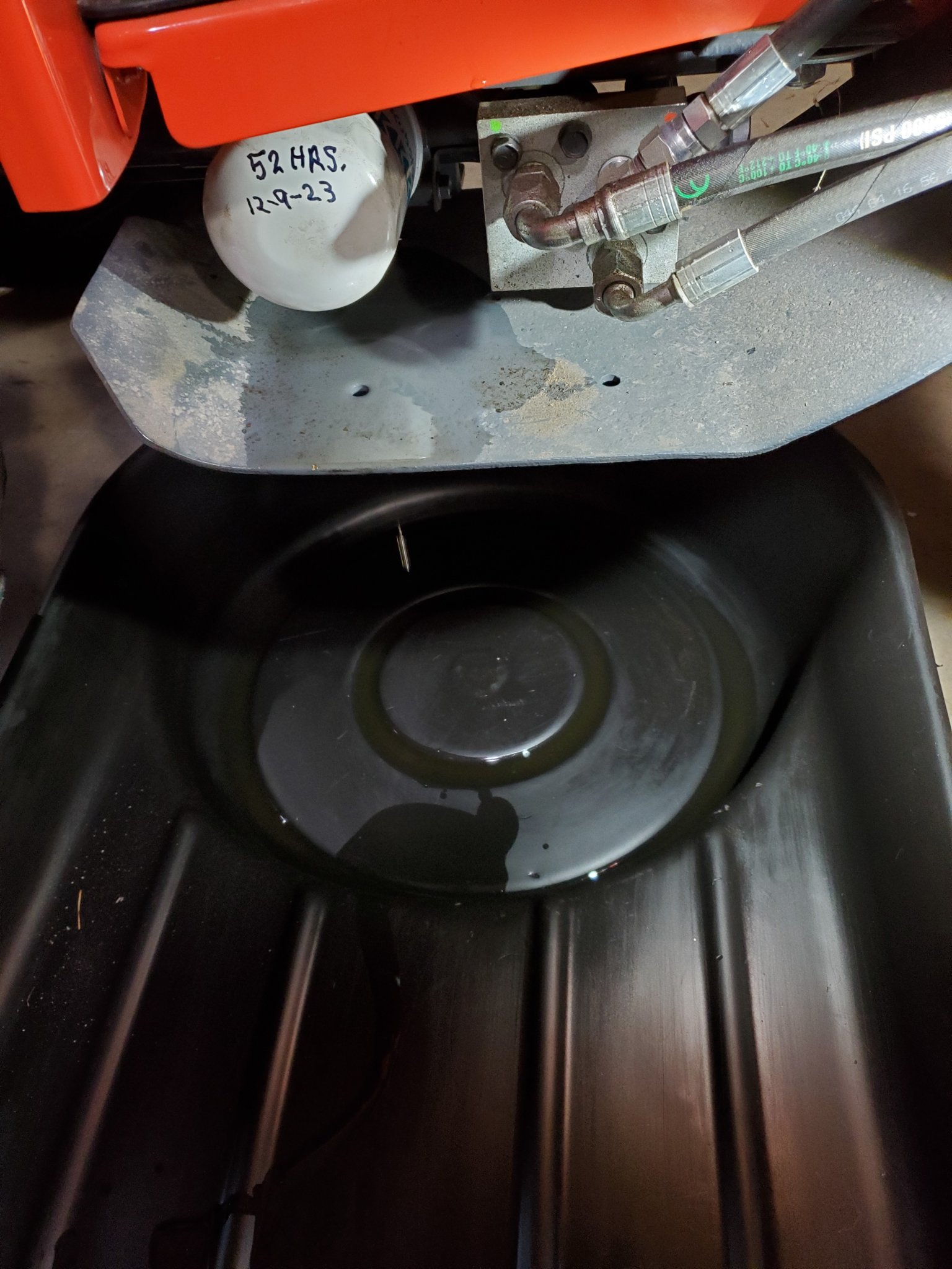

Replaced washers to fix a hydro leak at the pump, added fluid, kicked a front tire, moved firewood to a stack and parked it for the day.

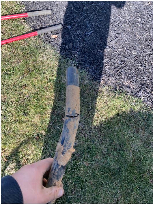

Was it leaking at the first joint near the house?
We added the copper piece. The original poly looks like it sunk/sheared coming out of the foundation (it was almost a 90 degree bend).
here is the piece we cut out that shows the crack in the pipe where it entered the foundation.

Relatively new house?
Backfill settling caused poly to fracture?

yep. 10 years old. I think that they likely ran the water service before the foundation was done. It was deeper than we typically see (like 5 feet). Or it was just a settling issue. Either way its still deep for a water service around here at 5 feet.

The ballast box wasn't intended for a quick hitch or an L2501. It's a "get me by" for the time being and I'm not done adapting it to work better. It's a work in progress. I just slapped it on at the end of a long day.

Often times, around here, soft copper in ran through the concrete wall and out side 8-10 ft. then connected to usually a poly or PVC to meter. The copper is suppose to allow for flexibility with some settlement. The closer to the wall that pipe terminates the greater chance of a leak there.

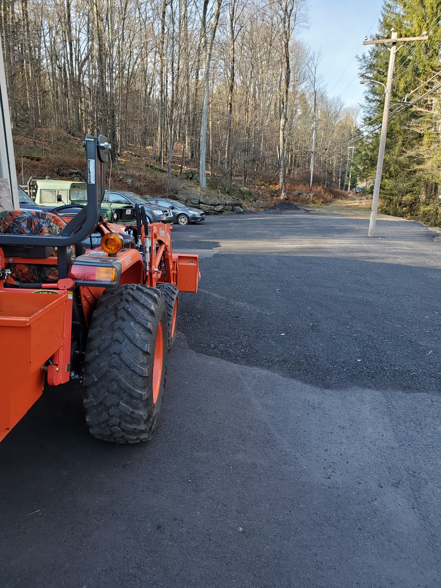

Three tandem loads in my area would cost a fortune.
You must have a crusher nearby.
Looks nice!
Thanks!
There are a couple quarries nearby, but it still cost a lot. I think five hundred some per load. When I did other part of the drive a few years back it was $300 per load 😳
