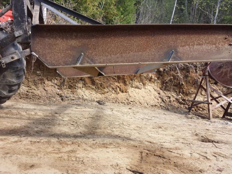

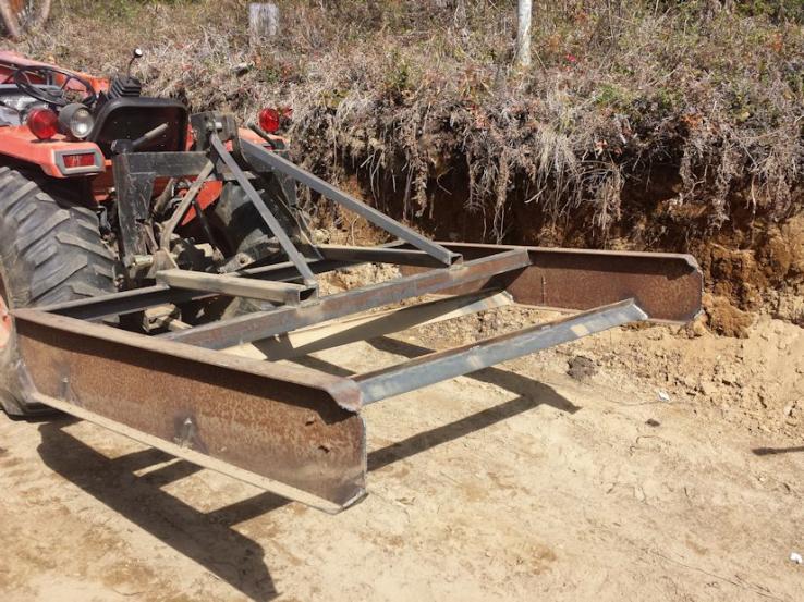

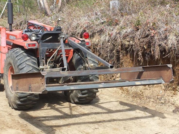

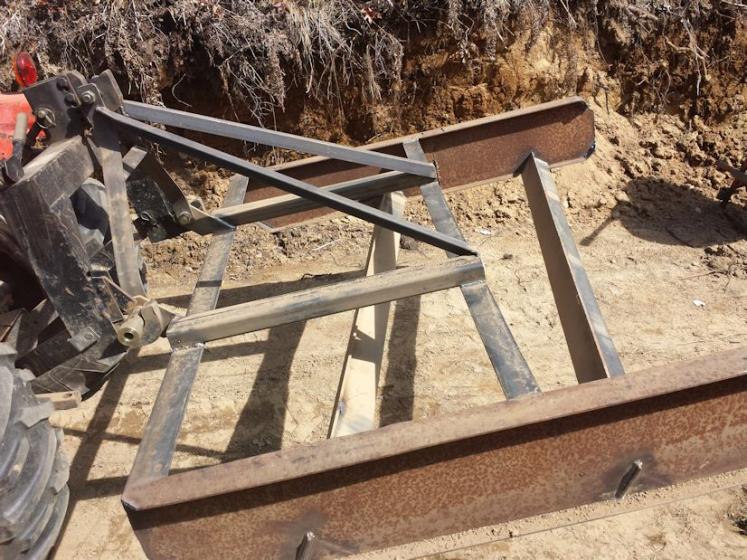

Got tired of bouncing up and down the driveway so off to the scrap pile and back to the welder.
TADA... Land Plane on the cheap! :D
Blades are AR500 so they will hold their edge extremely well. ;)
34,258
9,474
Nice build. How wide is she? That's next on my list of implements.
72" wide 58" long
I'm not far from doing the same thing. How are the blades positioned relative to the skids?
First blade starts 1 foot back from the front on leading side and 2 foot back on trailing side and 2 foot between the blades.
Blades are set at 30 Deg angle.
