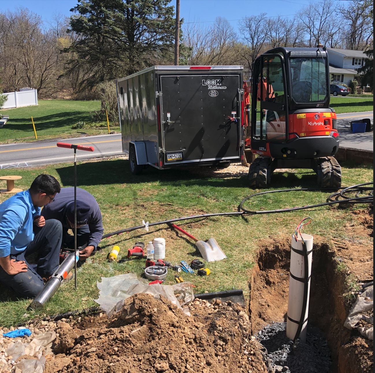

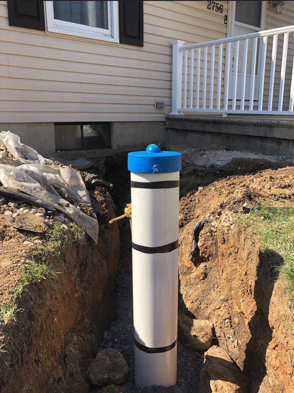

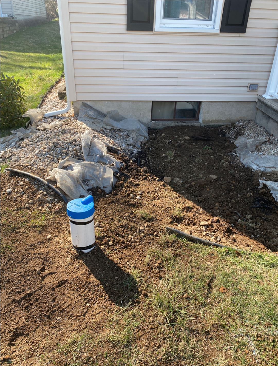

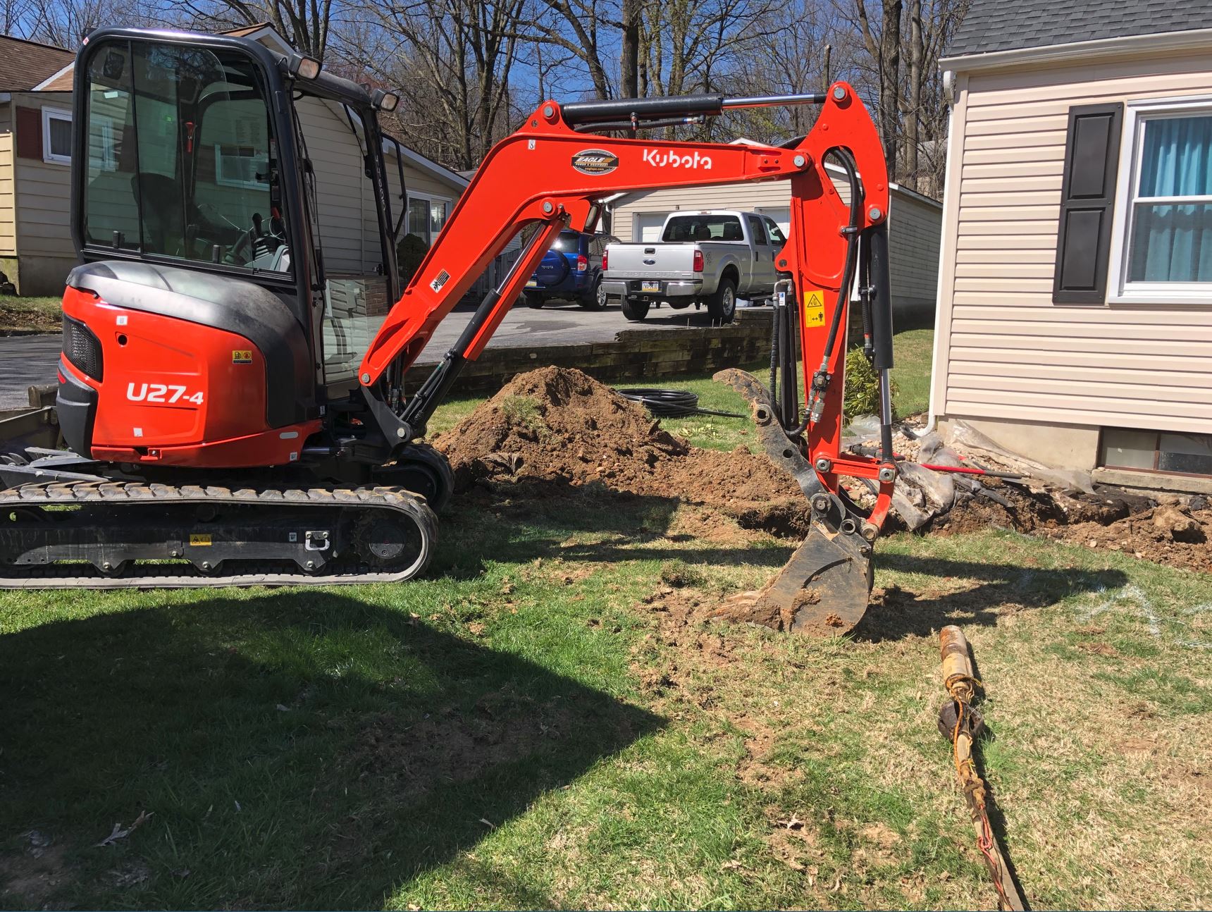

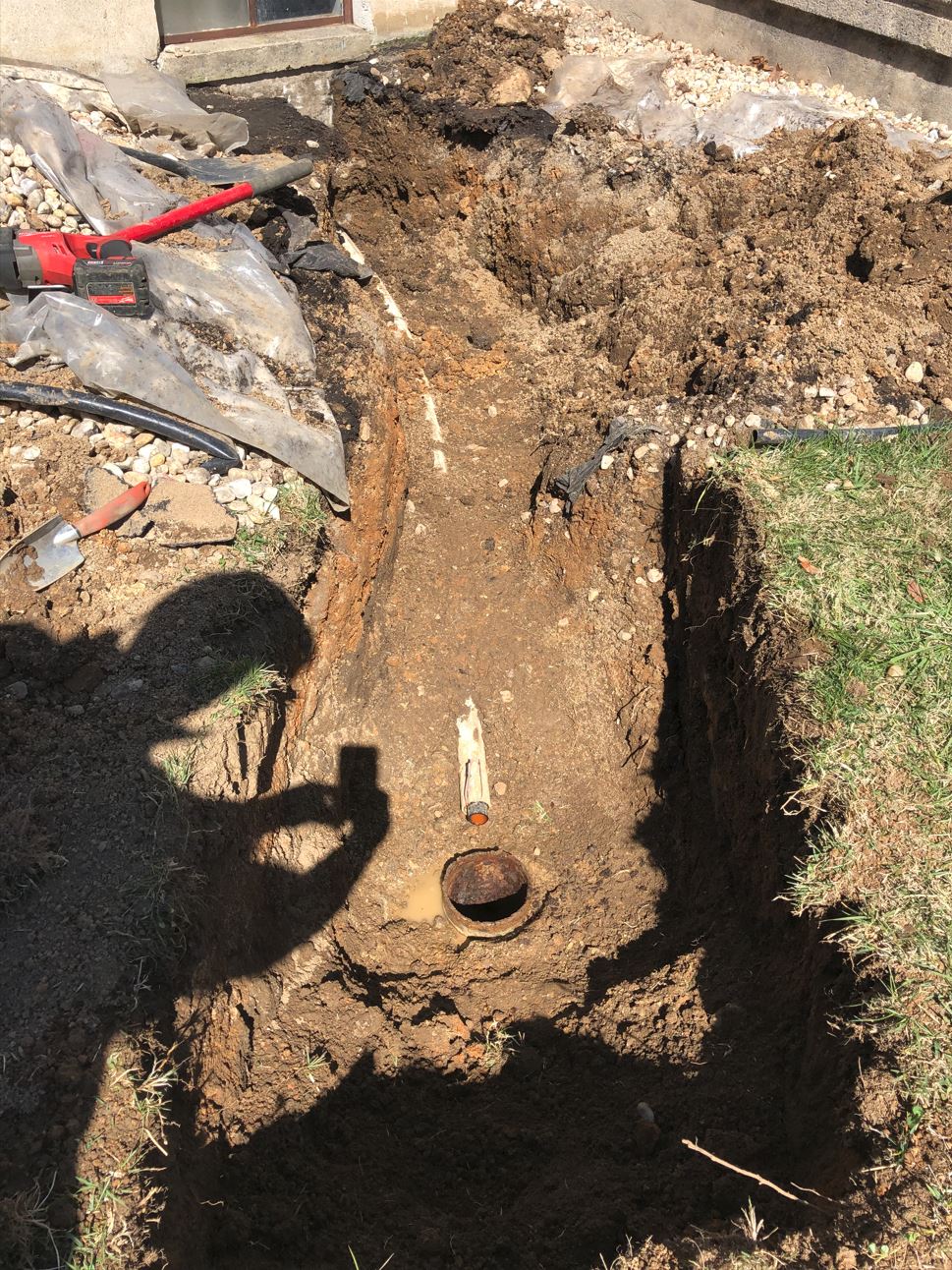

Installed a new replacement well and line today. Had to dig from the foundation out and follow the line in order to locate the well. Home owner had no idea where it was located as nothing stuck up above the ground and no pit could be found.
...found it
fabbed up some 6" pvc so the we could add a pit-less adapter.
some backfilling...and done.
The little mini didn't even break a sweat. On to the next one. ;)

Is it common in your area to find a (6"?) well like that completely buried (no pitless)?

Now they can stick a wooden well on top!

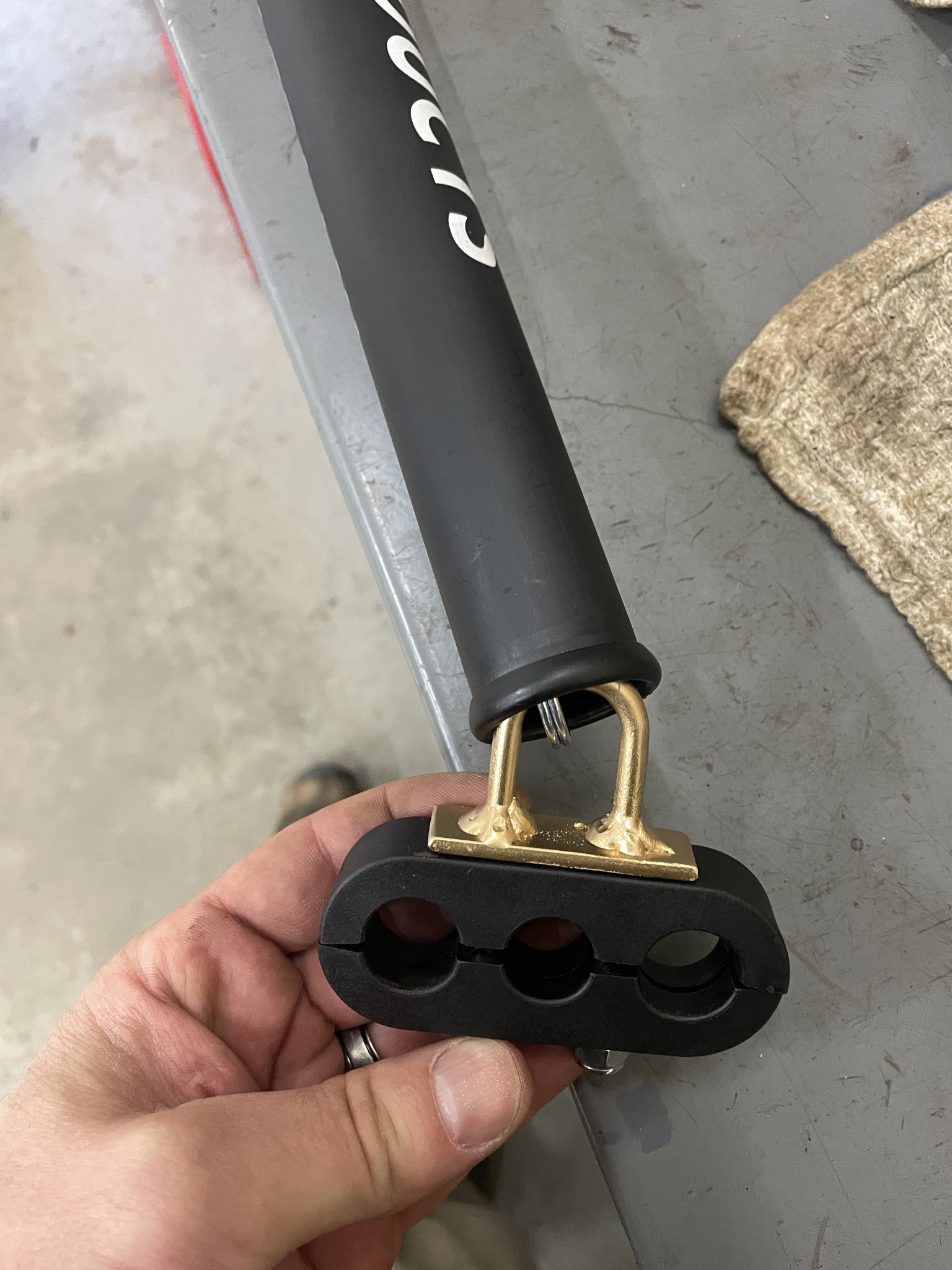

Finally broke down and bought one of those semi truck air line spring for my grapple lines. Went to install yesterday and promptly pulled the little stops through the washers…. Hmmm, I’ll fix that. Scrap piece of plate and some metal glue. Much betterer.
The gold paint was within reach.
No. Not common at all...fortunately. We do see some that are actually in a well pit (older farm houses) but at least you can easily find the well.

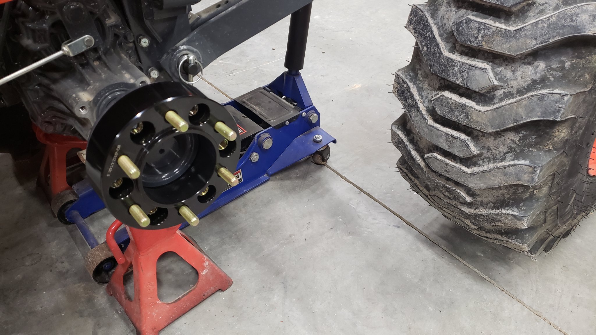

Installed a set of 2" spacers. Learned that the dealer had fluid filled the tires as a courtesy!
Did the same thing,, while I lke this LITTLE tractor if the assend was 6 inches wider it sure would be a lot more stable onthe hills here in the coal country!

The hose saver was a welcome addition here. Between that, and relocating the 3rd function couplings, I don't have to think about them getting kinked.

I was sorta surprised I’ve made it this far without a busted/pinched line. Though, I was well aware while doing any work with it.

We had a well at our last house that was totally under ground. Had an idea where it was, but didn't know for sure. All new wells around here have to have casings that are at least at foot above ground.
