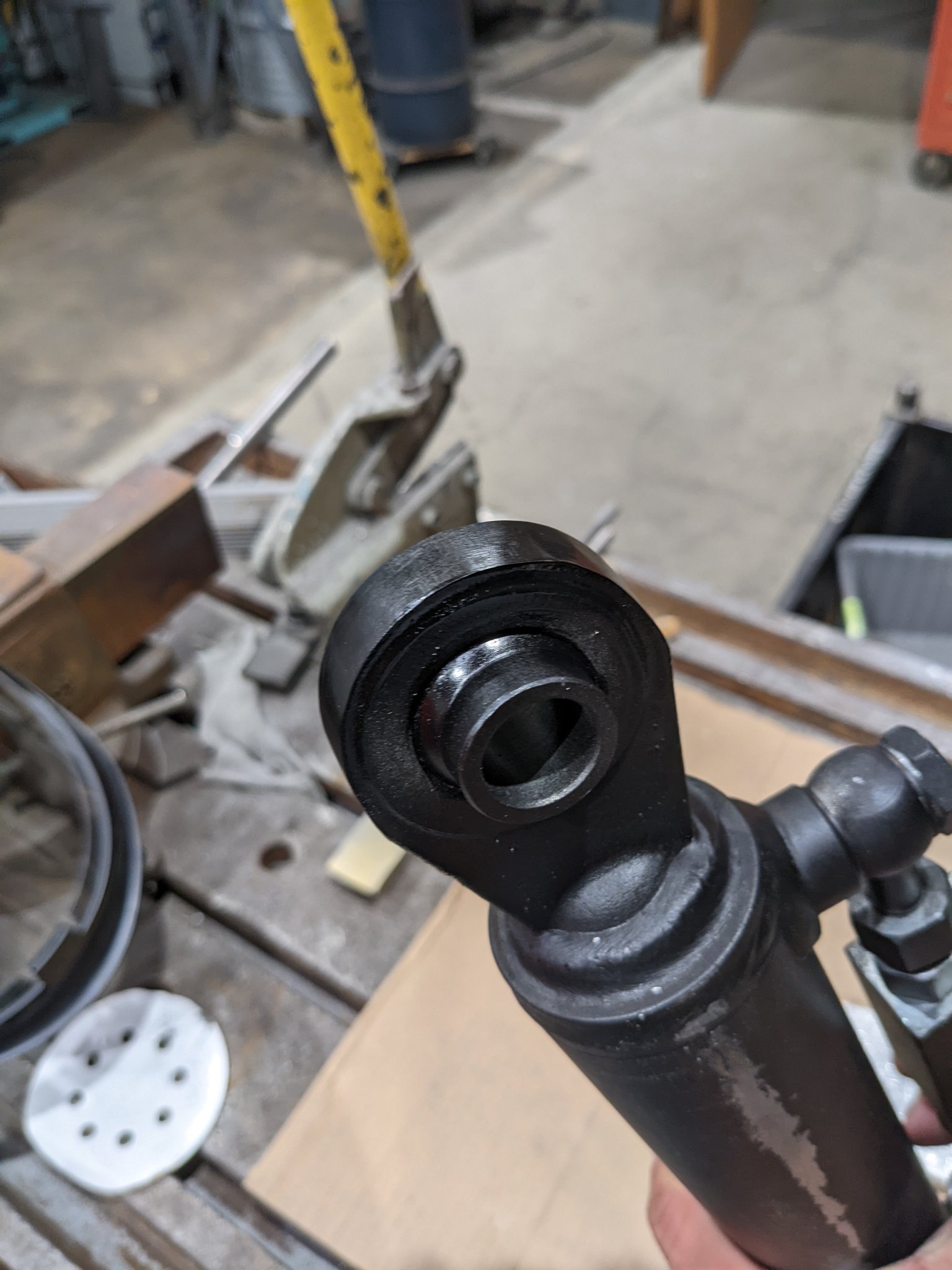

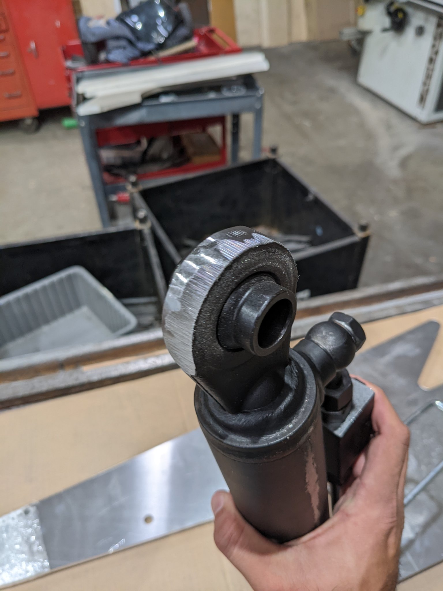

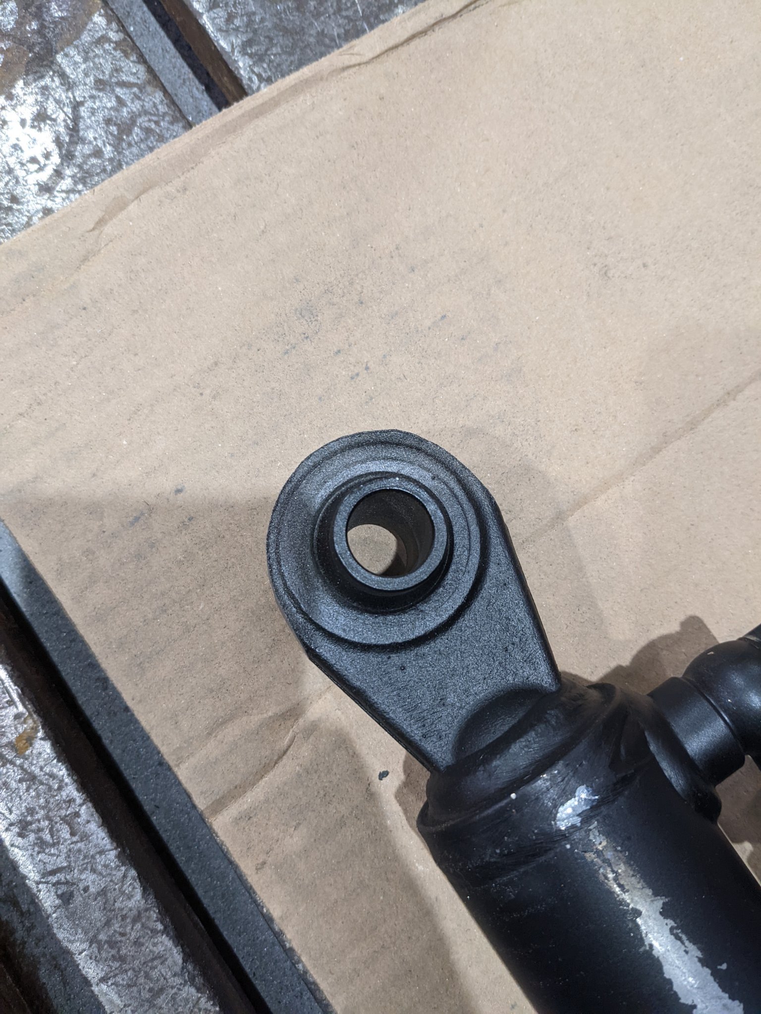

Used the Kalamazoo belt sander to quickly take material off. Took about 3/16" of material off to get the link to fit.
Before:
After:
View attachment 84731 View attachment 84732 View attachment 84733
Well damn... I have to grind the sleeve down too I guess, the sleeve is also too wide for the LX2610 top link bracket... Kubota really dropped the ball on this one. I should have checked the bracket width so I could have taken material off of both sides uniformly with the belt sander. I guess I'll have to use an angle grinder and a file at home tomorrow.

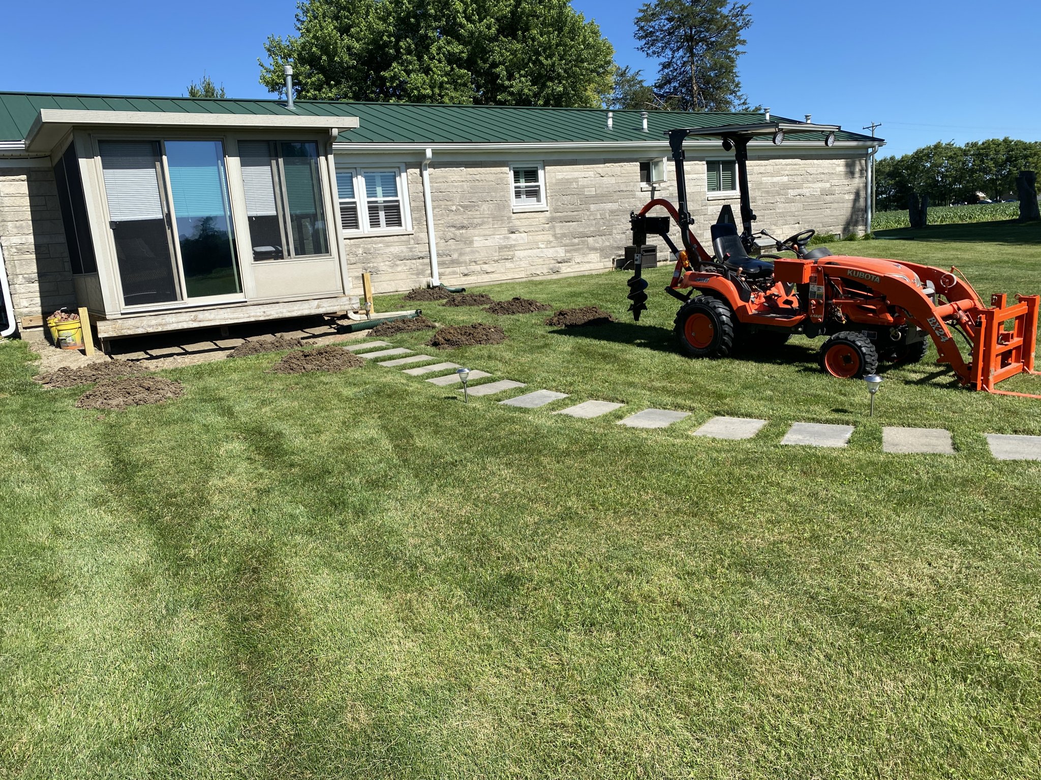

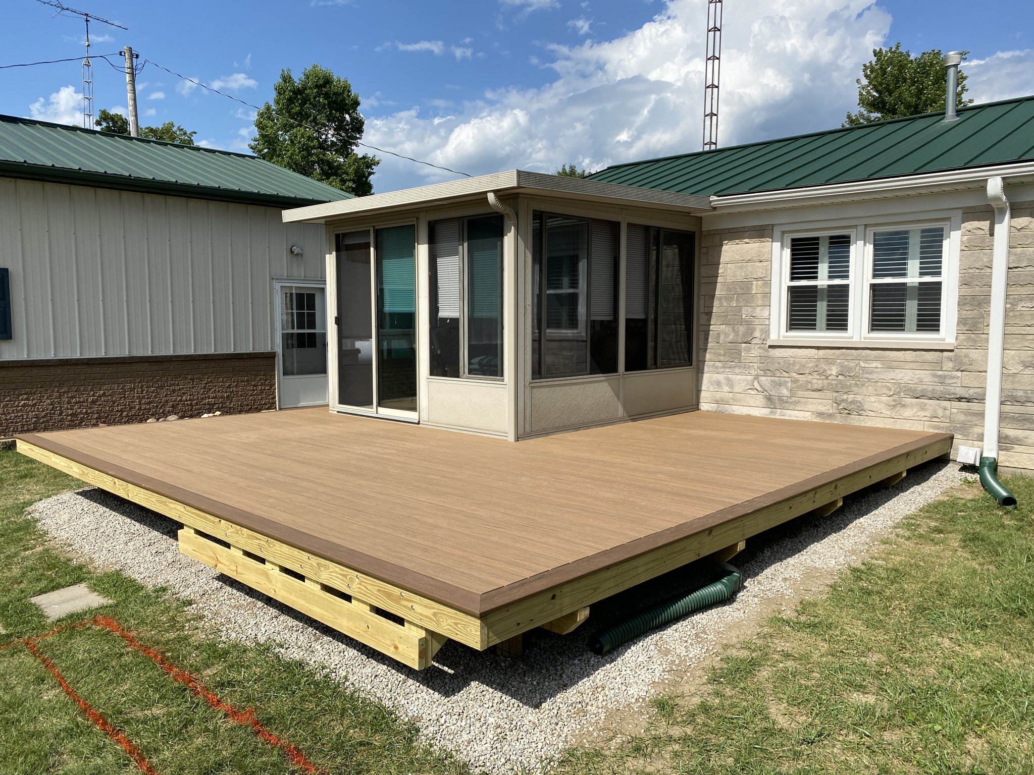

I will add more stakes then to be safe. I actually used leftover scraps of composite deck boards to make my stakes. Wasn’t sure how they would hold up to being beaten with a BFH but they held up great.
Here’s the latest progress on the deck and the Kubota digging the post holes with the Land Pride PD10. View attachment 84679 View attachment 84680
Just noticed you're in Indiana. Better put some traction pads on that stuff anywhere you're stepping close to the edge. Composite decking is slicker than greased monkey snot with frost on it. I used it on my front stoop and wound up going down 9 steps on my keester right after I tore my right rotator cuff. It looks great, and will last a long time, but take a few extra measures to insure traction on it. You'll thank me the first time you step out on it with frost on it.
Hi - I had to have about 7 stairs replaced - they were curved-front. Original guy I hired had some steel forms for them, but after looking at his layout, even to my untrained eyes there was no way they'd take the pressure, weight and keep the proper shape, so paid him for his time and hired another contractor. For each step, he built a square frame (I think 2 x 6's) and staked the heck out of it. Then, inside the frame, he placed the curve, supported with a generous number of 2 x 6 struts connecting the curve piece to the frame. That may be overkill for a one-step landing, but it looks like a good-sized pour.
