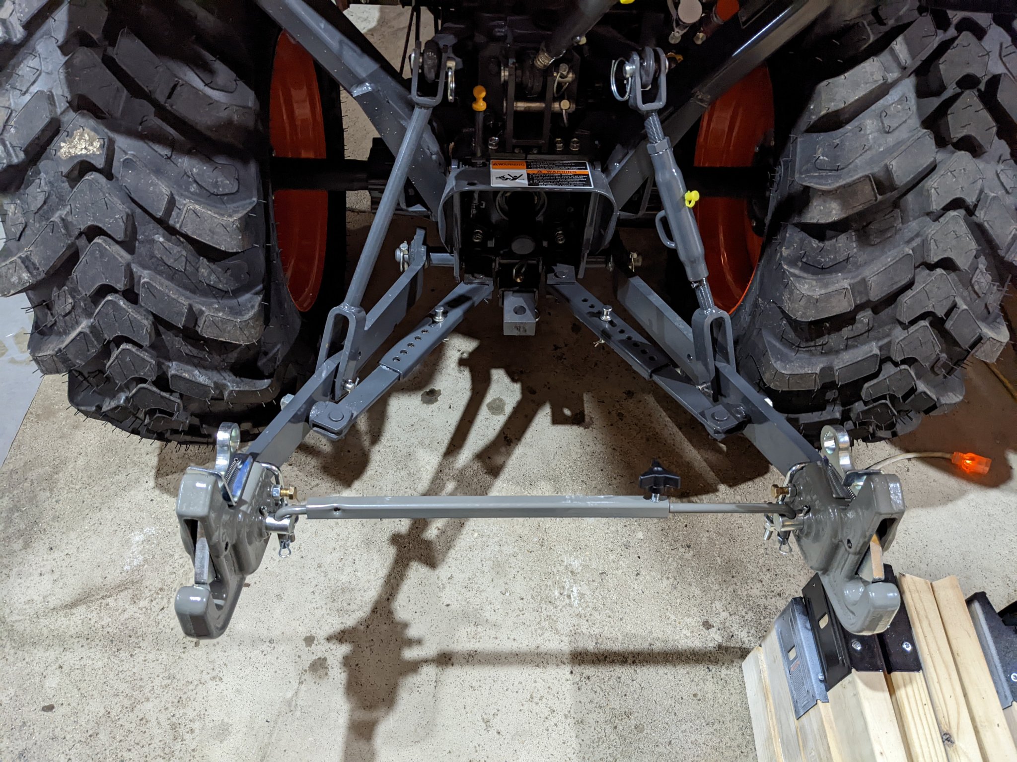

Installed my Pats QH. Those damn pins are so tight and my 3pt has not been used much. Ended up shaving off a tiny bit of the inside of my 3pt link bushings with the Dremel (mainly taking factory paint off) and tapering the end of the pins. Then I used some oil to lubricate the bushings and the pins. I spent another 35 mins or so making sure the QH was plumb and level. What a nightmare to install.... Here's the finished product:

Did mine yesterday. Lots of fiddling with the set screws until I determined it to be "plumb enough".

Agree, the only thing I see now is that they are still "angled" when compared to the ends of the 3pt arms even though they are vertically and horizontally plumb. Not sure how to remedy that. It didn't result in any issues hooking up my BB although my top link is almost fully extended (need to get a longer hydro link).

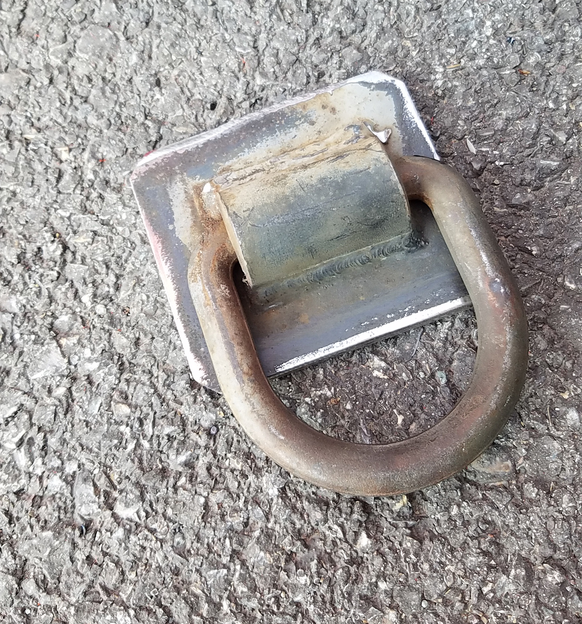

Later today I'm heading over to a friend's place today to cut about 12 acres of his fields. I'll need to be back over there tomorrow morning too. Since I'll be putting the MX on the trailer I got up early and made up some D-rings which I welded in place, one on each side. I wanted the ring to be lower than the guard so that I can run a single chain through both rings if necessary. However, I intend to use a chain and binder for each D-ring with two more chains connected to a shackle on the draw bar at the rear for four points of connection.
I don't have 220V in the garage at the moment (don't ask) and so ran the Millermatic 185 off the Kubota GL7000 generator. Due to the thickness of the plate and required amperage It didn't go as well as I'd hoped. I've read that welding machines don't always work well when running off generators and that seemed to be the case this morning. Anyway, I got it done and it'll do for now, but I plan on eventually upgrading the spare MX grill guard that I bought from the Messick's auction a few months ago and will do a better job. I should have 220V back in the garage by then.

The new D-rings worked great yesterday. I only need a couple of feet of chain per side with these rings and certainly not the 20ft that I currently have at each corner.
