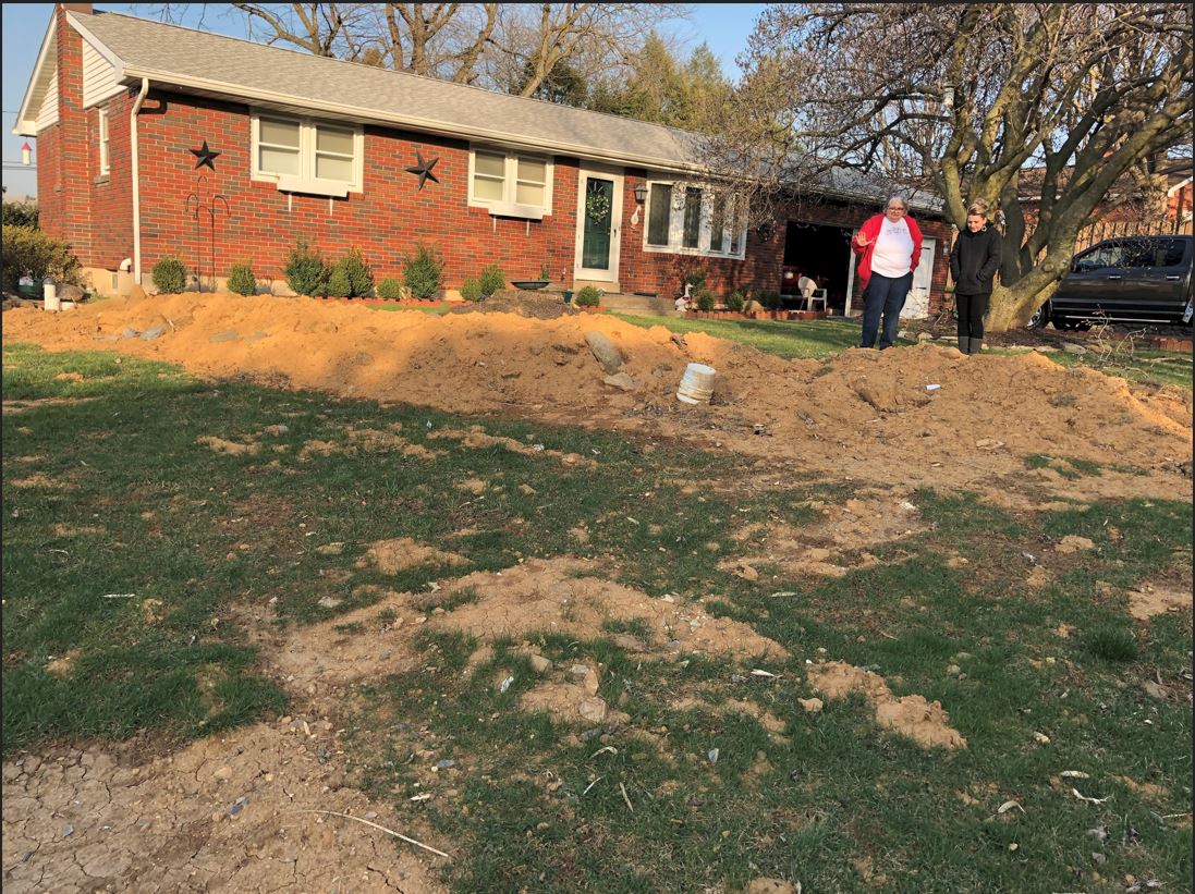

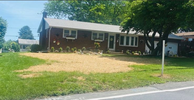

Sunday's fix 'er up job after sewer line installation in January. No, I did not do the initial dig as I wouldn't have left it looking like it does in the first pic.
What a mess:
Box blade and landscape rake to the rescue (along with much tree trimming).
another happy customer. Thanks Kubota.

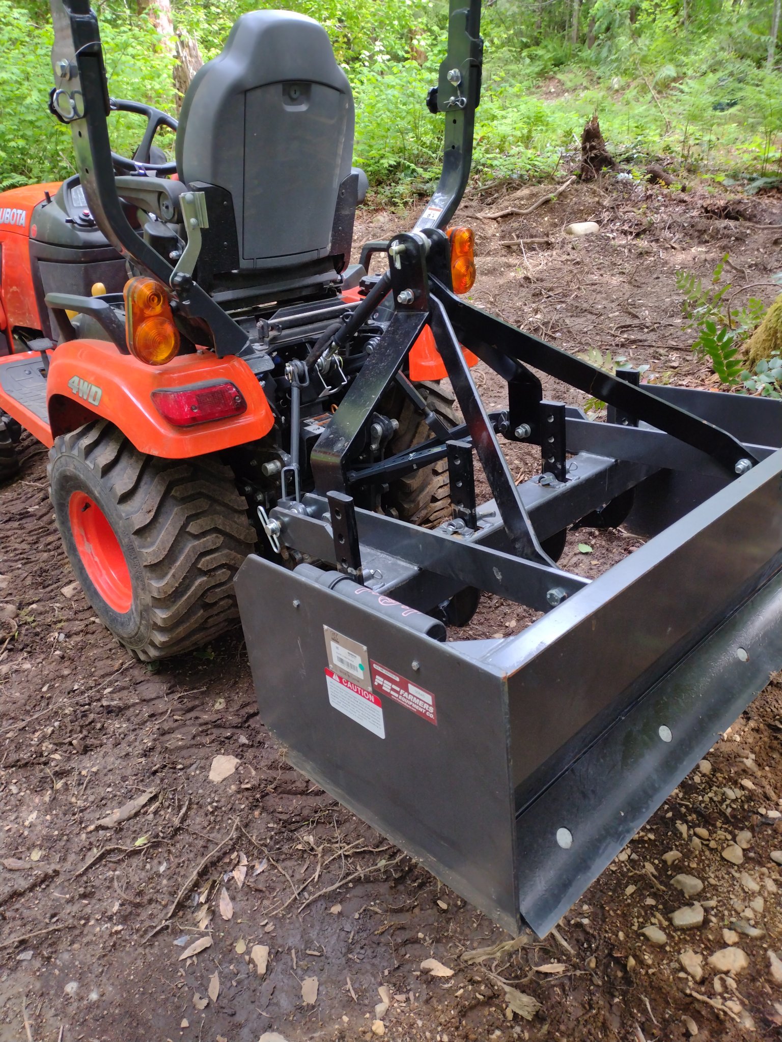

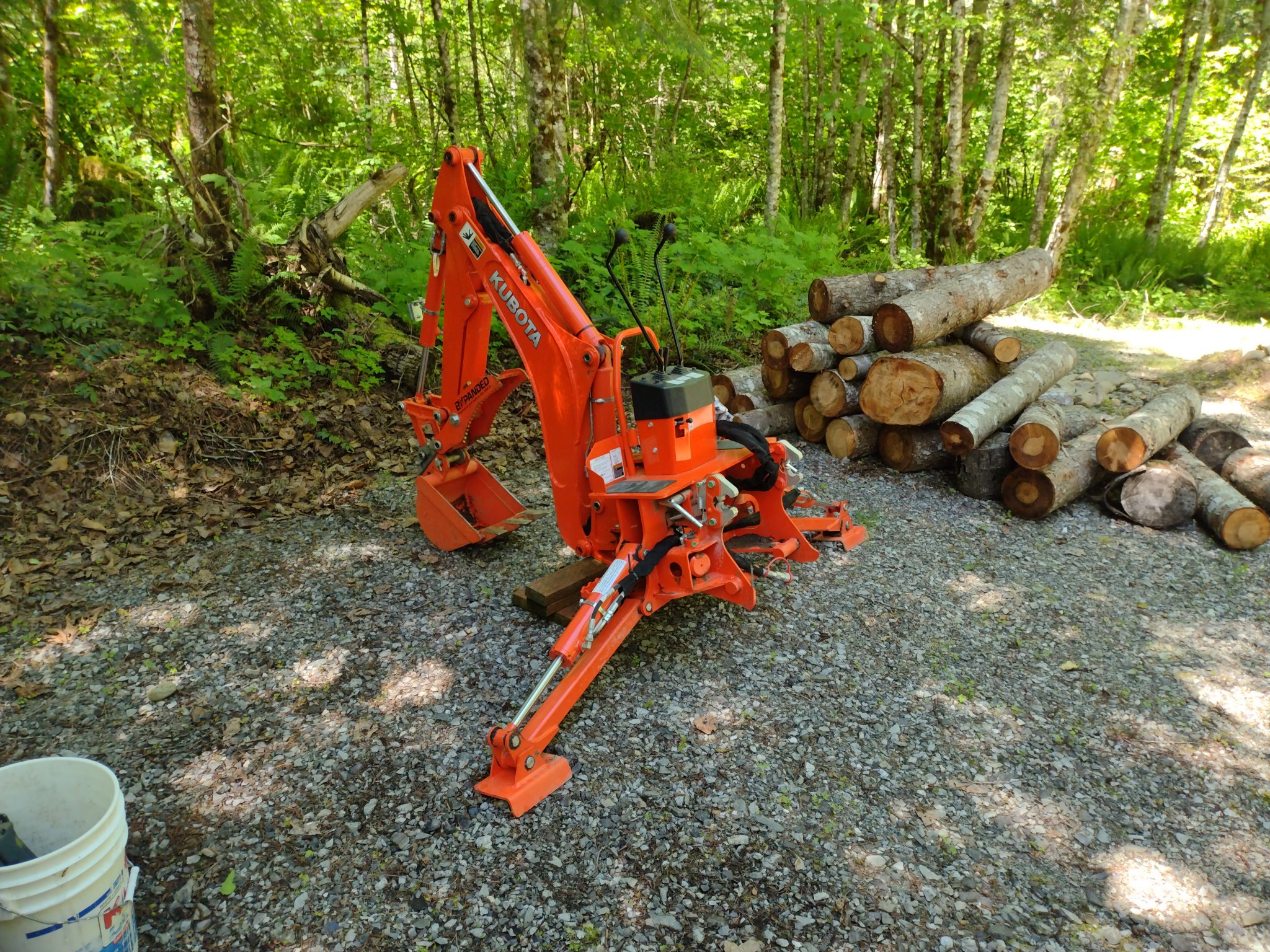

Today I removed the backhoe from my BX23S for the first time. Mounted the three point hitch and the new box blade. Eventually put the backhoe back on. All that went relatively smoothly. The telescoping stabilizer bars makes it a lot easier to attach an implement ... I realized I could pull the pins, get everything attached, raise the implement, and with it in the air I can center it and then put the pins in the stabilizer bars. I am glad that I bought the telescoping bars right out of the gate and never once had to deal with turnbuckles.
EDIT: I suppose you can accomplish the same thing by disconnecting the pins or shackles on implement end, so the telescoping bars don't really provide as much of an advantage, provided you don't use cotter pins. Still, I thought it was a good example of "out of the box (blade)" thinking.

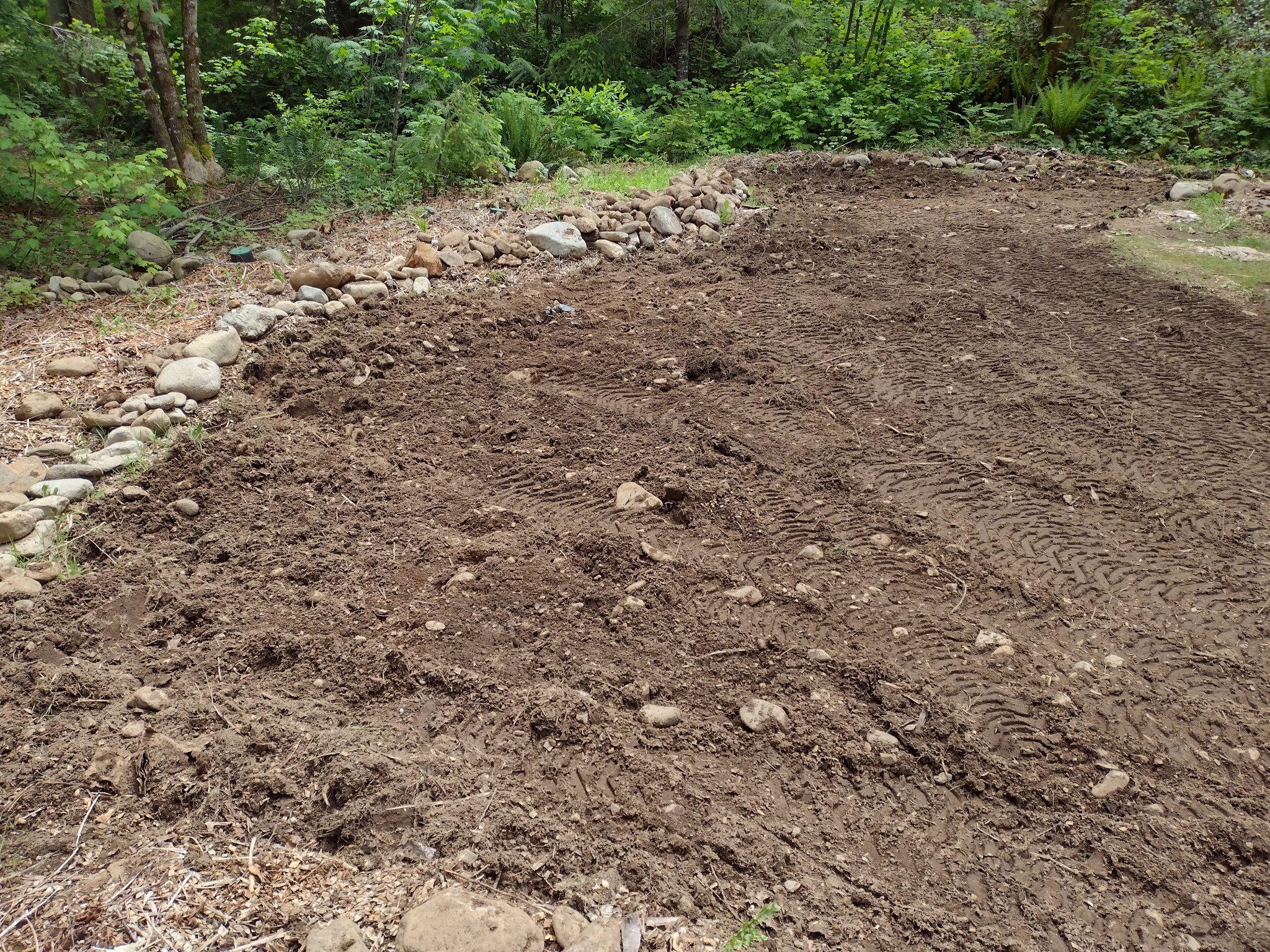

I played around with the box blade both on rough ground and on my driveway, then headed over to my future flower garden. I removed a fair number of larger rocks (>1 foot) and a bunch of small ones. I'd run the box with the scarifiers all the way down and then go back and carry the rocks to the side by hand. I don't know how well a landscape rake would handle the larger rocks, but I sure could use one now. Tractor is now parked though because I'm over-due on the 50 hour service and the engine oil filter isn't coming off easily.
