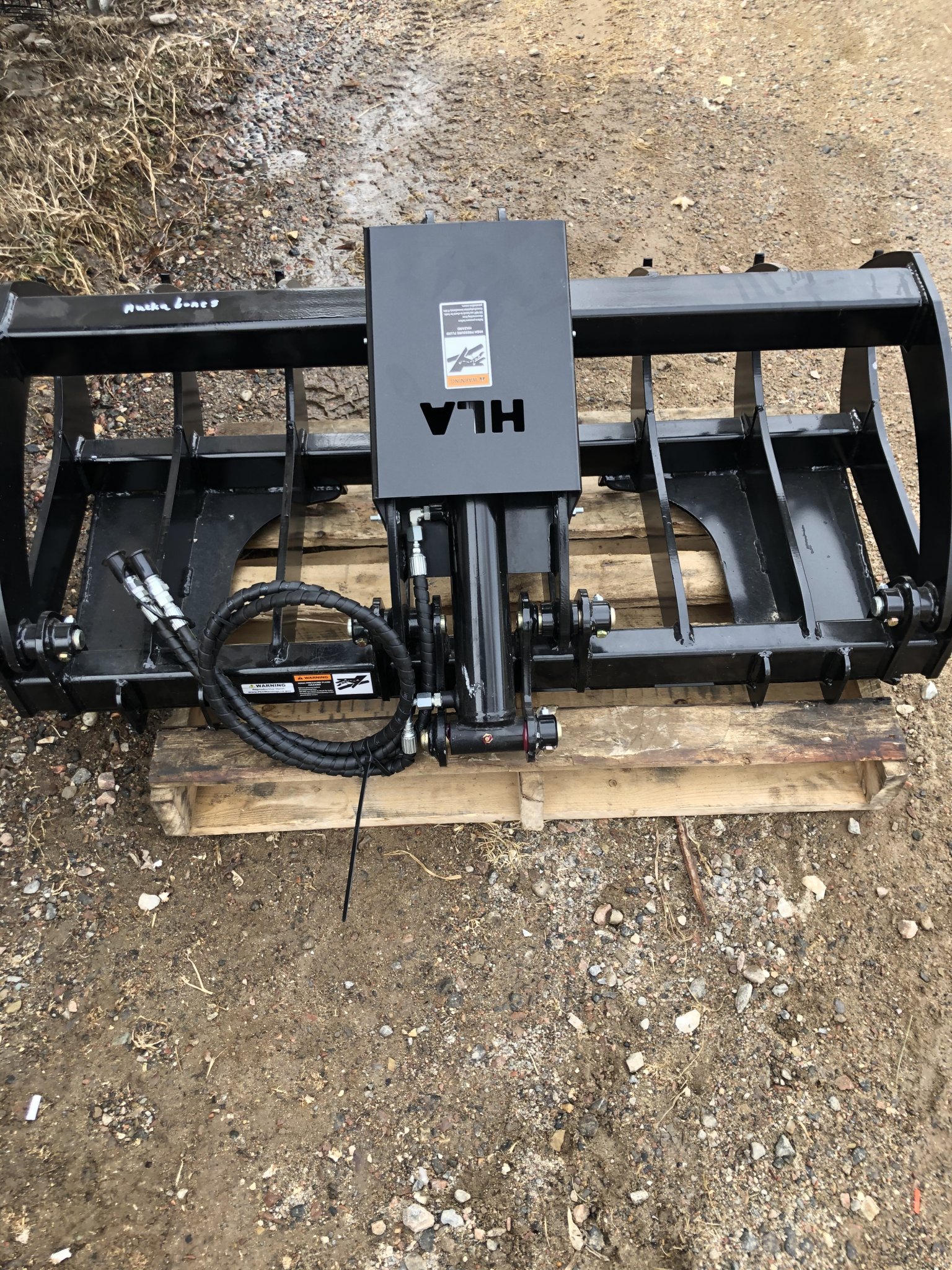

I finished the install of third function last week for the new grapple. I decided to not use the flexible hydraulic hoses on the tractor section. I made hardlines instead. Lots more work but looks great. Used it allday today.
Where did you get the material for the hard lines, and were they difficult to bend the 90 degrees ? I am not that far from NH, and the name of the shop where you got them would be helpful... thanks
I ordered it from my local hydraulic hose and fittings shop. The hardline that gets discarded is .035 wall 3/8” OD tube. I bought seamless steel tubing i think the name of my local shop is Kaman? Making the bends is a bit tricky, ive had lots of practice. Special benders with long handles. 37* flares. I did double flare like the tube I removed. I started with 3) 5foot straight tubes because of screw ups. Fun project, also the instructions show the wiring for buttons all wadded up and zip tied. I cant live with that mess. I found a better neater way
Excellent work, sir. Is that the WRLong kit, or OE Kubota kit? The one for the LX is completely different mounting because the FEL spool is under the seat. Like you, I'm not keen on a ball of wire tied up and waiting to grab a tiny twig, unravel, and then rip something off the machine. I want wiring secured and well guarded.
Thanks to everyone for the compliments, this is the LandPride kit. Im going to make up a channel or some shield to cover and protect the new tubes under the platform next. I had to incorporate the mount and the bracket for the snowblower handle, they both occupy the same mounting location.
