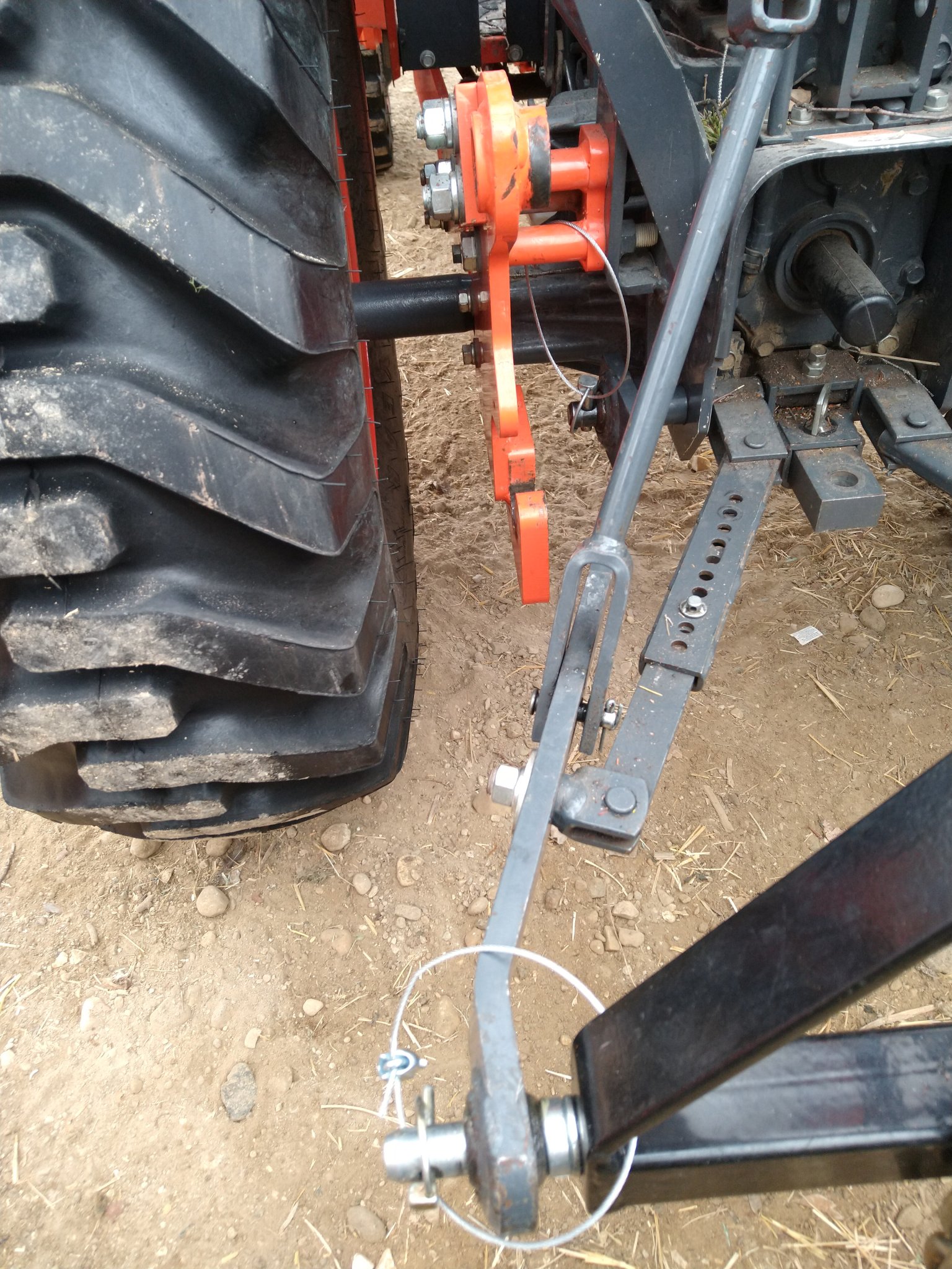

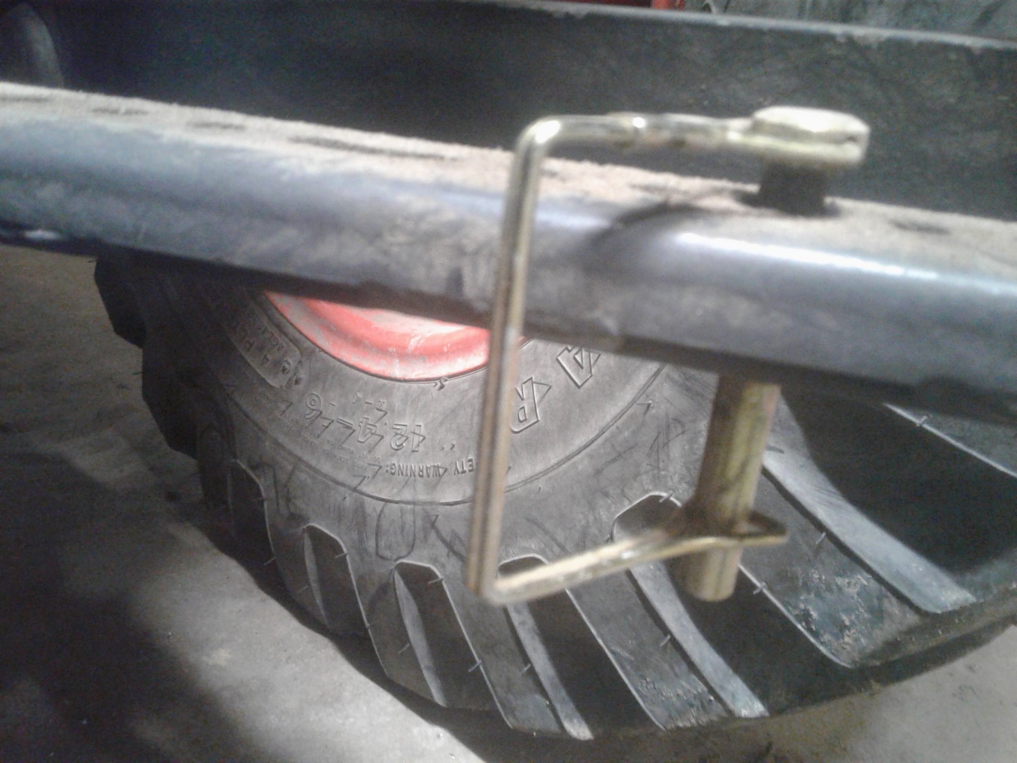

I think these are pto pins, can be found in farm type stores
That pin wouldn't last half a day when I'm out pushing bush. Brush and bush branches would pick the clip open in about 10 minutes, then it's just a matter of time before the whole pin gets popped out to join all the linch pins I've donated to the bush. I prefer the original pins with a wind-on spring clip hole in their ends. A pain to change, but they stay put! And I've gotten pretty quick at adjusting them by now. If I was to end up using one of these it would have to have a cable on it tied to the tractor so it wouldn't get lost when it gets pushed out, like these:
Lost one of the retaining wires once, pin stayed in the stabilizer. I run a QH w/telescopic stabilizers and lost both lift arm lynch pins from the tractor. The QH/stabilizers kept the lift arms from falling off. Don't know how many days I ran it like that, only discovered it when under tractor looking for grease zerks.

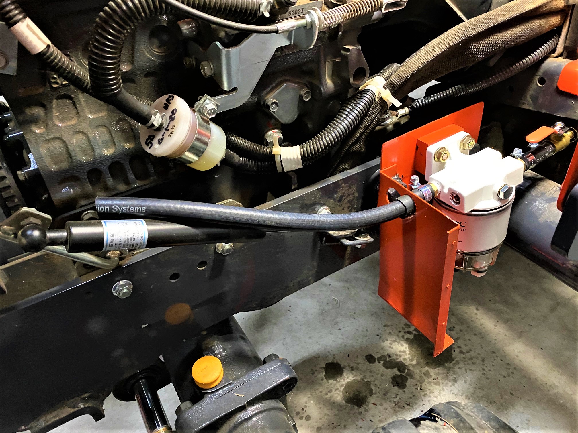

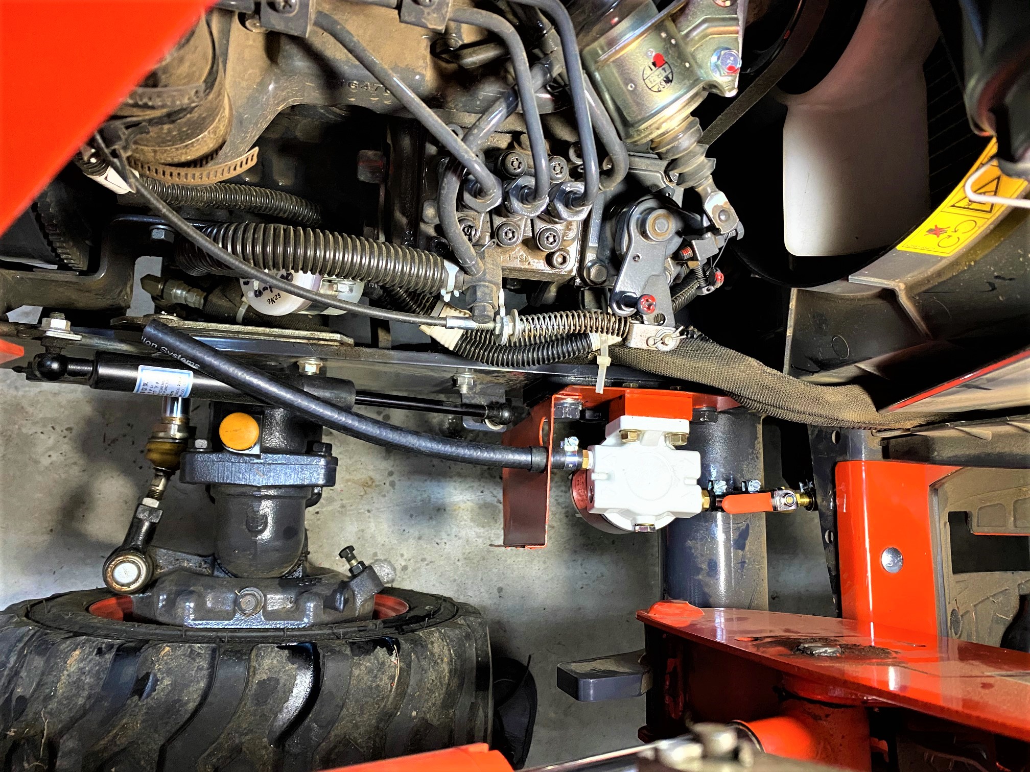

I fabricated and installed a fuel filter bracket and protective shield for my BX.
Your comments are appreciated and welcomed.
Here are several pics;

Excuse my ignorance, but what is the filters purpose?
To separate trash from the fuel. Injectors are picky and will stop working/wear if they are fed a steady diet of dirt and debris.
Its *cheap* insurance to a healthy tractor.
Here is a wide area mowers fuel filter from work. They get dirty. If the filter wasn’t there, all of the black crap would have went through the injectors.

Understood, but in one photo the fuel line isn't connected to anything, so I'm assuming the last photo doesn't show it connected.
Maybe he isn't done with the install? The hose on the left(not connected) should tie back into the inline fuel filter I'd bet.
