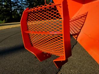

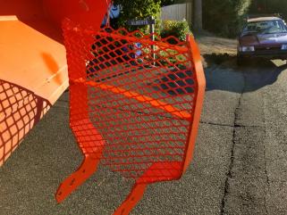

Found a tear in the plastic grill from a stick....so.....today I got out the electric glue gun and grinder and added some expanded metal to the grill guard.

I've seen this before and really like it. Hope to find some time this winter. Good work

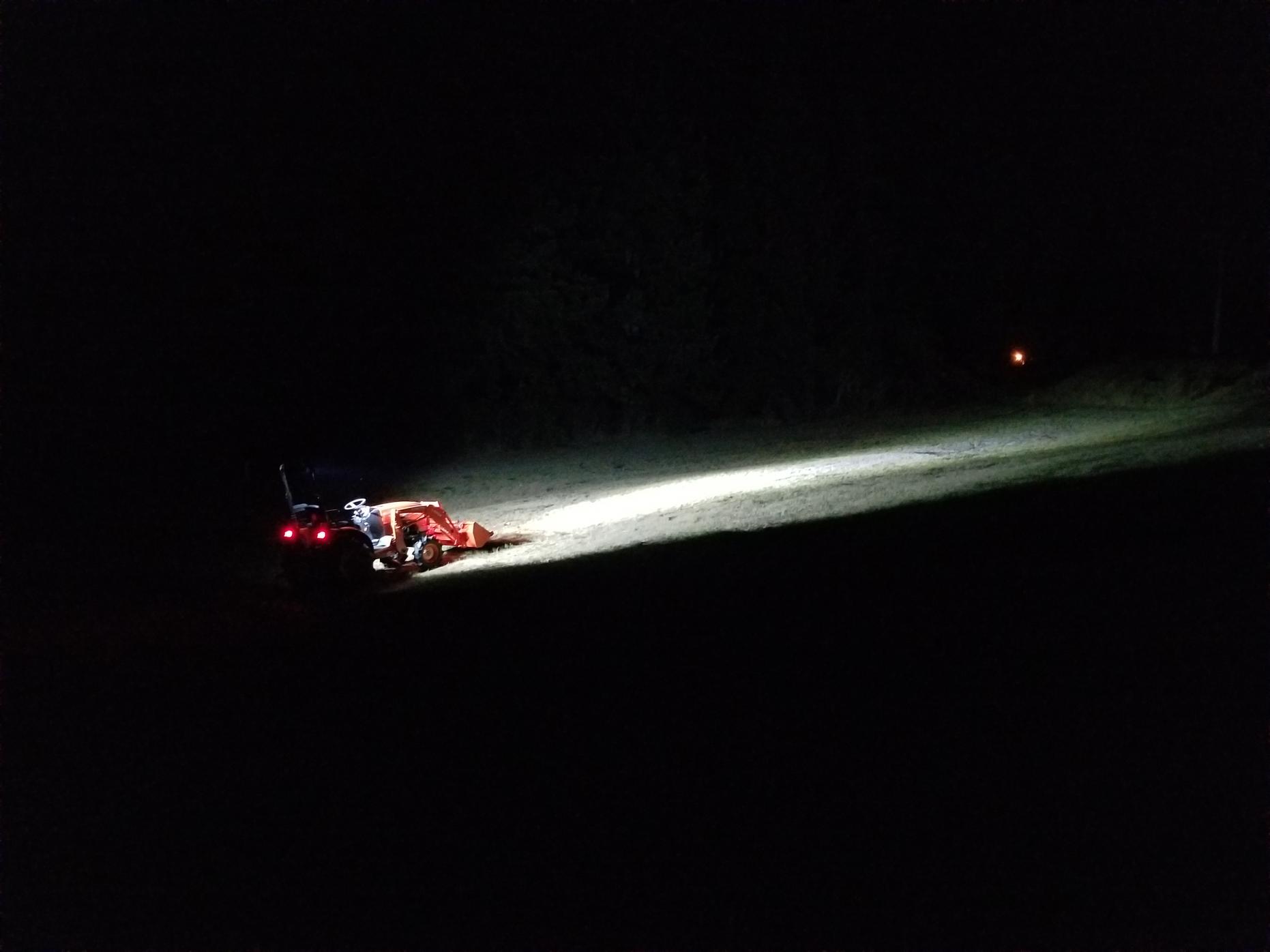

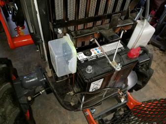

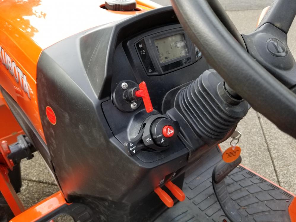

Kill Switch & Light Bar
Wired up a 6 place BUS with weather proof container enclosure under the hood for this lighting addition and future rear facing lighting(backhoe work).
Kill Switch is obvious for a reason: See it and give up, move along.
Both work great.

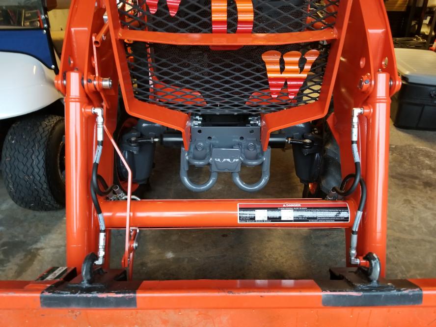

Attached these two tow/tie down hooks and welded a plate between them for increased strength. I think these will work great for strapping the tractor on the trailer.
I picked the hooks up at a garage sale this Summer for $5.....they are from a Nissan...Titan I think.
