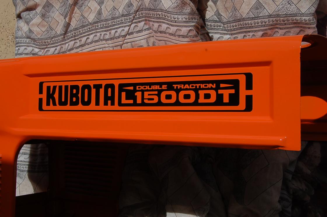

Put the new hood decals on,

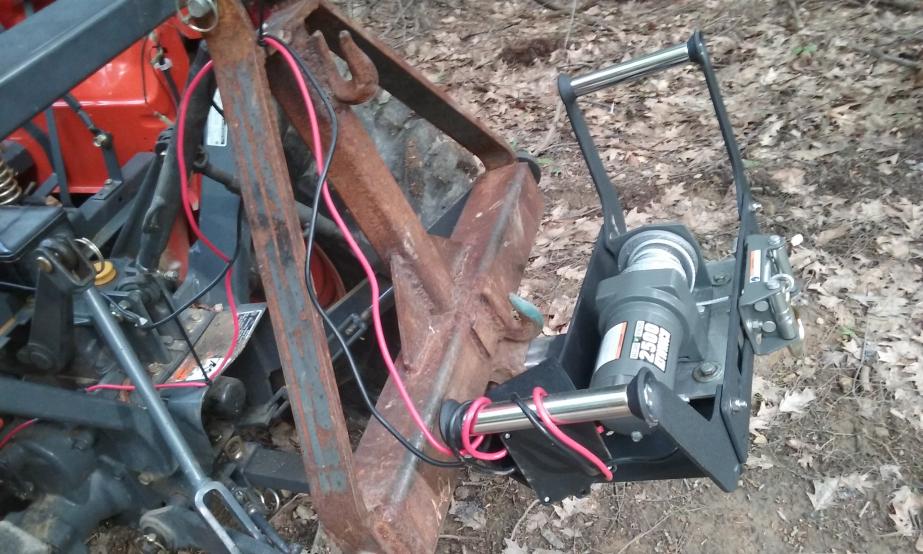

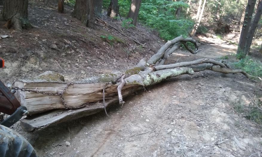

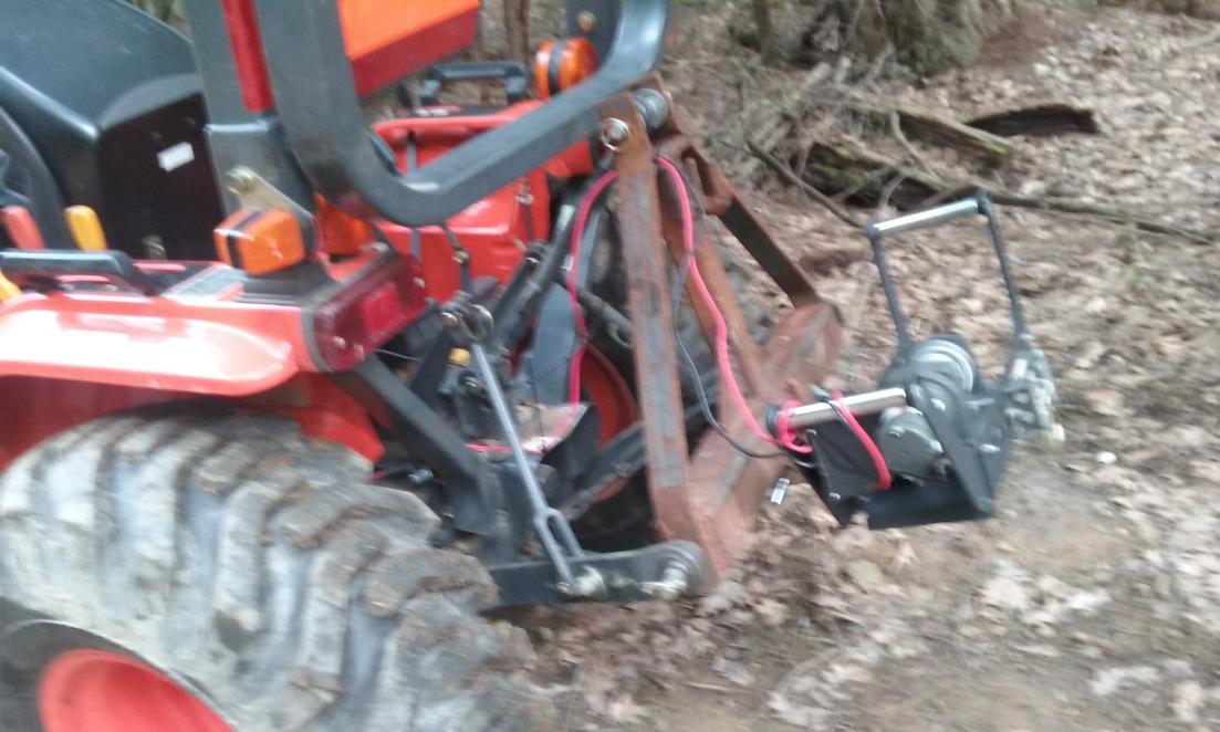

What did I do with my orange beast to day, skidded tops with a winch I installed on my skidded attachment I built last year, uploadfromtaptalk1465087107361.jpg boy what a tractor s uploadfromtaptalk1465087183594.jpg uploadfromtaptalk1465087210979.jpg aver that is and cut 3 loads of wood

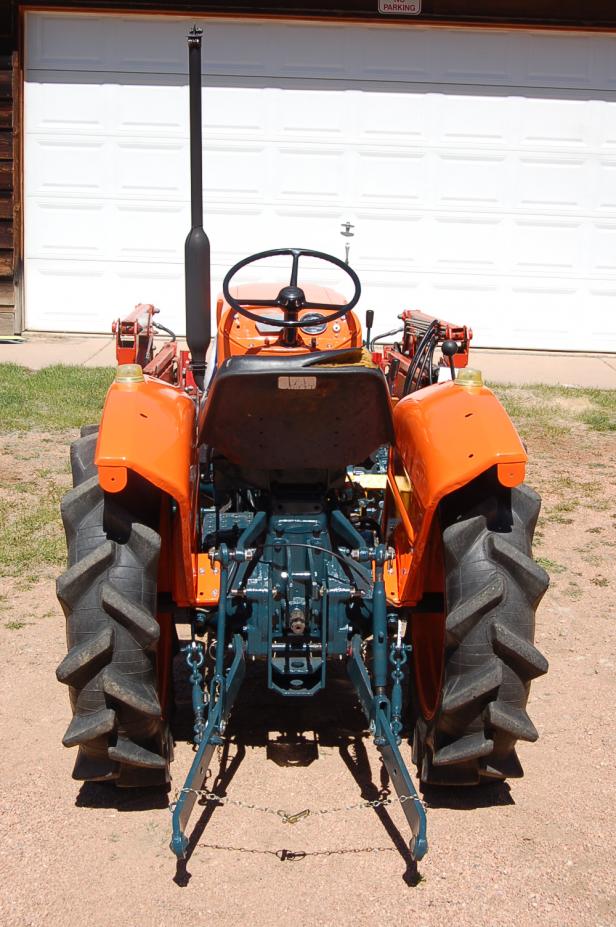

Yesterday I got the last coat of orange on the rear fenders, and today I've got them both installed along with the turn signal lights.

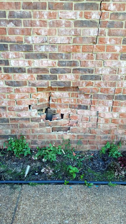

I think I'm in the opposite situation. The wife said it was her turn to use the Bx and I had to use the push mower.
I knew I shoulda kept a better eye on her and her speed.:(
Don't know the full extent of the damage, got a call to insurance to see if it will be covered. The important thing is that she was not hurt.
I love my wife, but she is beating herself up over this. If insurance wont cover it, it looks like i'm gonna learn brick work

Ouch!!!! My wife mowed in a nice sedate 4 low :rolleyes: She tried it in 5th but it was jarring her too much and bugging her back.
I spent two hour with the push mower going around trees and the ditch. Then jumped on the bota and finished the acre and a half she was mowing. Then went and mowed the front yard :D

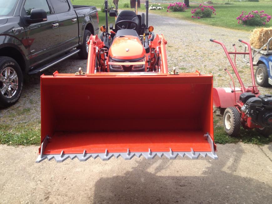

Finally got my new bucket put together. I bought the tractor with a 60" bucket which works good for snow and manure, but struggles digging. So I figured I would set up a digging bucket. Got a 54" bucket from my dealer and added a Pirahna tooth bar and a couple bolt on hooks. The combination of the smaller bucket and the toothbar made it pretty slick digging into my dirt pile!

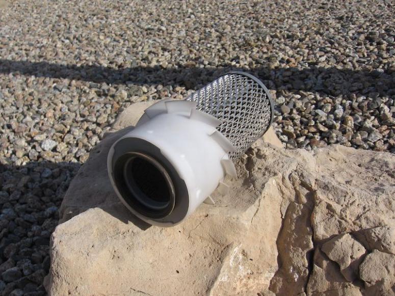

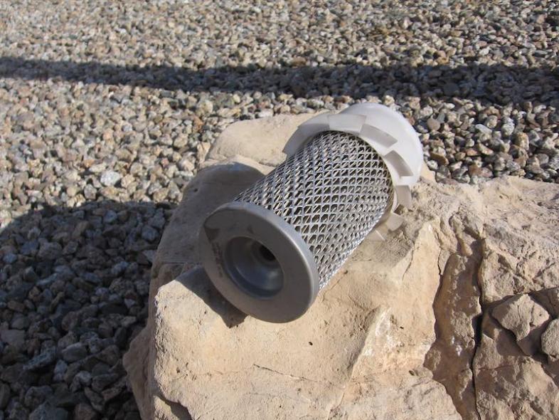

Changed oil & filter (rotella T6), greased, changed from 14" backhoe bucket to 10" bucket, and put in a new air filter. For those who have never seen one, here is the somewhat odd, but very effective B7100 air filter element.
Odd? You referring to the fins?
If so there is method to the madness. If that is in the path of incoming dirty air..... Maybe idea behind them is they cause air to spin as it enters the housing. Spin helps for large particles in the air to fall out and not end up coating/clogging the air filter. makes the Filter last longer. There is various air filter systems that use this concept. Some even are attached to the exhaust so that a venturi effect can suck those larger particles out of filter canister and send them out the tail pipe.
If that is outgoing filtered air that hits the fins guess it's to cause turbulence to help with automation of the fuel at injection so combustion has a chance to be more complete?
7,935
3,216
Must be effective, there is always a pile of loose dirt/dust in that housing.

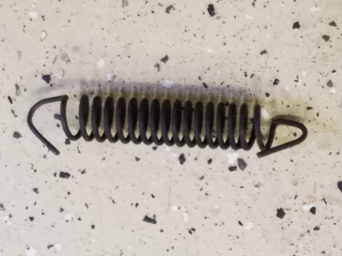

Had to make a second hood hold down, that part is not available, installed them and the hood cushion $$$ :rolleyes:
I know the springs are not correct, spring.jpg but at $26.82 each they can keep them :eek:
YES, that is the correct price (34150-18164) :eek:
