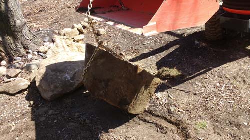

Extending an level area from the house. Then using that dirt to fill in wash outs going up the hill.
Ran in to a couple rocks. They only stuck up 3-5" from finished grade.
Bucket hooks and chain are nice for pulling brush and dragging rocks

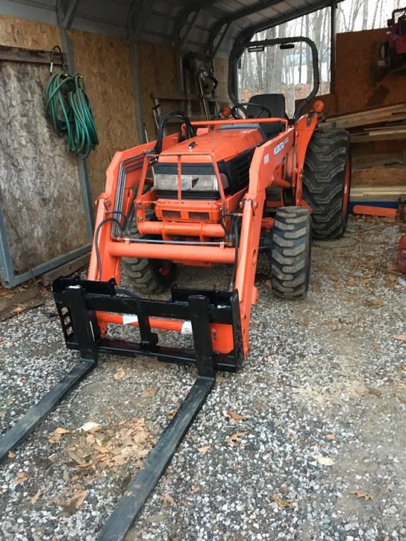

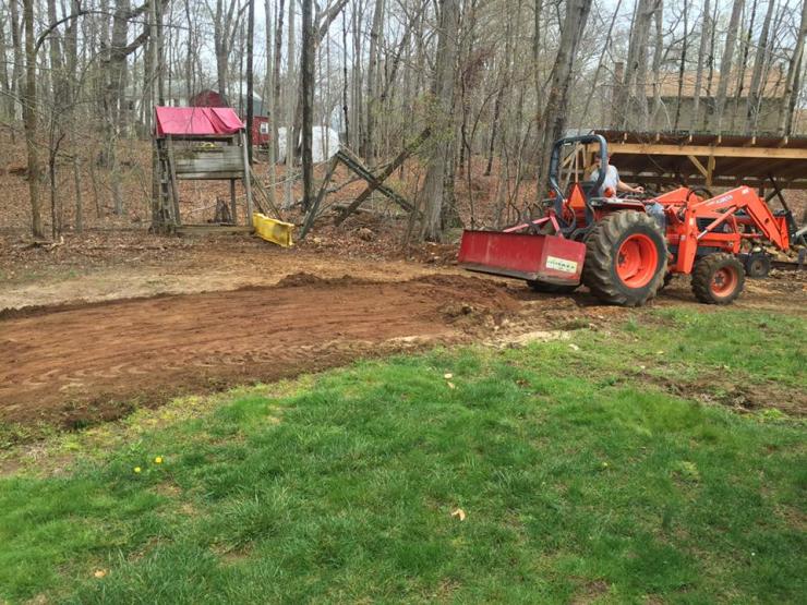

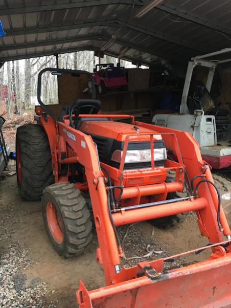

Replaced the front headlight assembly that was broken when I got the machine, and re-sprayed the entire nose assembly. Looks much better!

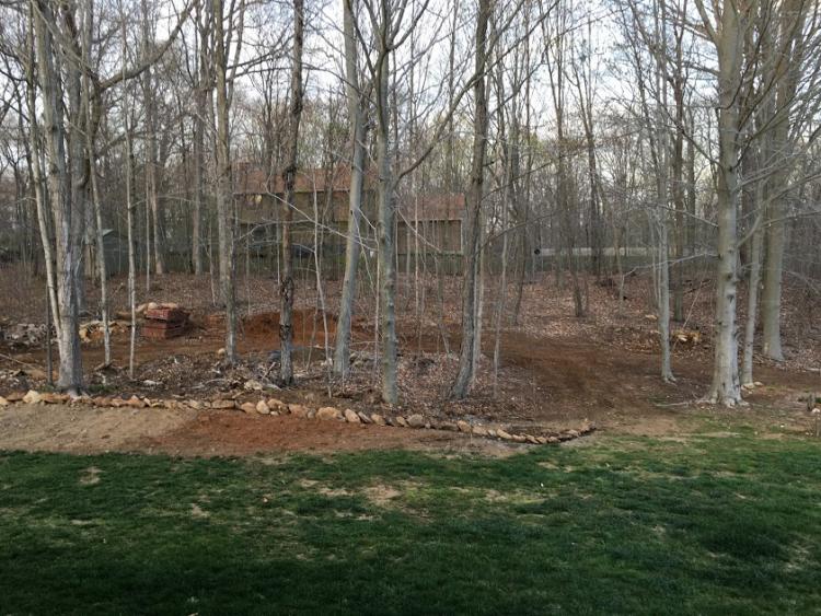

Also removed a stump with my Takeuchi TB125 and backfilled the area with material with my L3710.
Box bladed the driveway back to its ~30mph status.
In the background of that picture I also moved ~1800lbs of brick on a pallet.
Lastly, moved a swingset out of my back yard and replaced it with a different one....long story...

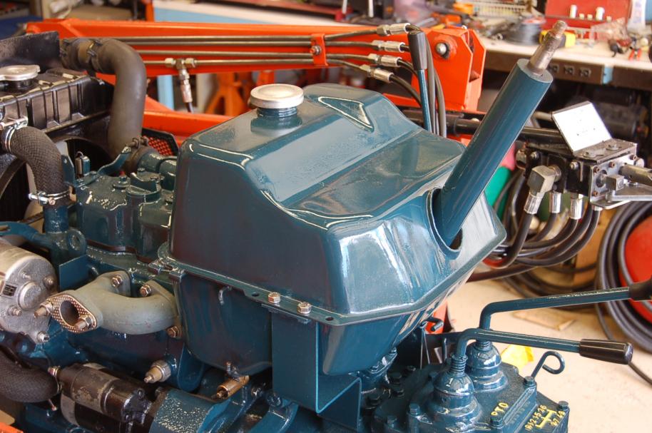

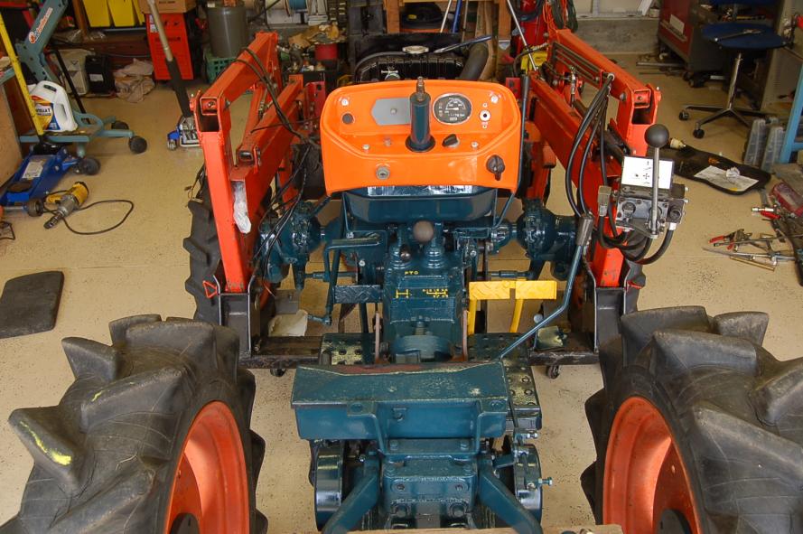

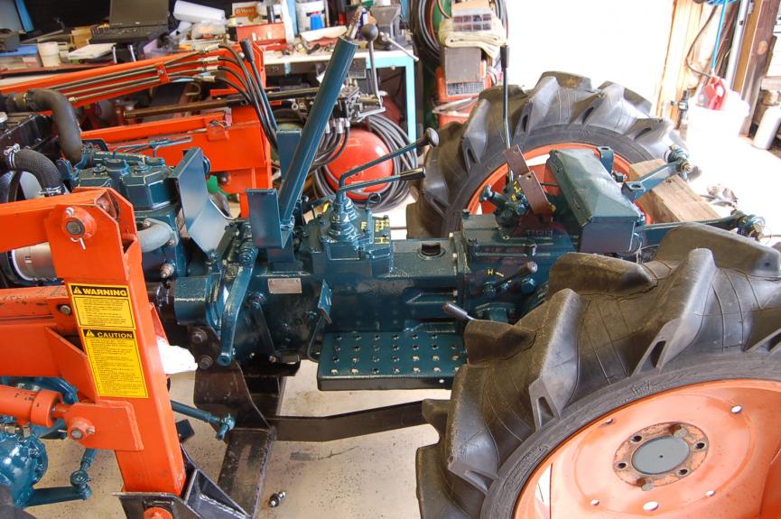

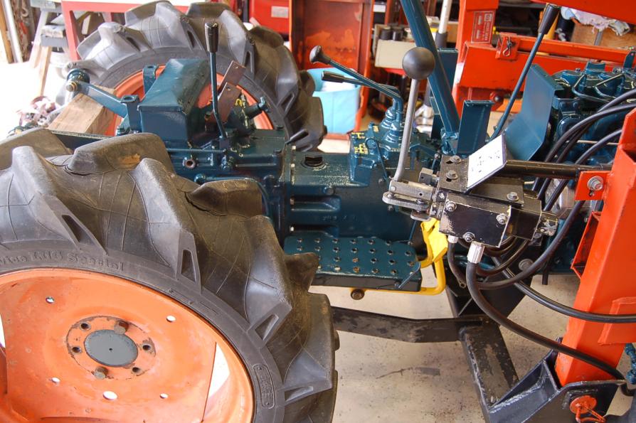

Got the L260 almost back together. The transmission and differential bearings are all replaced, the tractor halves are back together and the rear wheels are back on. A couple more hours and it should be running.
While I had the hood off, I replaced the hoses and fan belt. Also replaced the plastic fan. The last time I used the tractor before the bearings exploded, I was getting pelted in the face by little bits of plastic coming off the fan. Appears to be original to this 40+ Yr old tractor. Its coming along nicely.
My plan is to get it running, usable and mobile, and plow and disc my garden then bring it back into the shop to make it pretty. I am taking the hood and fenders to get sandblasted. I can't decide if I'm going with powdercoating or spraying Kubota enamel yet.

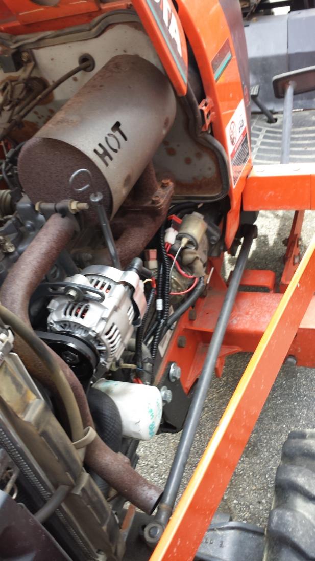

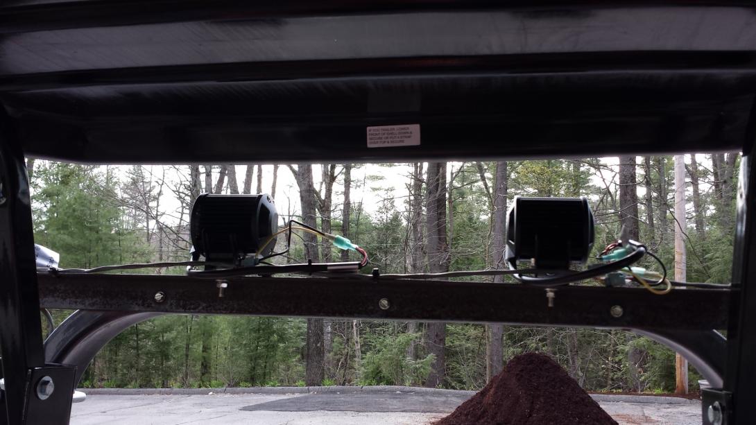

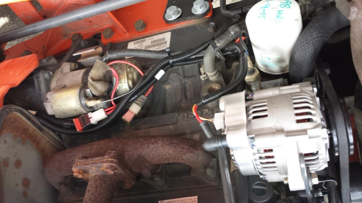

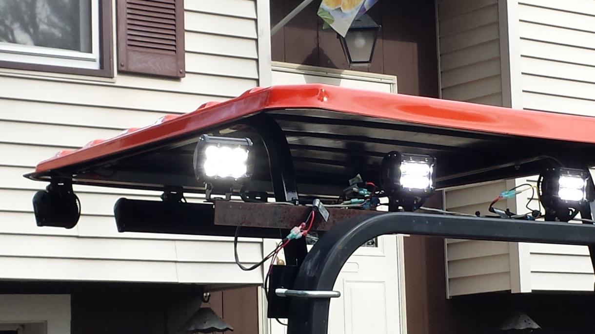

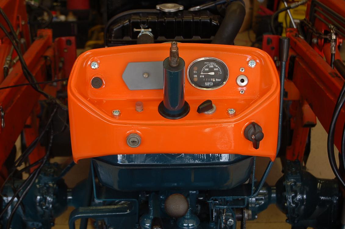

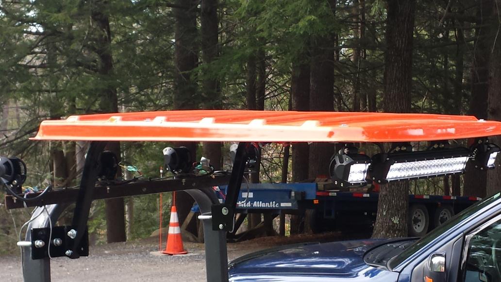

Recently my red battery light came on and stayed on. I figured it was either a bad dyno or regulator so I decided to buy the alternator upgrade. I also wanted to upgrade the spot lights and add a canopy and second light bar. Well I finally finished these upgrades, but it did not take a single day, this was done over a couple of weekends.
Interesting note, when I finally got under the instrument panel I found why the battery light was on, there was a mouse hotel in there that I got rid of by pulling out all the debris with long needle nose pliers, but when I lifted the instrument panel I found that the dang mouse had chewed off the coating on 3 wires and completely chewed through a forth! The last wire must have had a single strand of copper that finally failed causing the red battery light.
As luck would have it, the only two wires that were mostly unscathed were the two wires needed for the alternator upgrade. I verified that the other four wires were not needed via my Kubota dealer so I cleaned them, covered them with liquid tape and left in place so as not to mess with the harness.
Well I know talk is cheap so here are some pictures.... :)
