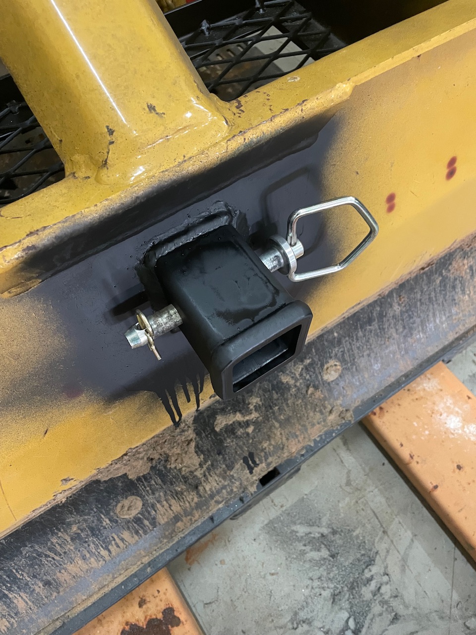

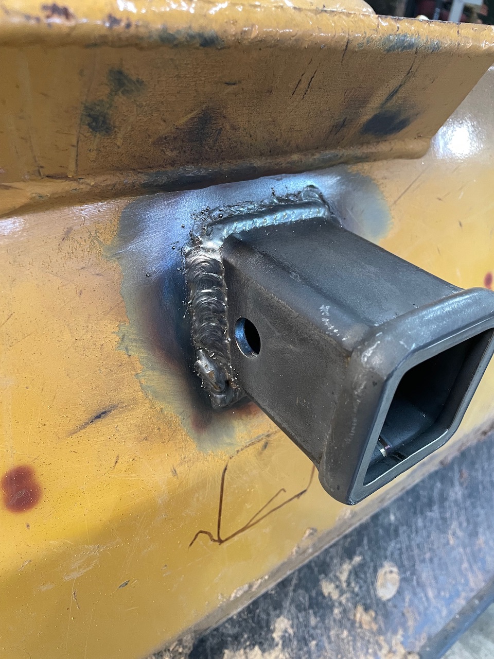

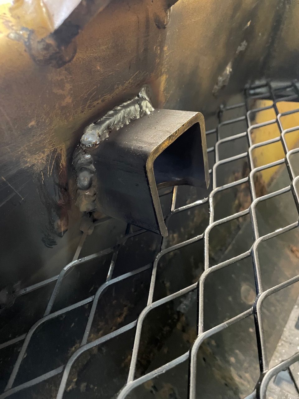

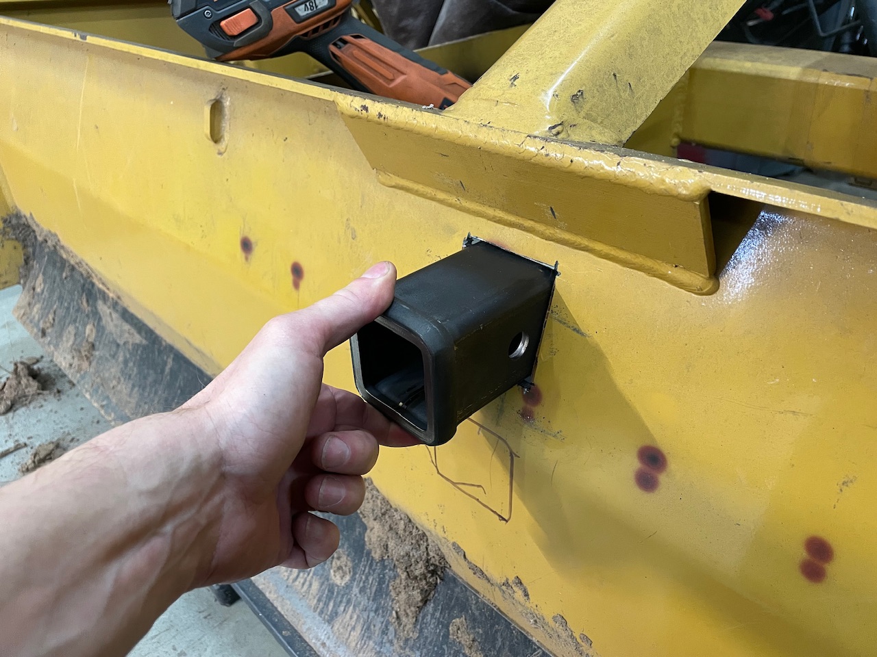

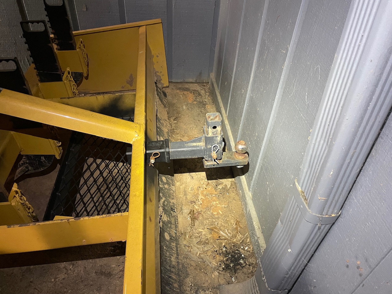

I’d like to see the trailer hitch on your box blade. I want to add one to mine so I don’t have to drop the box blade every time I need to move a trailer. I have a Land Pride BB1248 (but could really use the BB1260 or BB1272 behind the LX). I want to build something I can easily swap to a new blade if I decide to spend the money, maybe a clamp-on of some sort. I’m shamelessly asking to see yours so I can plagiarize it. I might shamelessly do exactly that. I don’t really want it for pulling a fully loaded 7K trailer, but it should support my yard trailer loaded with leaves etc.
I was originally planning to butt weld it, reason for the half moon cutout on the tube. Built the tray before I decided to cut a hole and weld on both sides, I got lucky and it wasn’t in the way that much.
The angled channel of the box is in the way of the tray.
Works good enough for splitter and trailer shuffling.

I was originally planning to butt weld it, reason for the half moon cutout on the backside. Built the tray before I decided to cut a hole and weld on both sides, I got lucky and it wasn’t in the way that much.

One more question if you please. What is the purpose of the expanded metal grate? Is that for hauling small tools, etc?

Hey Moots-
Great job. this is something I have been kicking around for a bit now and your post simply hit the refresh button. I have a question regarding the receiver tube's location and angle.
I rarely navigate perfectly flat ground on my property. More often than not, if I inadvertently leave the box blade "low" in the 3pt lift range, I will scrape going thru dips or uneven ground so when moving around with the box blade on, I usually have it at max lift to keep it out of the way.
Where the box blade is in the lift spectrum AND where you have the toplink set to angle the blade will have a huge impact on what "level" means in respect to the addition of this 2in receiver mount. This angle of incidence calculation could be an exercise in over-thinking (as is my usual!) but it is what has kept me from moving forward on the mod so far.
Did you mount your receiver at an angle to compensate for blade lift/tilt at some optimal setting? Have you had any issues since mounting the receiver that has revealed that you might have put some sort of angle to the receiver so that at optimal blade lift/tilt the receiver was relatively level?
Like you and many of the others, I have no desire to haul big loads with this setup. But it would be nice to shuffle trailers around or do some light duty brush hauling with my 5x8 utility trailer without the hassle of box blade removal.

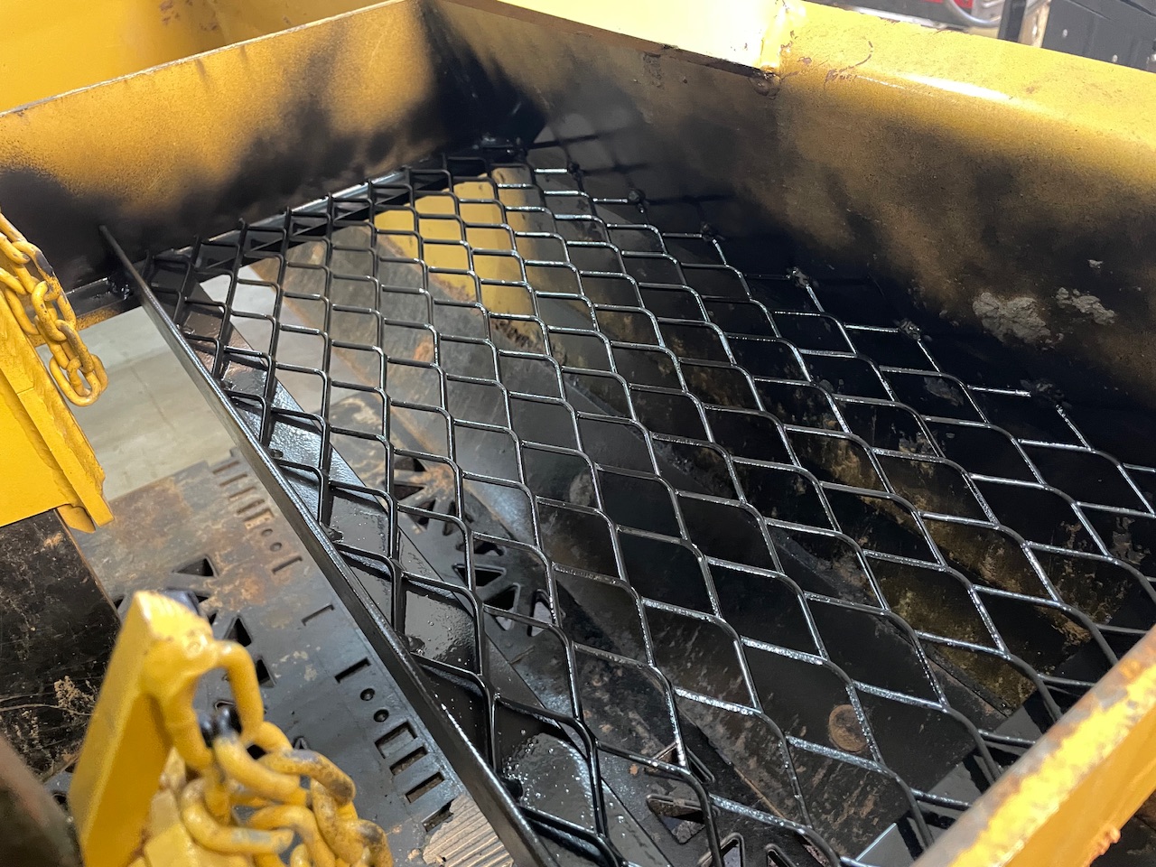

Makes an easy place to toss the hitch, for whatever reason. Probably toss a short chain back there too.

Hey Moots-
I went back a forth thinking the same thing. Really wished I would have taken some measurements when blade was on tractor and level, as I took just the blade to work, to do the work. The EA blade has an angle on the back that was messing with my eyes, I leveled it up and just went for it.
I did drop the adjustable hitch down one hole since the splitter looked nose high while the box blade was high.

He’s got a top link tilt cylinder. Angle of the dangle solved. I’ve resisted the mod for the very same reasons as you but the number of times I had to swap the BB and tow bar this spring was beyond ridiculous.
Whether you hand crank the top link or use hydraulics, the angle of the vertical back wall of the BB where the receiver will be mounted changes in respect to the tongue of any trailer hitched to it. I do not see how him having a hydraulic top link solves the angle of the dangle. You still only get one chance to line the receiver up optimally cause once you fully weld that bugger in, she's all but permanent.
Yeah I can see maybe using some strong magnets to line up some mock-ups of the receiver tube out of either taped cardboard or possibly lightweight pine to determine an optimum location and angle for the 2in receiver tube. It's all academic at this point anyway asi have neither the parts on hand or the time to mess with it. But I have saved all this reference material for when I do get ready.
