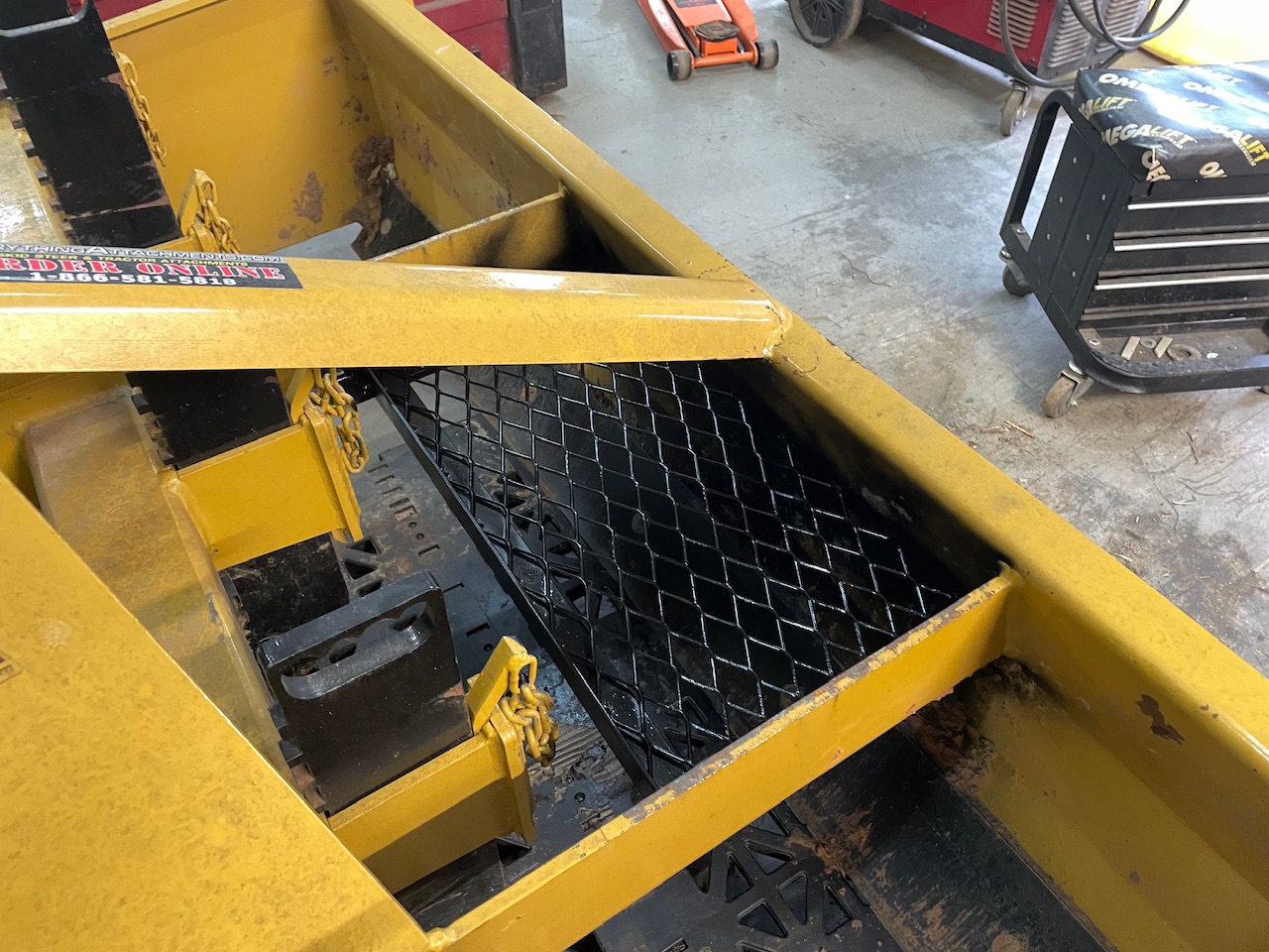

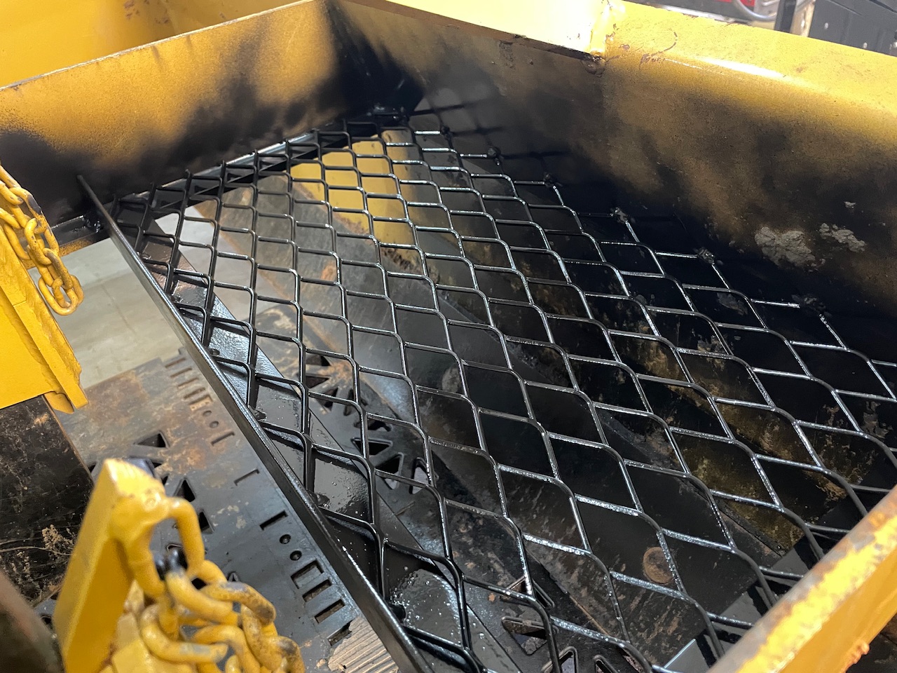

Brought the box blade to work with hopes of welding a receiver to the backside for trailers and such. Couldn’t find a suitable way without mass fabrication, abandoned that idea. Since it was here decided to weld up a quick basket for chains and the like. Pretty happy with it. Rattle can skills could use some help, but who is gonna see it? Other than the internet of course!
And yes, I painted the dirt.

You might have invented a way to screen dirt with a box blade! 😂 Rocky dirt in, screened dirt out the top.

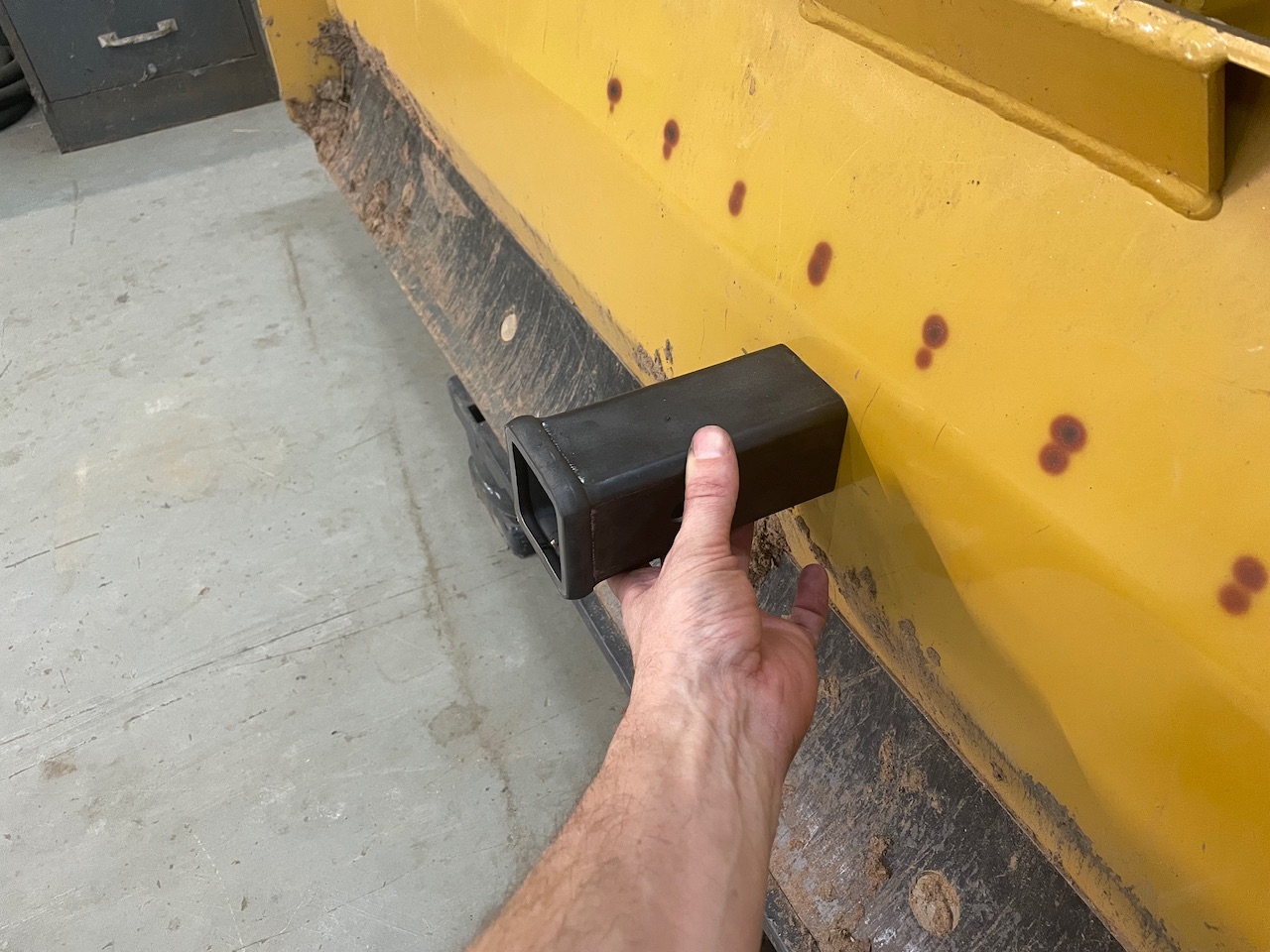

My initial thought was to butt weld a 2” receiver tube to the box, but after thinking about it, I don’t believe that would hold up over time. Even if I added some type of gusset top or bottom. Then thought about sinking the tube into the plate and welding both sides, that’d be plenty strong. Here’s what I have to work with, top placement seems too high and plate is angled, I do have an adjustable height hitch I could make work. Still concerned about the angle. And lower position seems, well, just too low.
I should have taken some measurements while attached to tractor… oops.

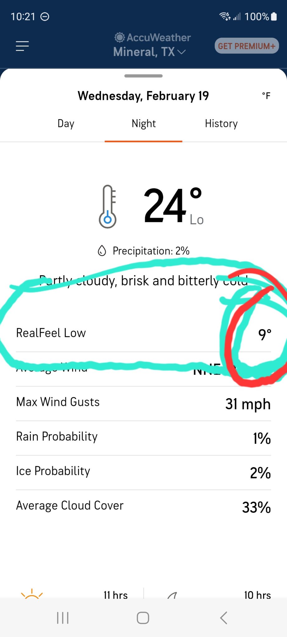

TEXAS WEATHER JUST BE THROWING OUT TEMPERATURES LIKE POWERBALL NUMBERS 76 9 27 19 83
High today 76, tomorrow night windchill single digits expected. Y'all folks up North really need to keep that white & cold crap up North.

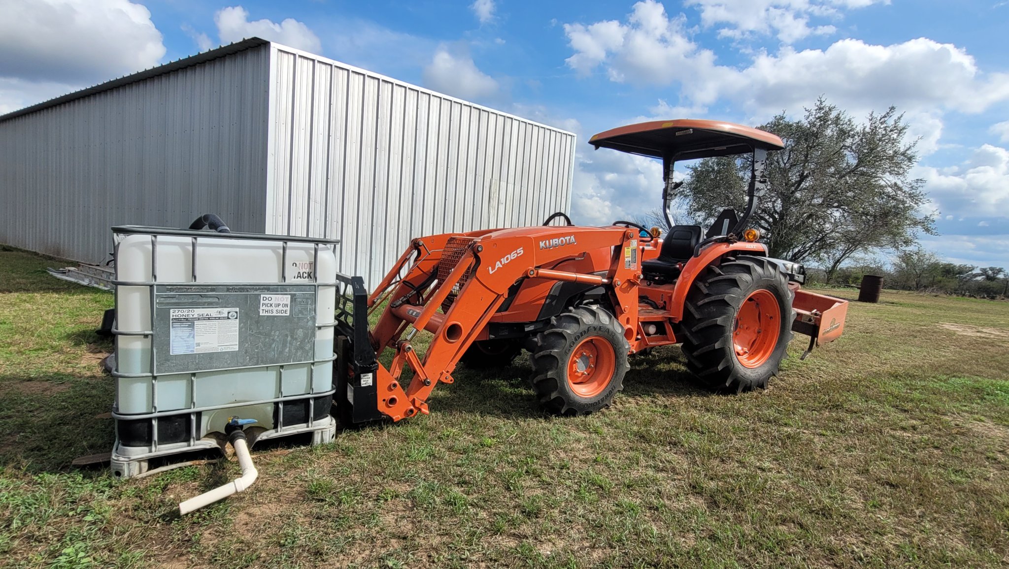

Anyways storing water in the shop for the water troughs and I put out some round bales with Kuboter.

I'd cut an angle on the rear of the receiver tube so that the tube is horizontal when the blade is in the "tow" position. I'd then add gussets top and bottom. It'd be plenty strong. The top gusset could tie into the 3/8" plate above the receiver as shown.
I looked at a few pictures I had with box blade on tractor, thinking I’ll split the difference and mount receiver on the bend of that back plate. Gonna just suck it up and drill me a square hole so I can weld both sides.
That sounds like a good plan, and locating it on the bend will make it even stronger, not that you need it to be able to pull a tank. (y) Looking forward to a photo or two, unless some guy called Joe Smith is doing the welding! 🤪
