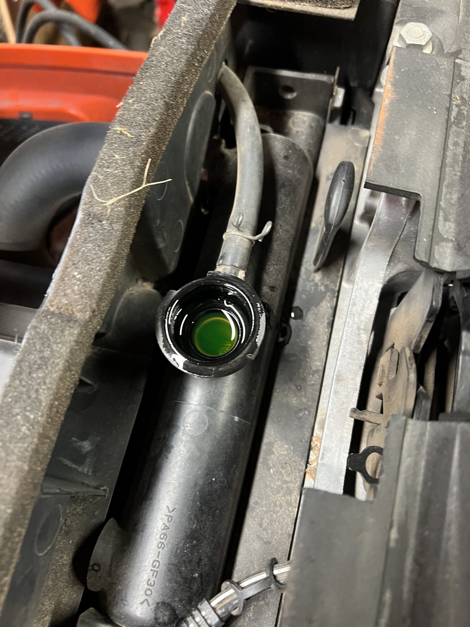

I will warn you when you have a leak like that it does not pull fluid from the reservoir back to the radiator.
So let it cool completely then open the radiator cap and check radiator fluid level directly. ;)
Thanks for pointing that out, I tried to check it this morning but I couldn't get the cap off. I tried and tried and ended up cutting my finger open. I might have to buy a new radiator cap in case I break this one trying to get it off.
What the heck 😤
3,695
6,009
What the heck 😤
Were you pushing down on the cap while trying to turn it?
10,191
7,083
What the heck 😤
Only take the cap off when cold.
Try pushing down on the cap a little when turning.
Shouldn't be hard to take it off.
Are you turning in the correct direction? Should be lefty loosey-righty tighty....
7,959
3,248
Shoot a little lube up under the cap where the lugs are.
