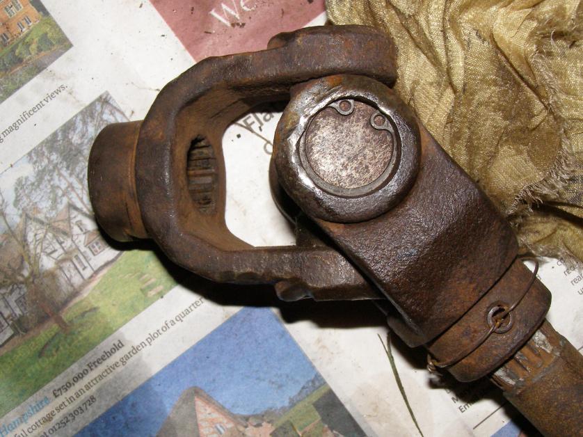

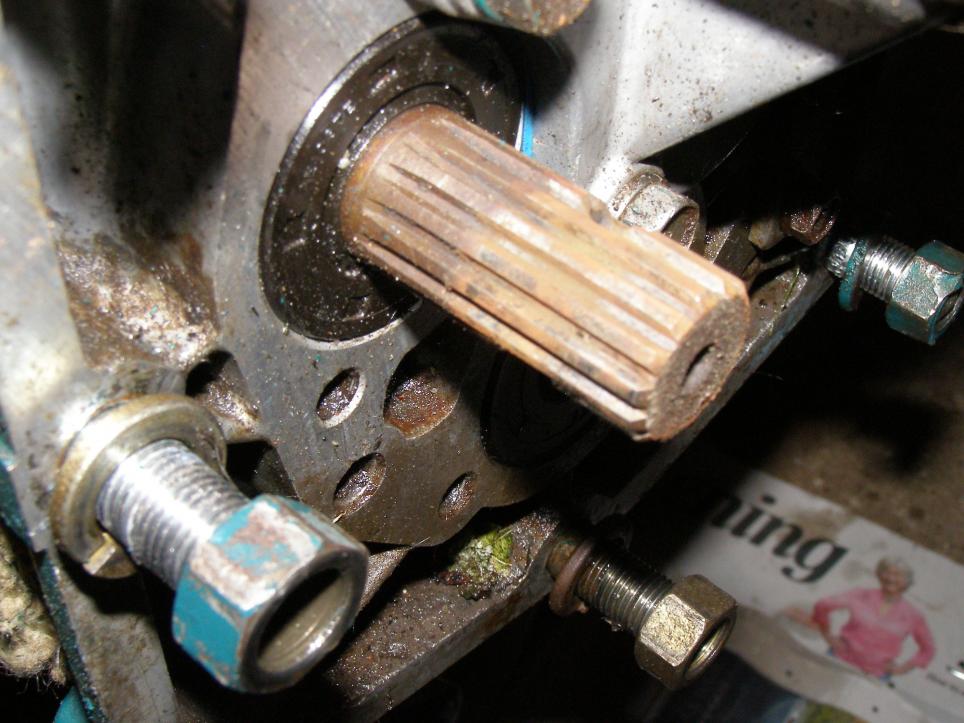

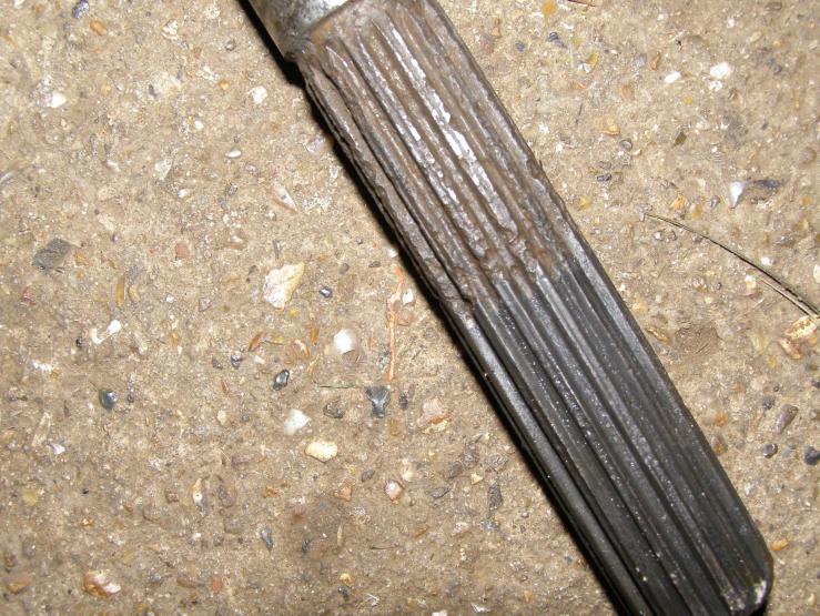

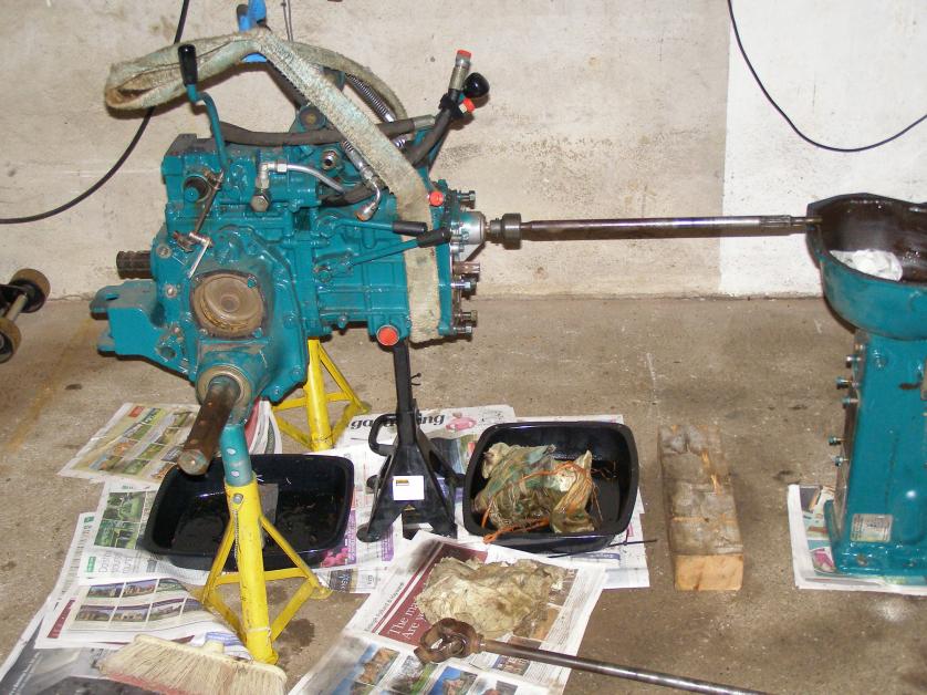

well then, this is where i was upto after i finished the engine project, I start a new project to rebuild the whole tractor from the ground up everything in bits and just the rear end left to strip down.
I stripped the rear end down completly, replaced several gears, both output shaft to the engine & fwd, also both shafts and all the UJ's.
Also replaced the hydraulic lift arm shaft ,bearings and seals.
pics attached.

I also replaced the complete front axle, not sure i really needed to, but i had a very good low hour/useage unit which had to be a better fitment than the original 5000 hour item .
Another area that had a major fix was the transmision tunnel/bellhousing, at some point in the past the original had be broken quite badly where its bolts to the rear end assembly, then welded ,but very poorly ans such the studs were bent and the nuts were cross threaded also, all a bit of a botch job.
I had the B7001 item which is the same except that it lacks the timing inpection hole in the bellhousing, so not a big issue.
retro fitted that along with the allmost new realease bearing etc that was in it, certainly a bonus.
fitted all new studs to the geabox face / tunnel joint.
all those parts repainted and ready to be rebuilt.
pics.

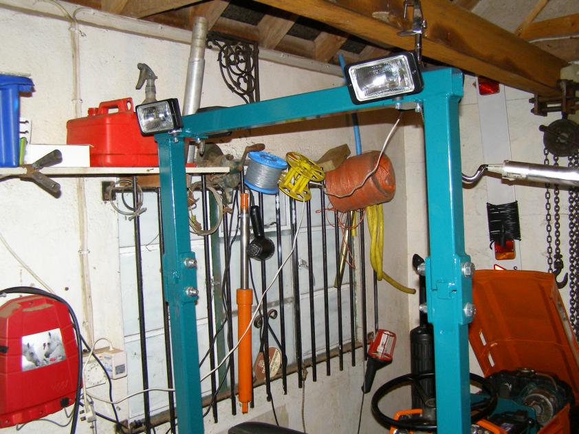

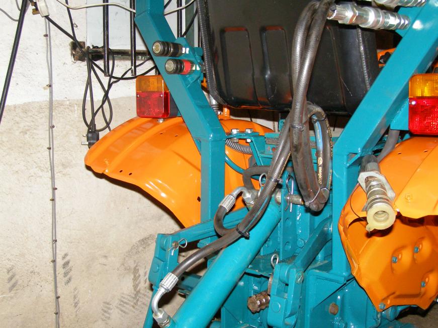

While i had the tractor stripped down i decided to sort out some extra lighting.
Fabricated some brackets to mount work lights and driving lamps on the top of my ROPS , welded the brackets to the rops, just right.
2 forward facing lamps halogen 55w each and the same setup rearward to act as work lights.

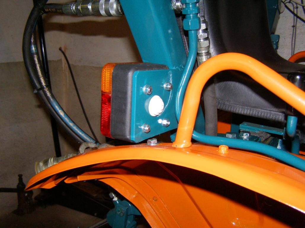

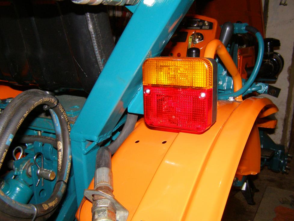

I also wanted to refit some rear road lights , the original kubota lamp clusters are no longer avaible in the UK, and even if they were, at £120 each side i certainly would not be paying that price.
I did the same as above, fabbed some bracket and welded them in place on the rops either side of the seat.
Lamp units were £5.00 each complete are are just as good as the kubota units, they are much better fitted close to the rops bars as it get them of rear wheel arches and adds a bit more protection.
So with all those bits added to the rops and with my hyd connection also on it , the rops is allmost becoming my control centre;);) just need to add the 12volt aux power output sockets to it.
pics

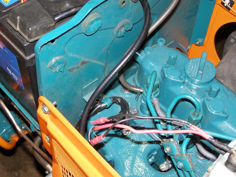

pics also including the rebuild 850 engine fitted and raring to go...:D
so thats where i'm upto now, a bit of wirirng and get the wheels back on.
I am still trying to get my new tacho fitted, i really need to know if it going to work on the 850 engine to be honest, so if any one can help regarding compatability with geardrives and cables , please let me know.
rob

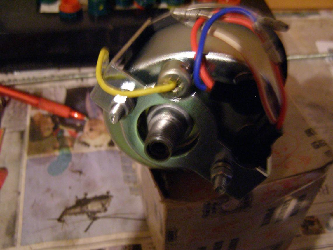

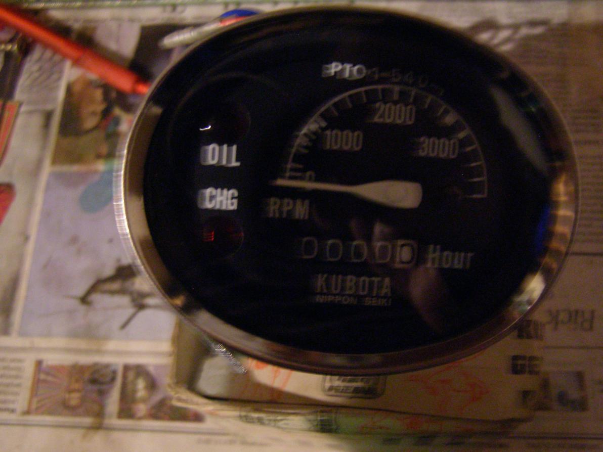

On the subject of the tacho, i purchased a new and boxed tacho which the box says L1501 fitment,, but as i only paid £5.00 for it i didnt think i could realyy loose out to be honest.
It was an ideal unit as it has oil pressure,charge, etc warning lamps aswell as a tacho and hour meter.
It is just a case of fitment issues, what cable do i need and will that cable work with the gear drive that fits the 850 engine.
I understand that some have differing gear ratios and cables may not fit correctly.
anyway pics, and help would be great.

I like the way you did the rear hydraulic ports! I never seem to have the patience to do such a terrific job. Well done!
Thanks for the pics...

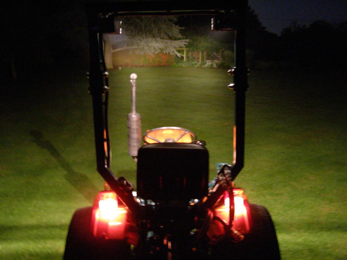

anyway , finally got the old beast out tonight and powered up the lights, they certainly do the job i had in mind, front and rears.
I think the 4 extra halogens plus the onboard electrics are probably at the limit of my 45amp battery and 35amp alternator.
pics here.
rob.
ps, not bad for a Duc owner...:cool:
14,213
2,871
DAYUM:eek:,, thats a bunch of light,, Tell me about the lights you used if you don't mind

I remember this picture Rob! Did you say that those lights ran off the stock alternator, err, governor? I'm getting a ROPS soon and I just may hook up some lighting to it.
Rob
B6000DT / B7100DP /B8200DT/L225/Globe PTO Chipper/Lewis Backhoe/huxley TR66
Nov 22, 2009
679
Leafy England....
thanks for reply, yes they do run from the stock alternator.
I originally fitted them to the 35amp alt and they worked great, but recently i have changed to a slightly larger capacity unit at 45amps with a built in regulator and did away with the original standalone reg that was fitted on the bulkhead.
All works a treat, but please remember, alot of the UK spec b series tractors came with the top mounted alternator to handle the increased electrical output on UK spec machines, a lot of you guys in the states will not have this setup.
hope that helps a bit.

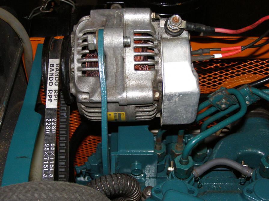

pic attached of my 45amp unit, a bit smaller overall than the previous 35amp unit, but good retro fitment.
rob

Where does the other end of the alternator belt connect? Do you have a double pulley on the belt tensioner?
Rob
Nov 22, 2009
679
Leafy England....
Yep , dual belt pulley wheel.
All versions that use the top mounted alternator such as this have a dual belt pulley from the factory as standard, but i dont think other spec machines destined for other markets may have them.
