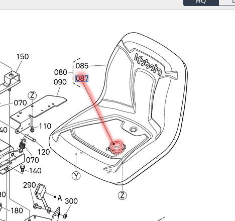

Well I did look and the switch is not the same as the levered one used on my L3901. Its item 87 on the parts list but if its in the diagram I cant find it.
