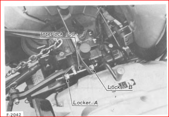

Have you checked your hydraulic return linkage on your right rear?

The tractor shows 1530 hours and the hour meter does seem to work. It clicks as long as the key is on. The return linkage is not adjusted properly. Thank you for that tip. With the trailer hitch on the 3 point hitch the top arm comes up and hits the back of the seat before the rc60 belly mower is fully lifted. It keeps the belly mower lifted but with a weight on the hitch when I have it on it leaks off. I gave it a good inspection all over last night and I found there is a tiny leak up at the pump somwhere so that could be my culprit. Gotta remove the side cover and check that out. That may be my problem. I really appreciate the replies. You guys are really helpful. I will get back on here as soon as I investigate my new leak.
