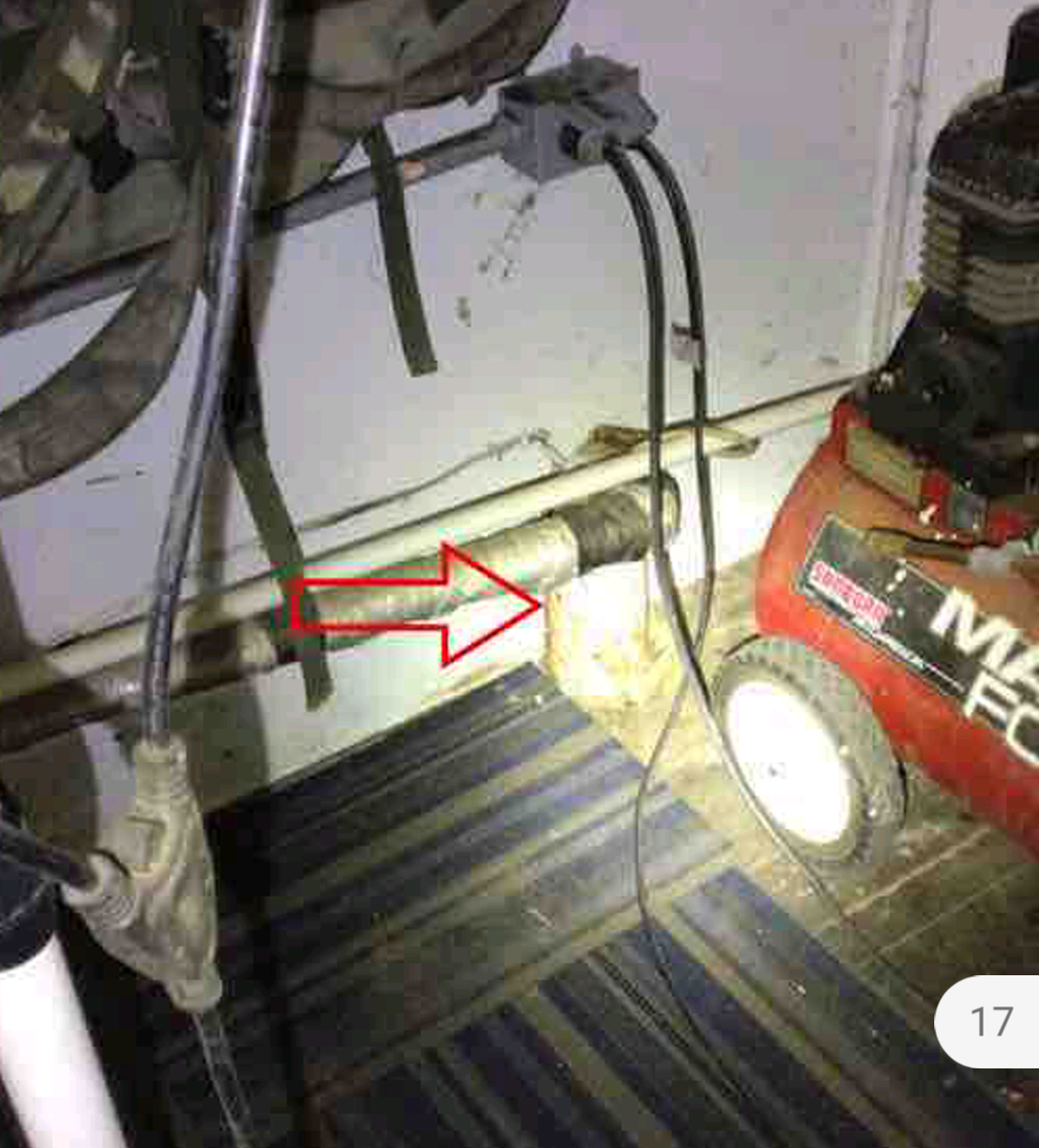

Screenshot_20220728-115421.png Screenshot_20220728-115400.png My water well cap. Pic from home inspection report.

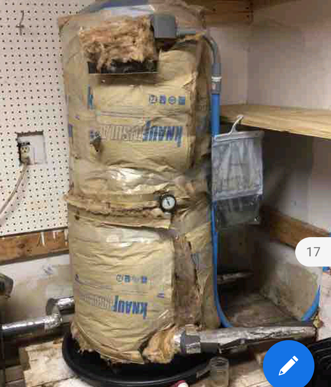

And my pressure tank.

Well that's interesting (no pun intended)....
I've seen 100's (1,000's?). Not many like that set-up.
Not going to win any contest for a neat job....
What's the diameter of that casing/cap? Is it steel?
Is that the water line coming out the top with a 90? Hard to tell w/ insulation....
Is that the electric line stapled to the wall?
Is there really a cap on it?
PS - - Northwoods - I deleted my other message after seeing your pics...

We need way better pic's of this. Remove all the insulation from the tank and get something better on what you're calling the well cap. and wiring as well.

I'm not home. Will be there tomorrow and over the next few days I'll pull off the insulation and take a better look at the "cap".
As I said, it's a former part time use cabin / lodge / house. I have my work cut out for me.
IDK if there's an actual cap, it looks like duct tape to me in the picture. I'm not there now. IDK is that is the actual casing, or if it's plastic or metal. Lots of unknowns at this point.
The electric romex on the wall is for the pump. The other electric by the 'cap' is for the pipe heater.
I'll follow up in the next few days once I get there.

@RCW :
You haven't seen any like that, and you've seen 100's... That's disconcerting for me.
Cap and casing material is unknown right now.
The workmanship of the whole discombobulation is "sh#+.
Yes, that's a hard and full 90 degrees ell at casing top.

Is there a hatch or window above the well to allow the pipe and pump to be pulled? Why would anyone run pipes and wiring over the well to interfere with pump service. You are spot on with your statement: "The workmanship of the whole discombobulation is "sh#+."
Now that this mess is indoors, will it ever be exposed to freezing temperatures?
When I saw that I was trying to imagine how they pull the pump out of the well for replacement or worse trying to pull and set a new screen. Work probably requires a plumber and a carpenter...

You are both correct. The only good part is that it's all under a single story addition to the house. Previous owner built a screen room and roofed over the well.
The good part for the repair:
I spent 20 years in construction and I am able to remove the roof and/or walls, and reconstruct, if necessary.
I just don't know much about water wells.
Thank you

It was exposed to freeze, but I'm changing that. There are no furnace flues over the well cap. Only the pipe heater under the insulation.
I'll be replacing that too.

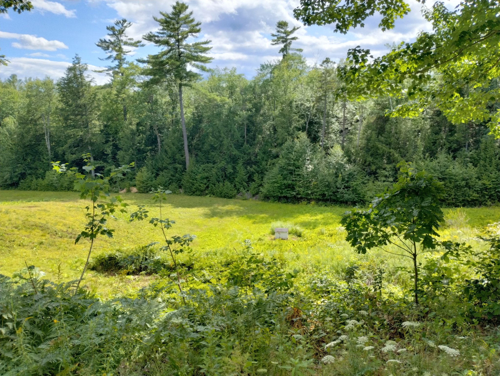

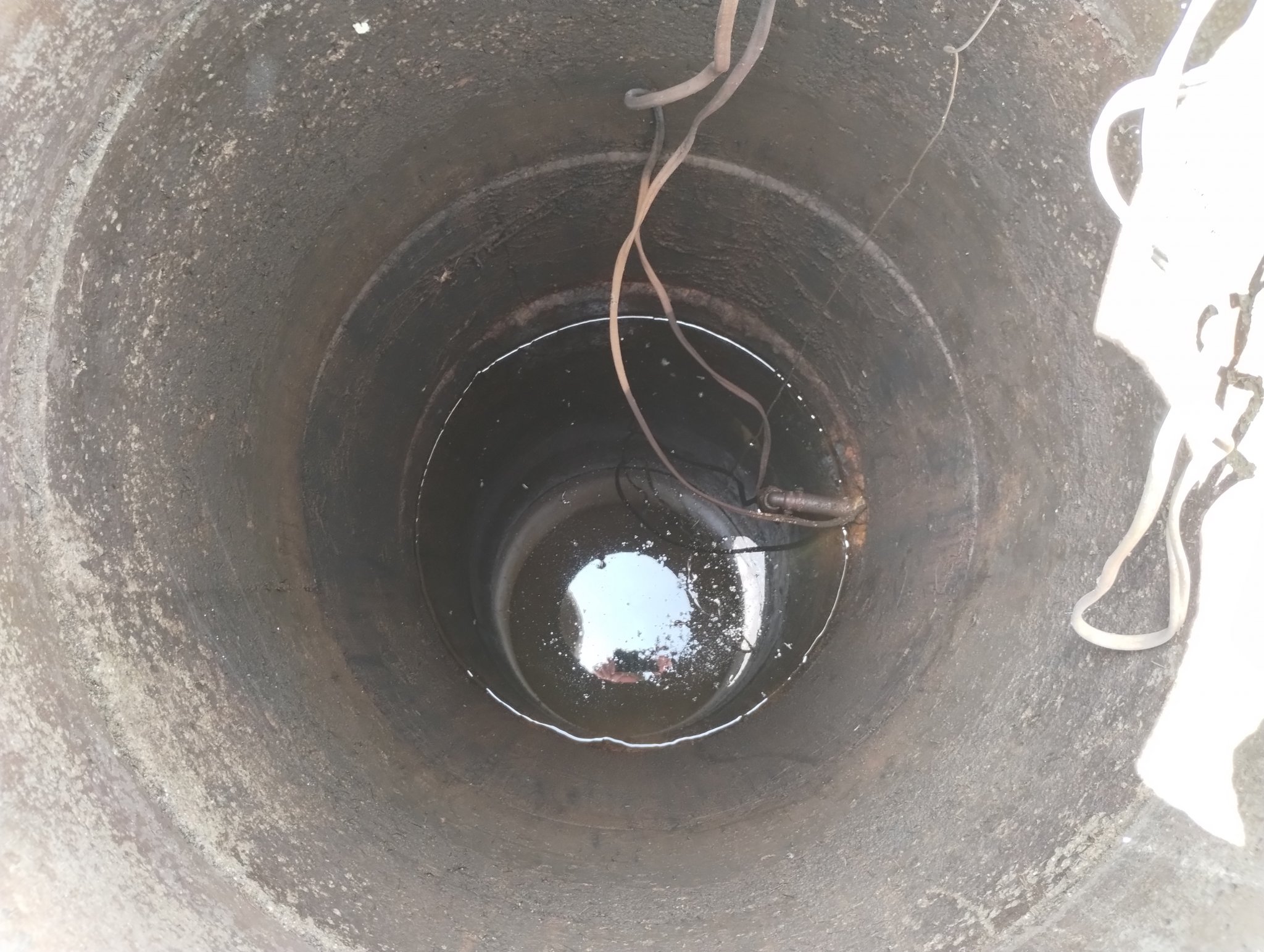

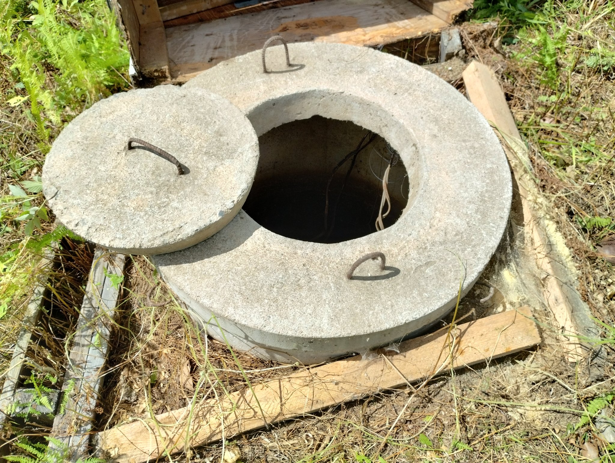

Here's a poor mans well that has never gone dry. Measured it yesterday , 11 1/2' feet of water in a 22' well. The lowest in past years I've ever seen it is 7' feet. Never lower.
As you can see its 'way' down back in my field. I had a friend from Vermont who dowsed with brass welding rods back in 1995. Found the vein several times crossing back and forth. I marked it and had it dug there.
