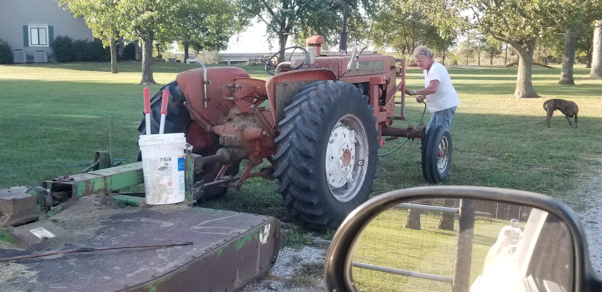

Here's a Allis D17 that had the same problem. Neighbor's tractor that had been exposed to rain for a couple of years. Runs like a top!
