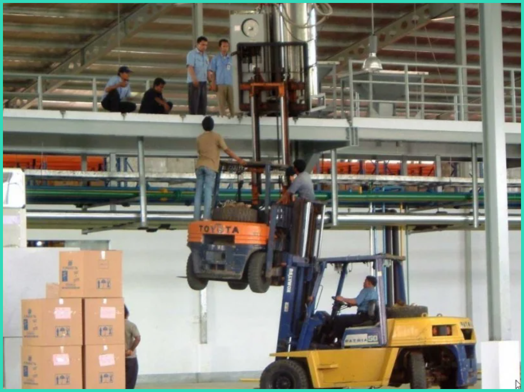

Buy a forklift!
Any adapting of a set of forks to try and gain 12" is a foolish endeavor!
