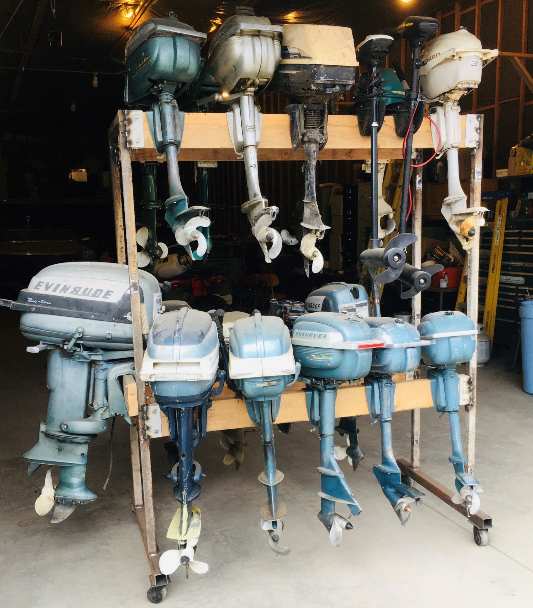

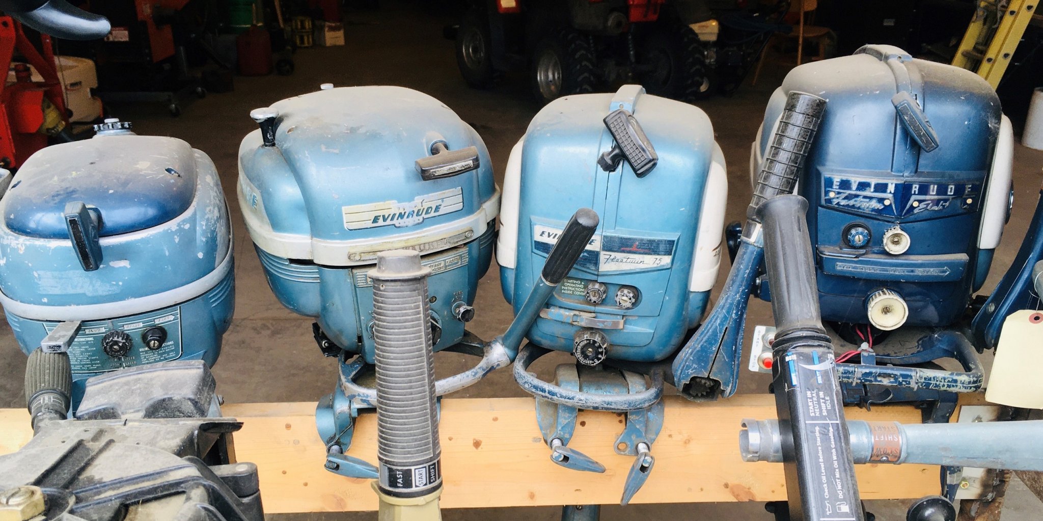

Hello, my name is bird dogger and I haven’t bought a vintage outboard motor in over 5 months! I found out I had this common disease after my dad died and I rescued his old fishing boat from the barn where it had sat unused for many years. The siblings said “Throw it out!” but there was potential in the still good hull and sound trailer. All the duo needed was just about everything. There’ll be a few pics of the process for your amusement!
Rack Side One.jpg Rack Side Two.jpg Evinrudes.jpg Johnson.jpg Scott Atwater.jpg

That is awesome. I know a guy who says he as the largest vintage outboard motor collection in New England. He does have two barns full and a bunch on display so he could be right.
I have done a bunch of welding on them for him over the years. Mostly old tin and aluminum tanks.
3,007
4,729
If you had a couple dozen boats to hang those on you’d really have something there!
Actually, those are really nice. Most of the vintage outboards I’ve seen in this area are either extremely rough walk hangers or they’ve been “restored” with a light wire brushing followed by Krylon. Once in a while I see an actual restoration or nice original and some bring good money people get so sentimental about them.
If you can find the parts, those old 2 cycles are fun little things to work on (so long as you’re not in the middle of a lake while you’re doing it). Their simplicity and reliability is impressive.
My Dad has an old Crosby tri-hull with a 25hp Mercury from the mid-60’s stored in his basement. We got the motor running for virtually nothing and considered rebuilding it a while back. It did run OK but compression was a bit low and one cylinder wall had some scoring. Looking into the project found most all the lakes around this area prohibit 2 cycles which takes out most, if not all, of the vintage motors for anything but wall hanging. Kind of sad they’re not on the water any more.
Abandoned the potential project as the only option was re-powering with a 4 cycle and not only was that expensive, it pretty much obviated the impetus for the project.

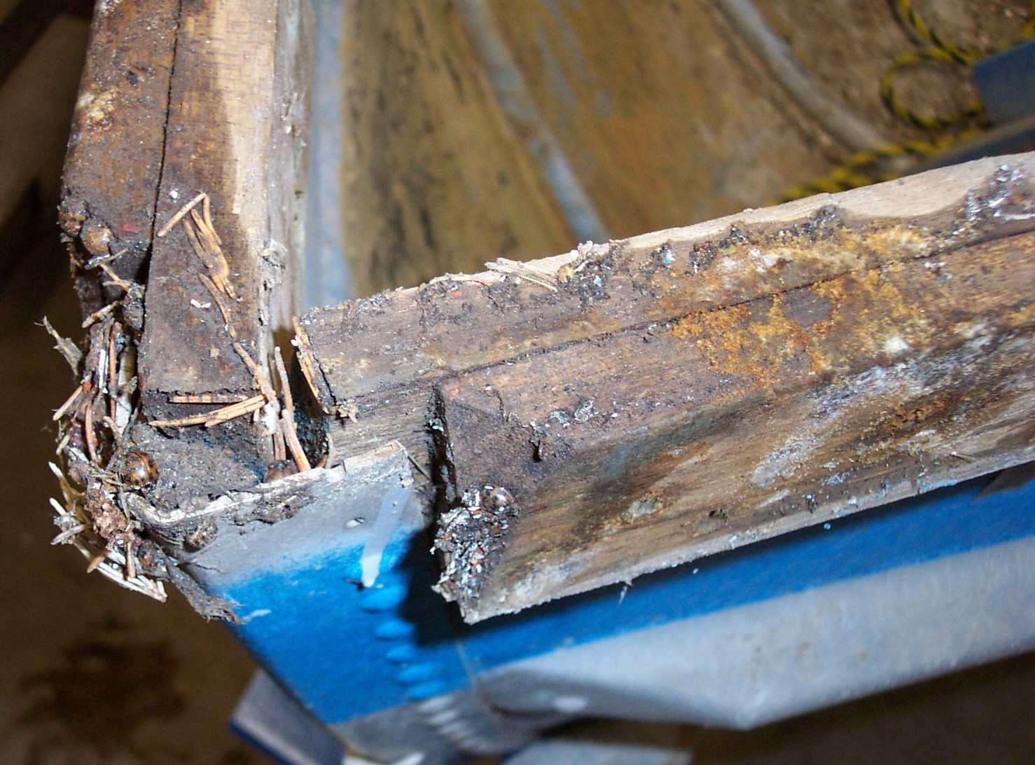

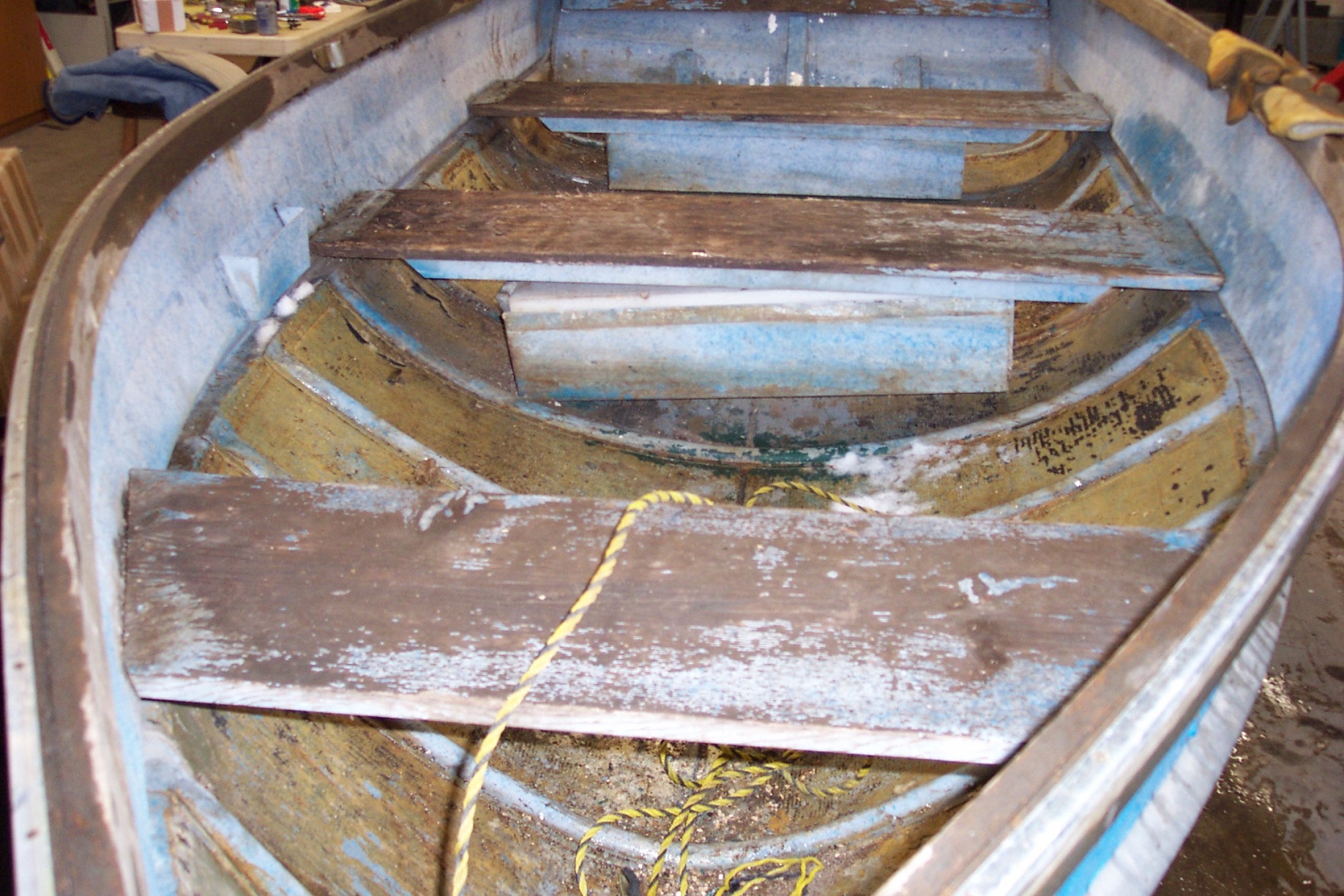

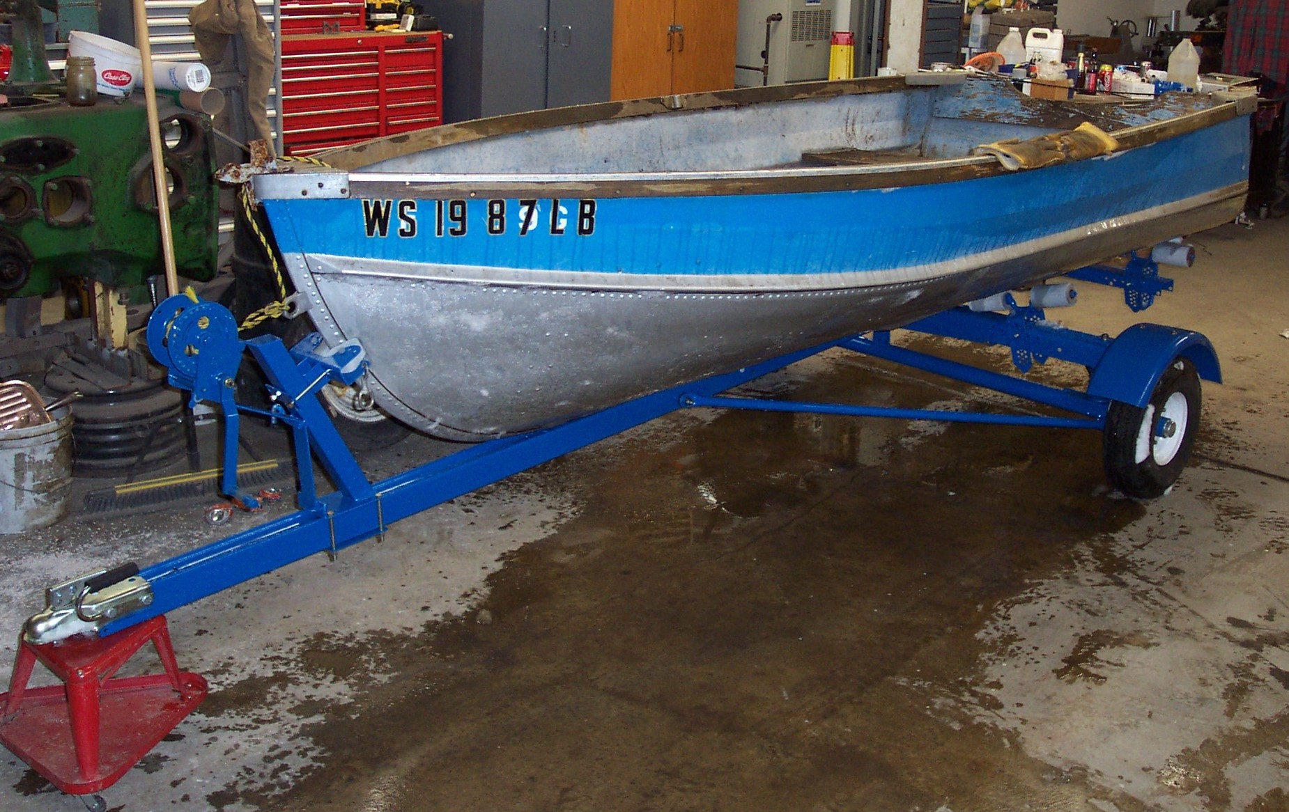

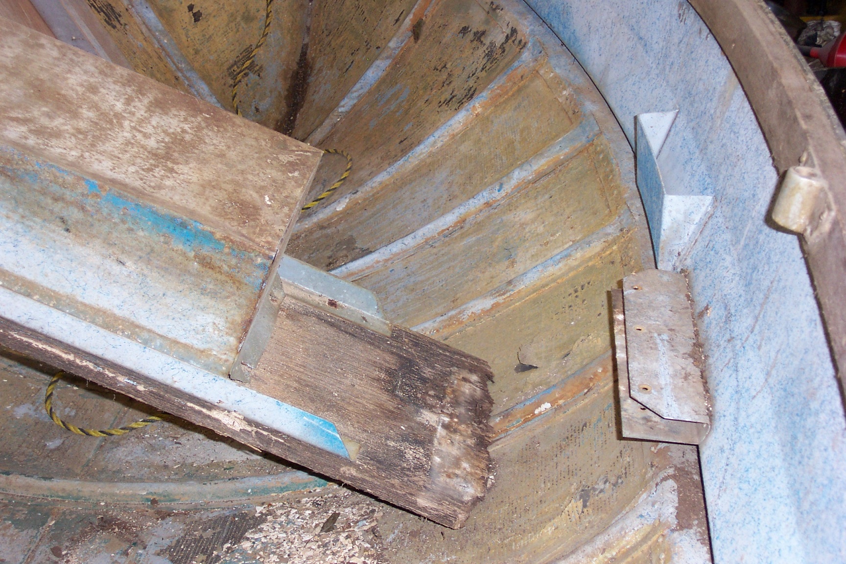

After hauling the “duo” home from Wisconsin it became quite a project from start to finish. It’s a little beyond getting by with just using Rust-Oleum’s Wipe New products. 😂 Here’s the “as found” pics. You can see the wooden seats were completely rotted. Same for the gunnels and the wood transom motor mount. The seats and gunnels appeared to be made from mahogany. The task looked daunting!
Boat Trailer as Found.JPG Boat as Found.jpg Boat Seats.jpg Seats as Found.jpg Mahogany Gunnels.JPG

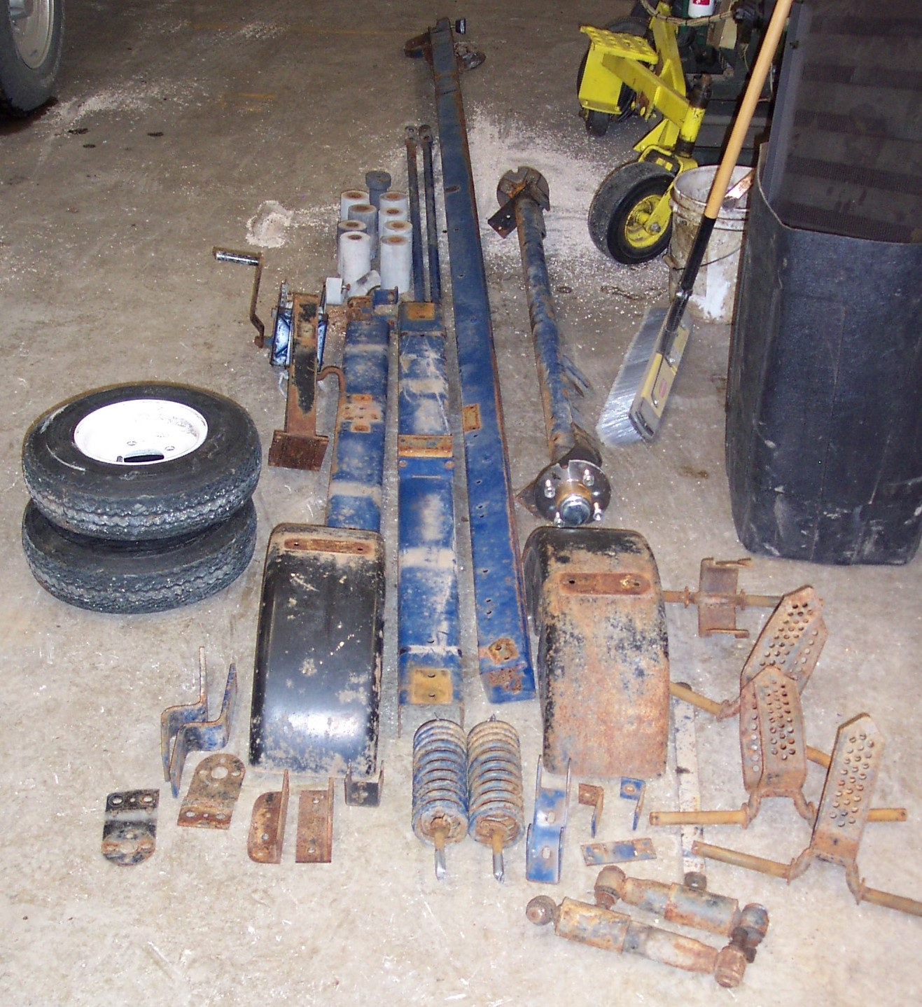

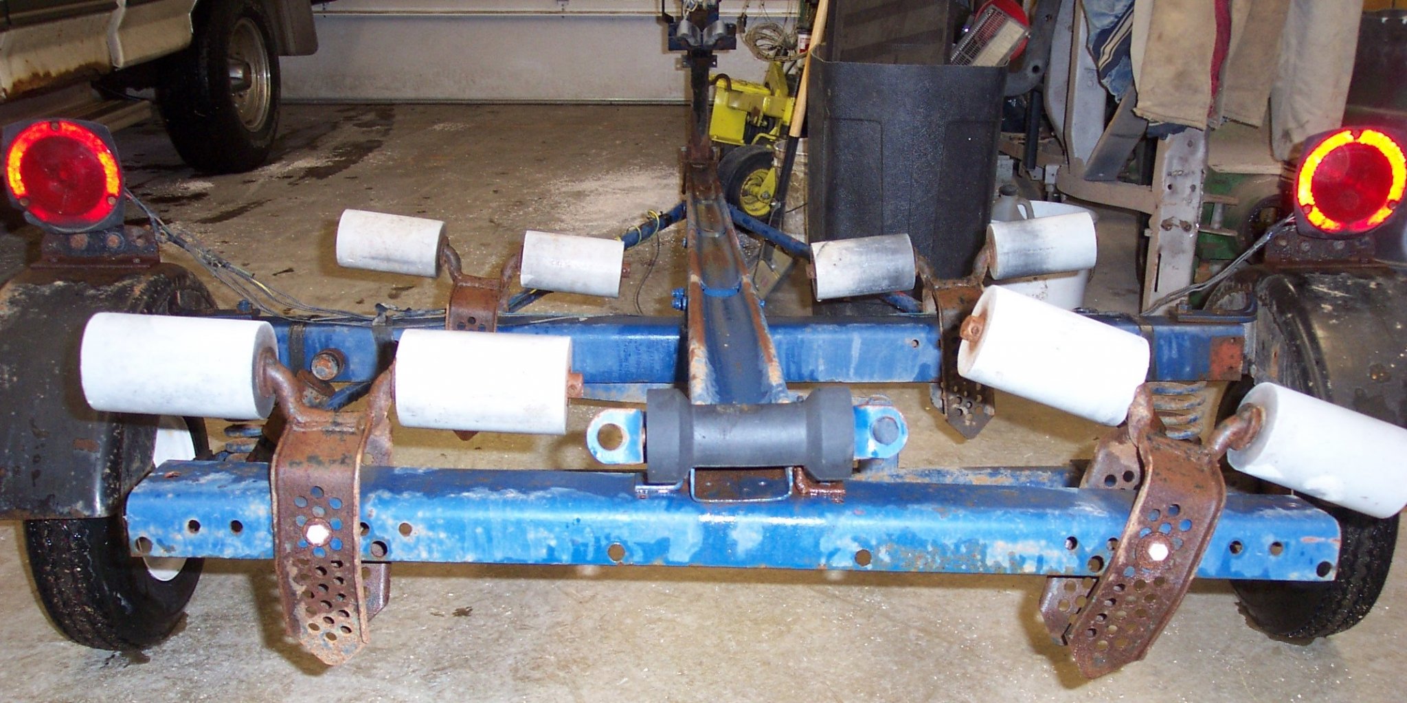

First up was completely stripping and rebuilding the trailer to allow moving the boat in and out of the workshop for its refurbishing. New tires, rims, bearings, hitch and lights were purchased. All other parts sand blasted and painted. For a 70 year old boat trailer it looks functional again.
At least now the boat can easily go in and out of the shop when working on the boat itself.

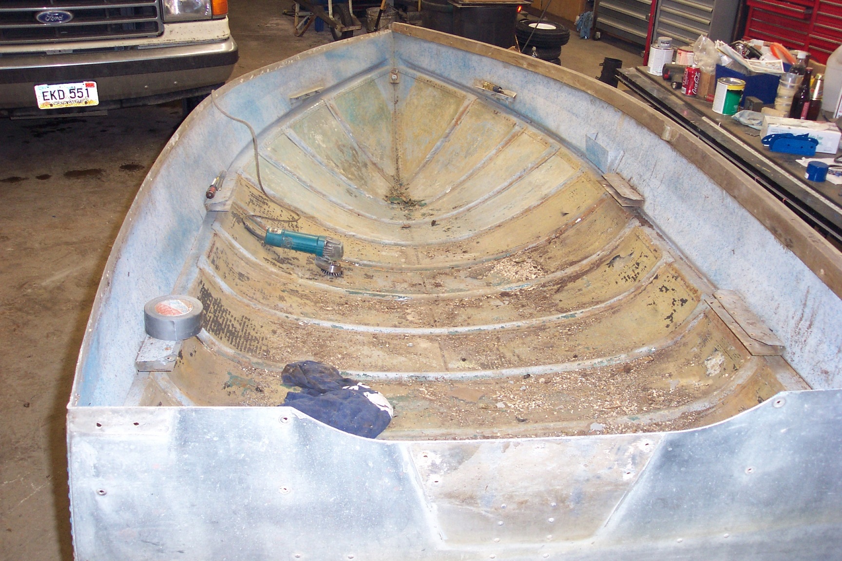

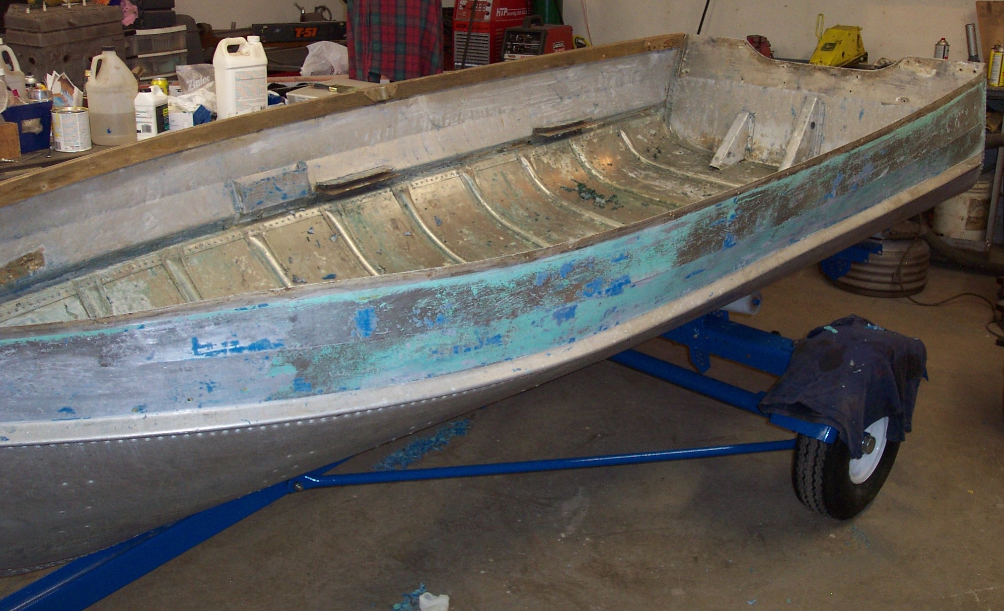

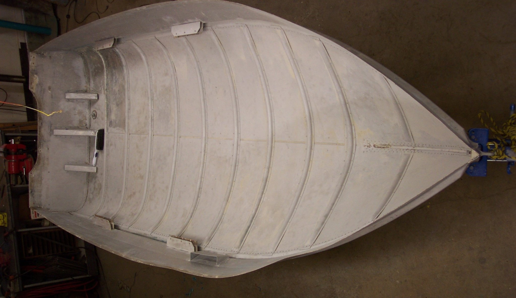

Stripping the hull of old carpet and multiple layers of paint uncovered the original data plate. The boat is a 1953 Starcraft Speedster, 12 foot. And what first impressed me to keep and redo the boat was its “deep vee” hull, especially for such a short boat. Also revealed was the outline of the missing Starcraft logos that were apparently pop riveted to the rear sides of the hull. All the wood (seats, gunnels, and transom) was completely deteriorated from pigeon and raccoon droppings, moisture, and whatever else ended up inside the boat while sitting in the old barn.
Stripping Exterior.JPG Stripping the Hull.jpg Data Plate Found.jpg Starcraft Logo Remains.JPG Ready to Finish.JPG
Things always look a little better and the project doable once all cleaned up so you can see what you have.......or have not! :ROFLMAO:

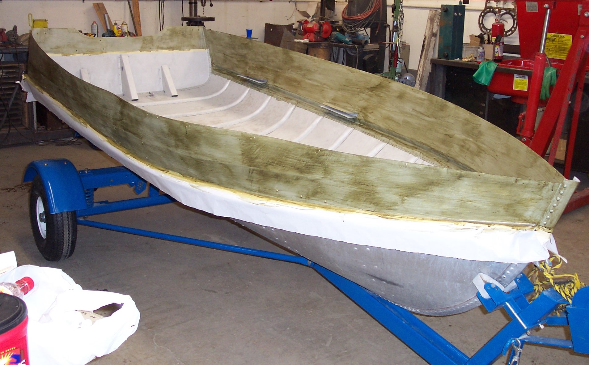

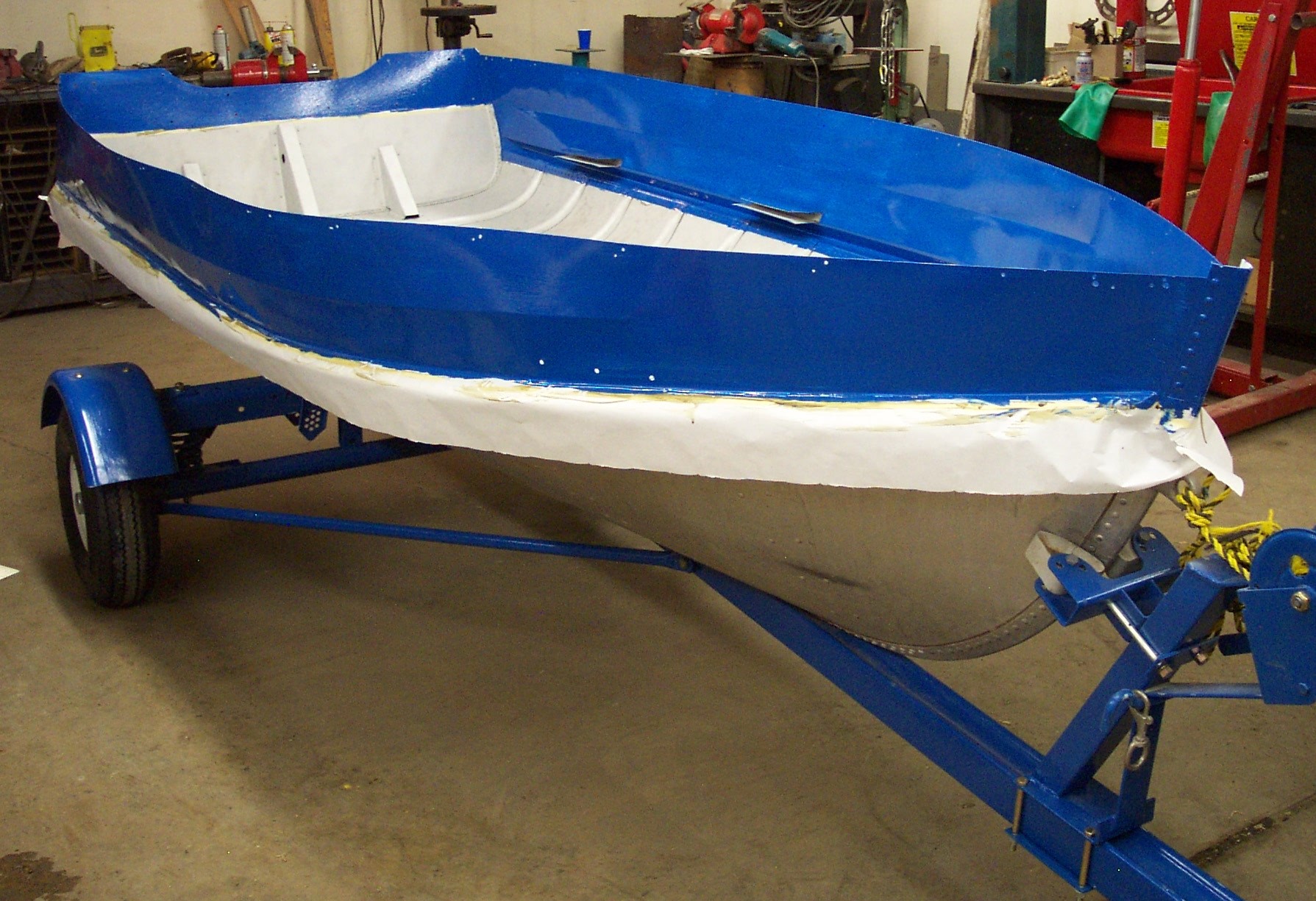

Masking off and lightly sandblasting the formerly painted areas prepared the boat for a final cleaning, aluminum acid etch primer and top coats. Here's pics of the start of that process:

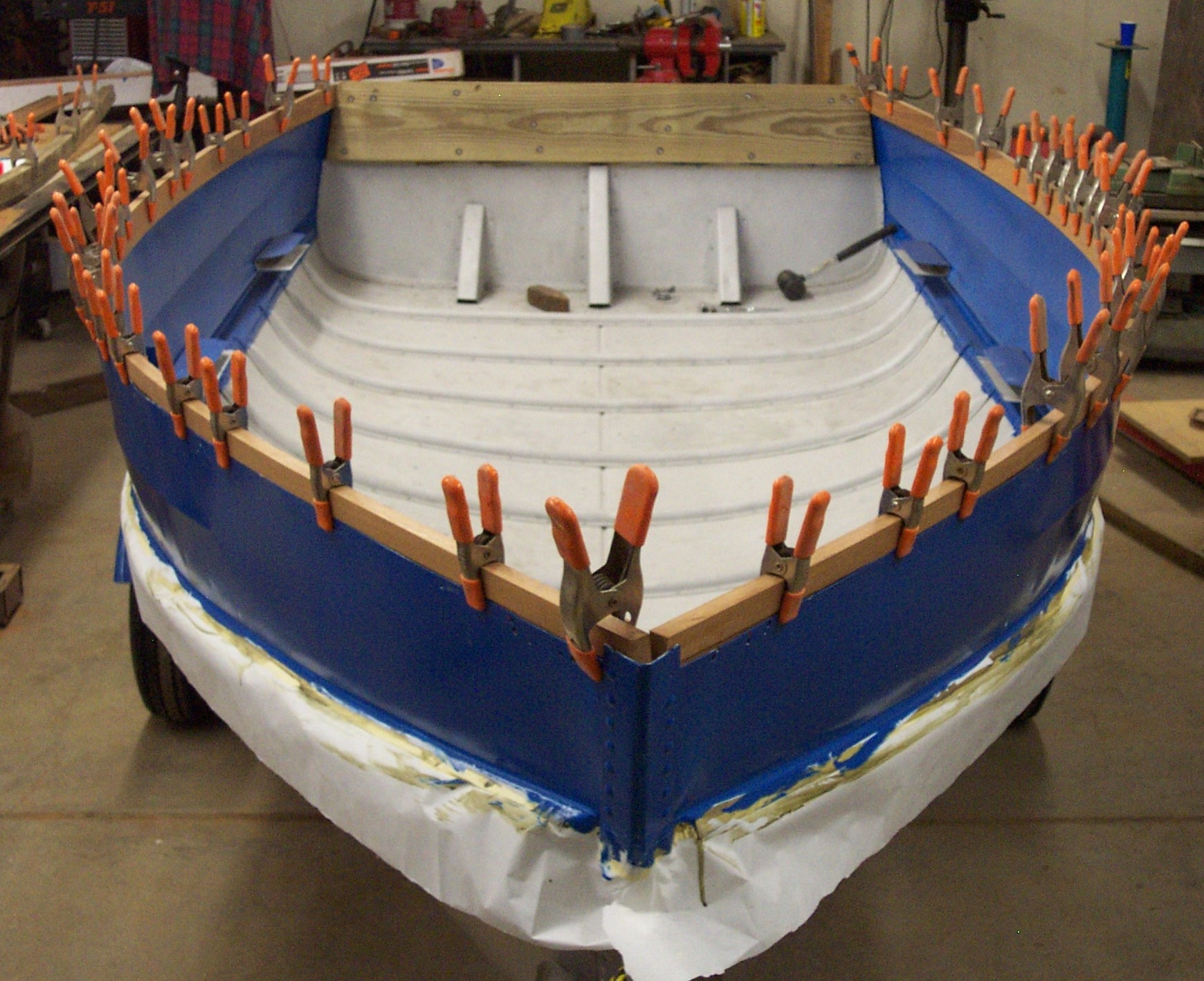

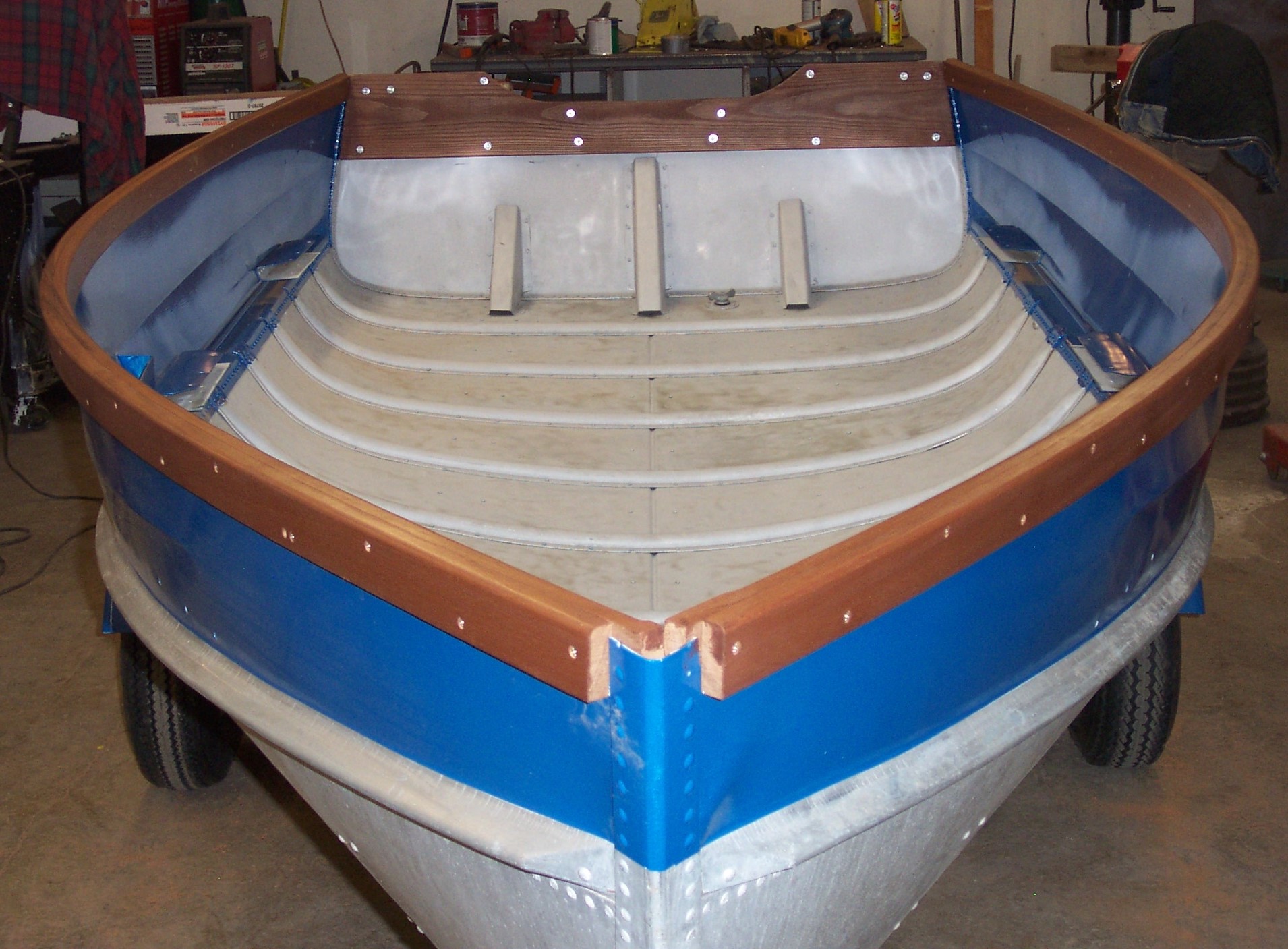

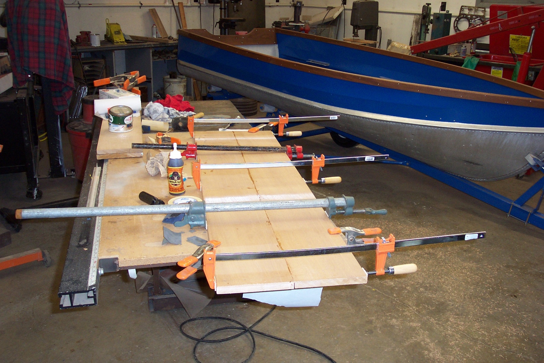

Next on the project list: fabricating new mahogany gunnels. Each gunnel was made in two pieces with one piece rabbeted out for the thickness of the aluminum hull It took lots of clamps and figuring out a new screw pattern to avoid the old gunnel holes during the gluing/screwing of the gunnel installation. A trimming router put a nice corner round on the edges and a final sanding prepared them for stain and varnishing. A leftover piece of Permanent Wood Foundation 2” x 10” plank found use as the new motor mount transom material.

Cool! And so glad you are well stocked with clamps!
A person can never have enough clamps at their disposal, can they? 😂

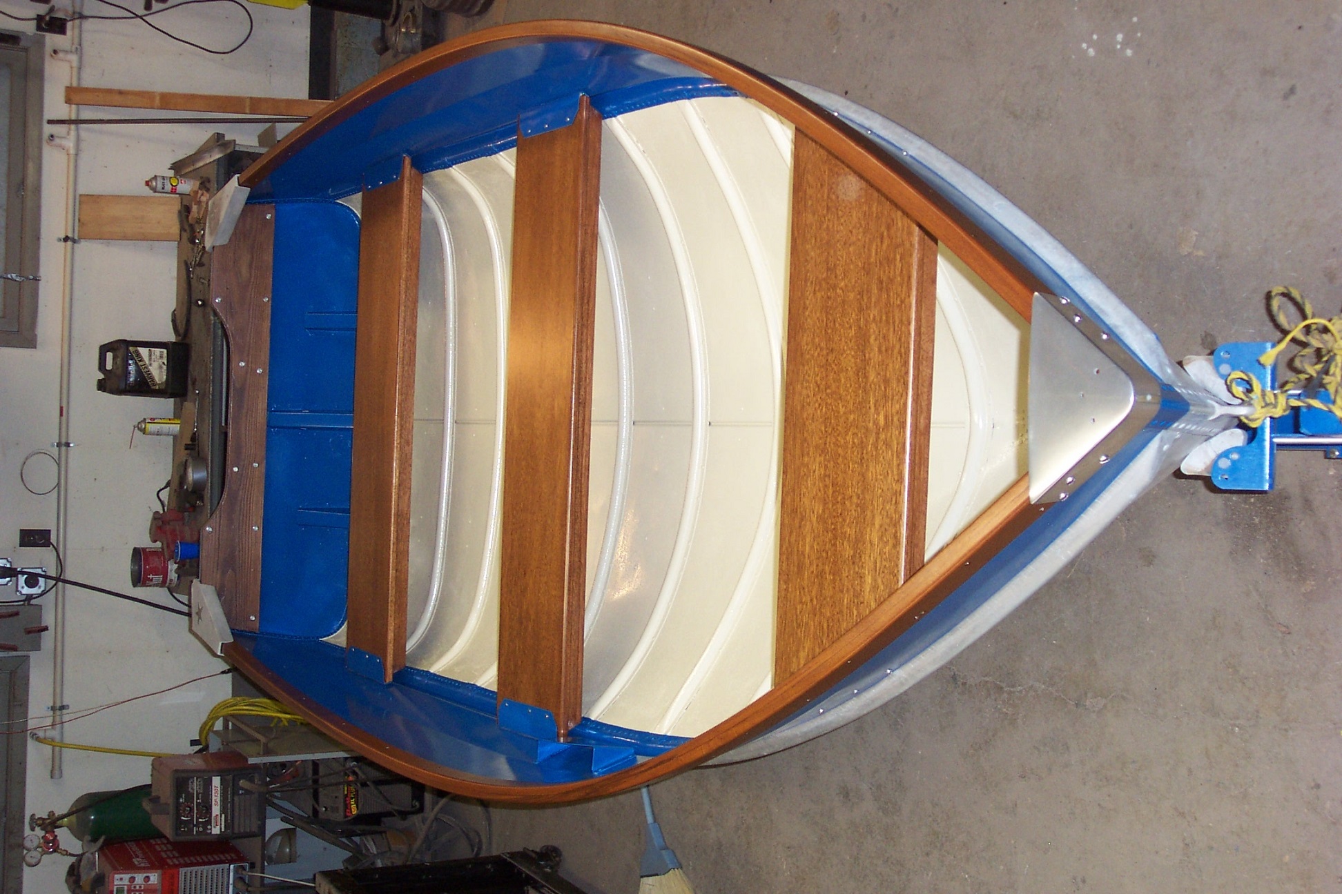

Seats were made from glued up mahogany boards to the proper width and installed. The bow and stern corner fittings were cleaned up and reinstalled.
A session at the drafting table produced an acceptable paper template for the missing “Starcraft” logos. I cut the logos out of some scrap aluminum plate and mounted them using their original holes in the hull.
