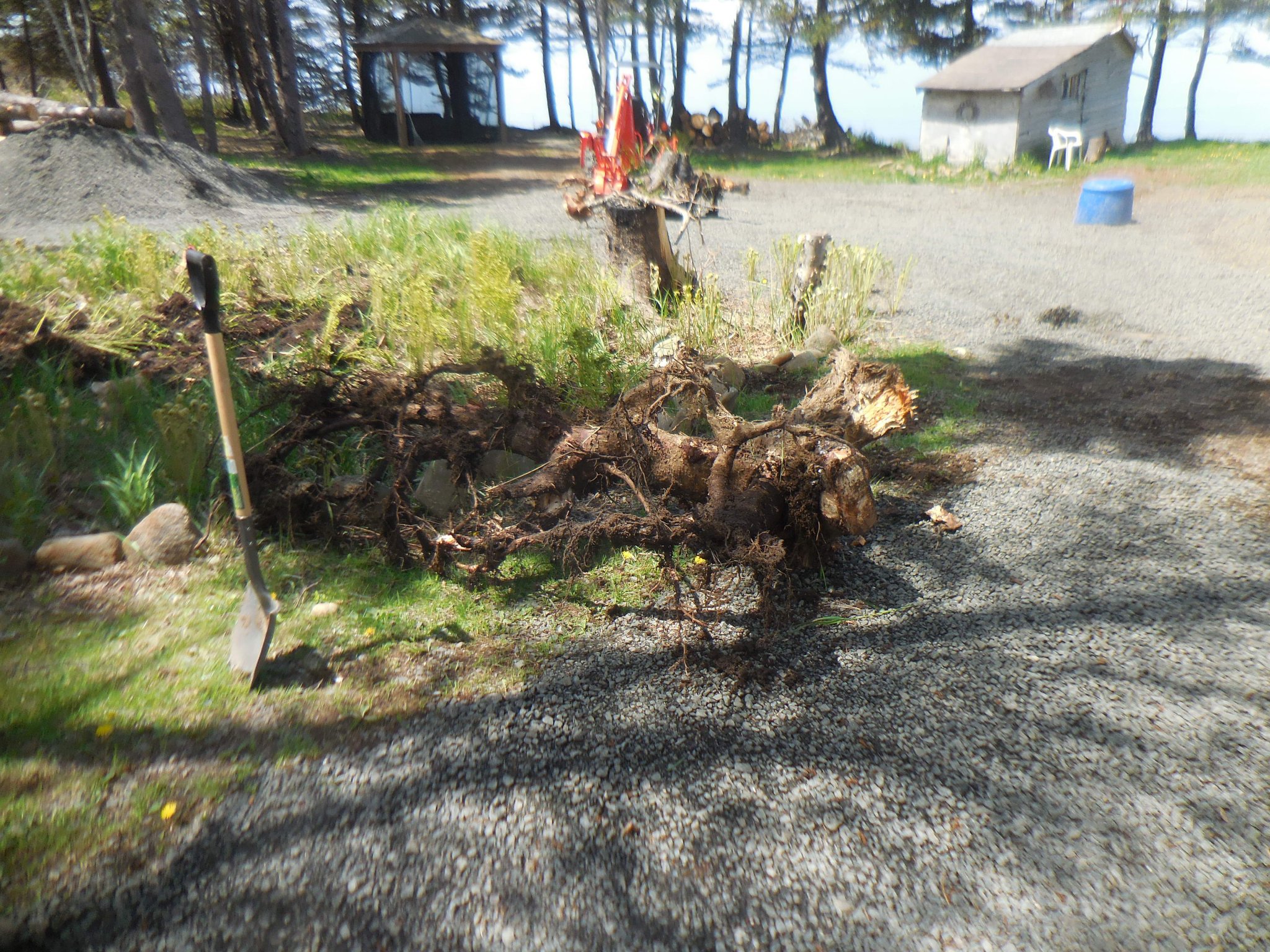

I wanted to thank everyone it was just a matter of experience I pulled out these two stumps in about 30 minutes and I could see a future with more skill where it would take 15minutes At first I was not that impressed with the backhoe but now I am thinking it is really awesome. Do people leave the tractor in gear or in neutral when using the backhoe? Is it ok to move the tractor around with the back hoe? thank you My wife fixed up my hard board grill guard so a picture.

Nice job. Stumps are a pain depending on the type of tree and age etc and each one can be different.
You did good and it will come faster each time. In my case, efficiency with the BH increased exponentially after getting enough hours in to get where you are "doing vs. thinking" about the controls.
I have not regretted getting the BH and use it all the time :cool:

I have maybe 10 hours on the back hoe now and have already gone from thinking it was a mistake to seeing the potential to use it a lot. you are absolutely right about doing vs thinking. spend a minute or to getting a big rock in the thumb and try to move it sideways but use the wrong lever and drop the rock. still in the thinking phase. I think the way it can move the tractor around is off putting when starting out.
