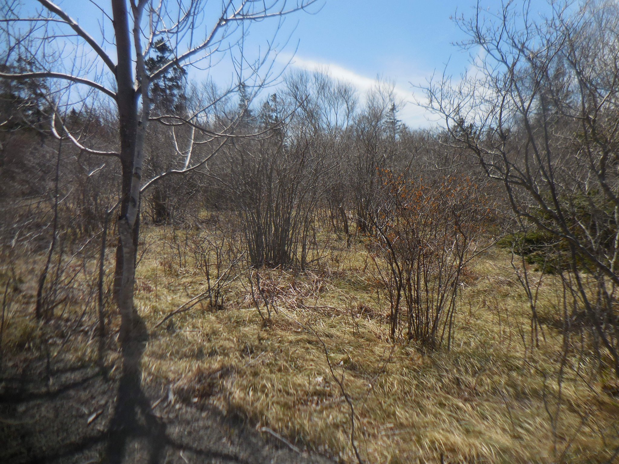

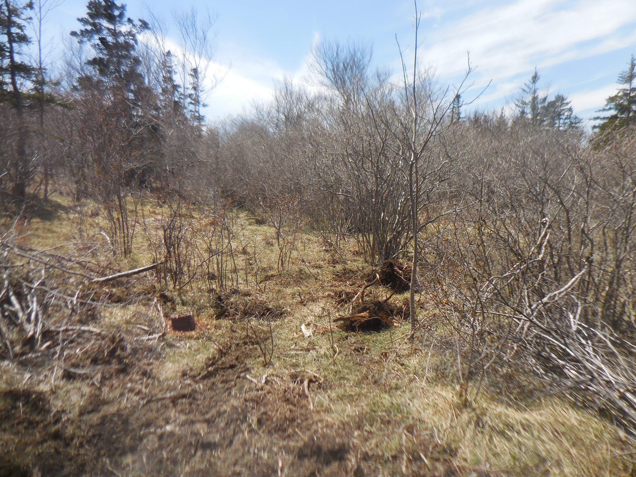

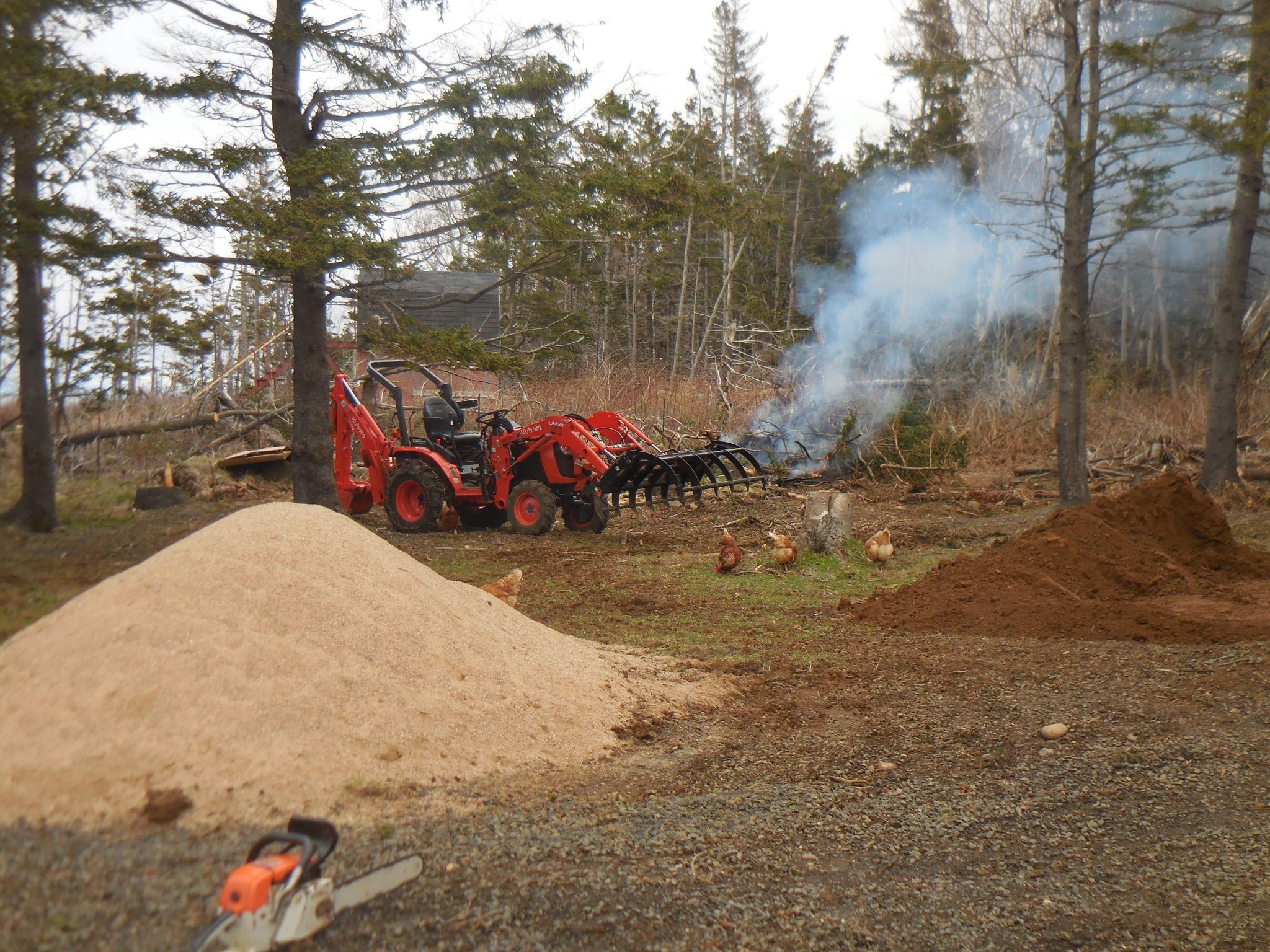

thank you here are some pictures of the brush the land is mostly beach rock with enough dirt to keep the rocks from knocking together when the wind blows hard.
I do have a thumb and have used it to move logs and rocks that the grapple cannot reach . I really only have less than 2 hours using the backhoe here is an idea of the brush and a storm cleanup picture with the grapple on.

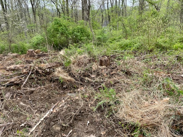

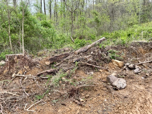

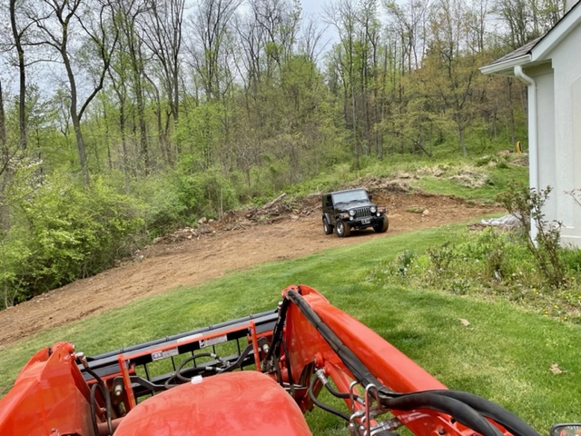

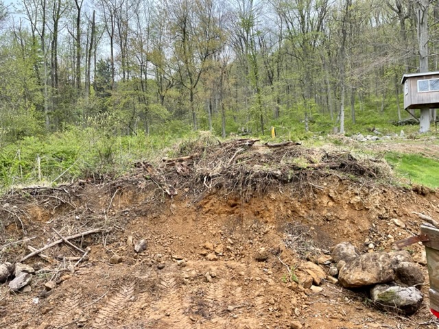

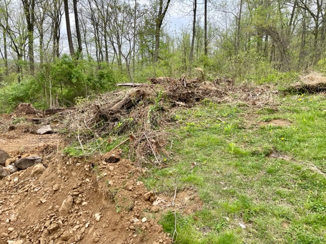

I have been continuing the brushwork part on a project this week and was hoping the grapple would do it better but I have not had good success in my case. My LP grapple is great at picking up piles and the tree work I mostly use it for, but I have too many sunken boulders to push it ripping roots in this area...
I have had easier & cleaner success using the BH to pull everything fanning out within reach and make piles. Once I had a bunch of these, I used the grapple to quickly load the trailer (behind Jeep - 4'x8'x3') in heaping loads to dump. There are a lot of big & little stumps mixed in with the regrowth brush as I have been planning this for a while :cool:

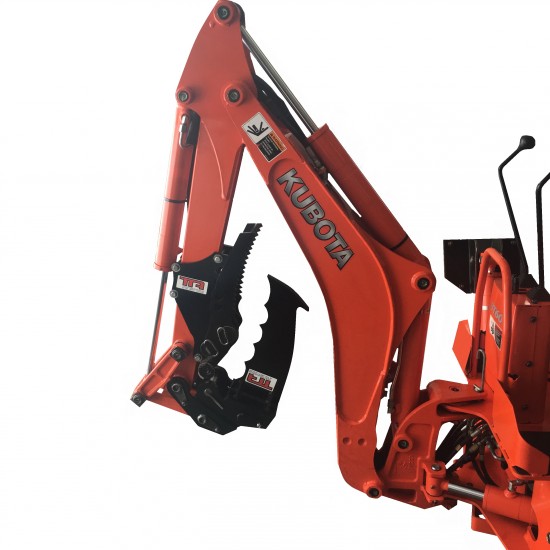

Rent one of these, you won't want to do it any other way after
