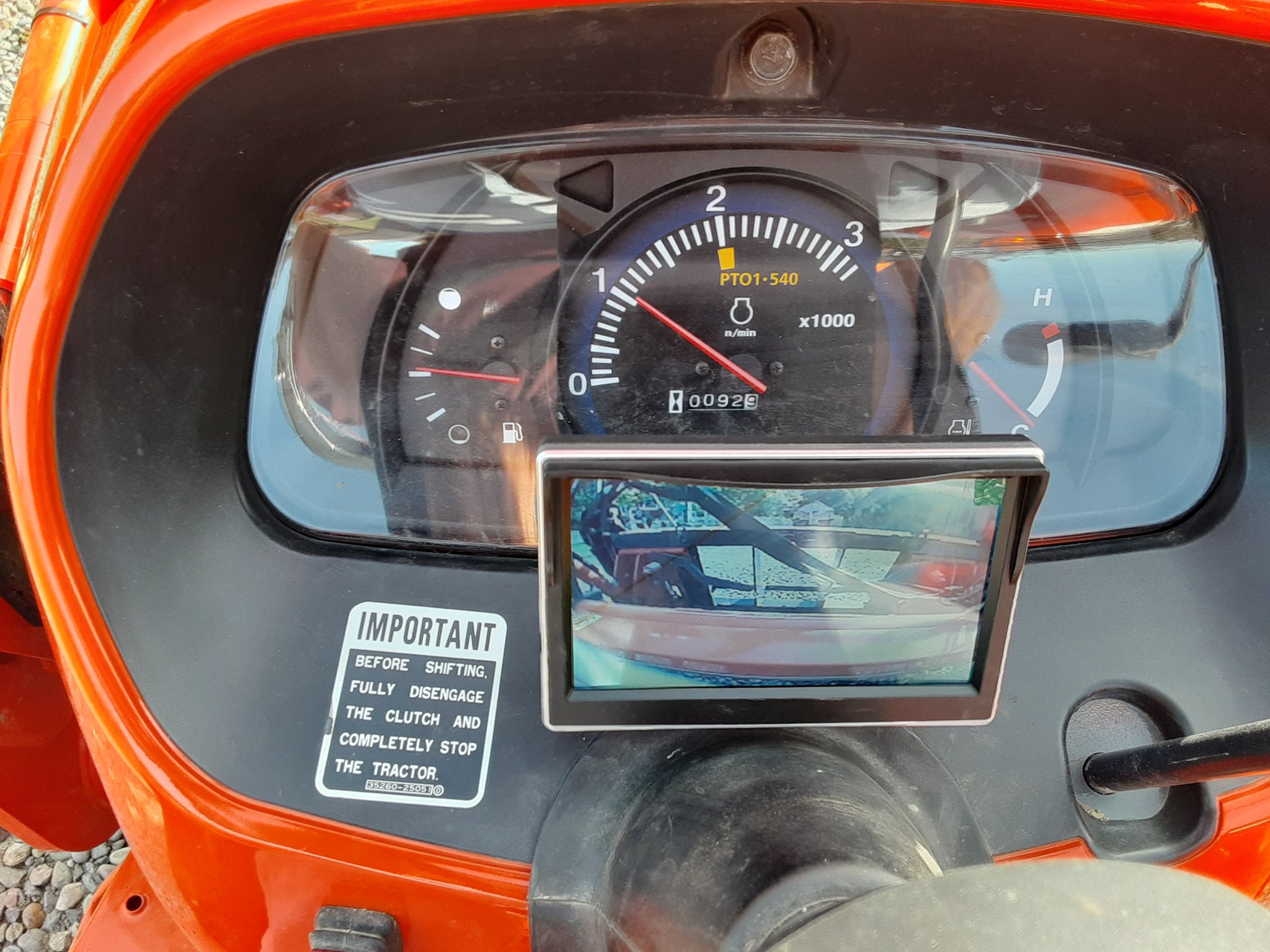

I have a wired one on my kubota and the camera is mounted in my brush guard. my screen is mounted by the steering wheel and while in bright sunlight it is not great I can see the forks somewhat better. Some of the wired ones have 2 wires with a loop of each, one white and one green sticking out of the wire assembly. You can cut one them to reverse the image so it is what you want going forward and one eliminates the colored guide lines. These were inexpensive ebay setups.

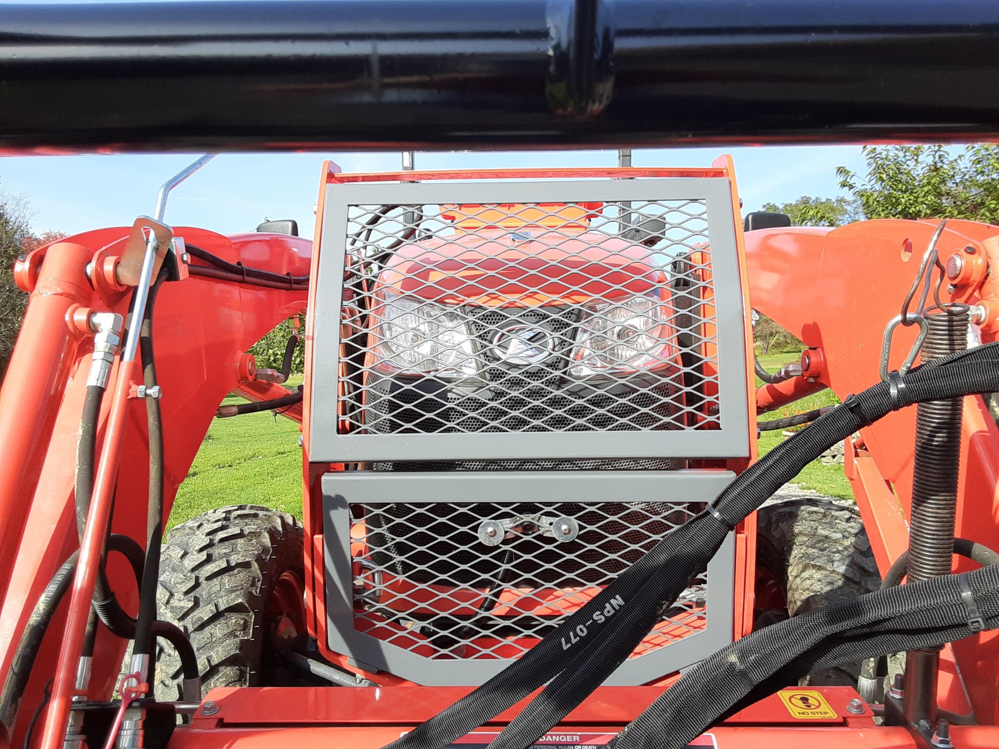

It is probably the smallest screen maybe 4-5 diagonal. I wanted to try the idea before spending money on a better one. The camera isn't anything like the ones in the video linked. I think the camera is about 3/4" in diameter and I mounted on a piece of strap so I could move it around on my guard. I figured too it could get wasted by a branch in the woods. The camera is in the lower guard here.
Bill
View attachment 96315 View attachment 96316
Thanks, I appreciate the ideas. Is the screen mounted with velcro?
No I mounted it with a couple screws in the black area between the rubber on the steering column and the dash plastic, it just fit. I didn't want to use the sticky stuff because it wiggles quite a bit with the vibration.
