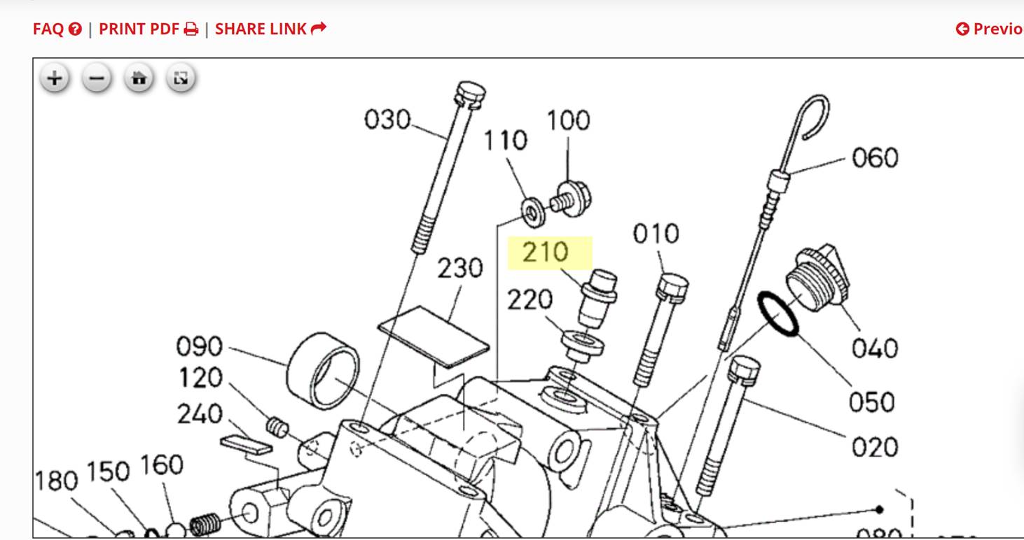

I thought you were supposed to check it hot. Good to know. And good to know about equipment being on the ground. Now, do I have to use Kubota's hst fluid, or can I use something I can get locally?
the dealer told me there's a breather- shaped like a horseshoe- just a piece of rubber hose, right near the fill and dipstick, but I don't see it for the life of me.
Thanks

There is a Breather and it is PN: K2561-36330
It can be seen in the attached drawing. Item 210
Both my Grand L's have the horseshoe shaped breather.
Hope this helps.

Breather on a BX is on top of the three-point cover right over the rock shaft. It is a small red plastic cap about 1/4" - 3/8" in diameter. You do not have the curved hose breather.
