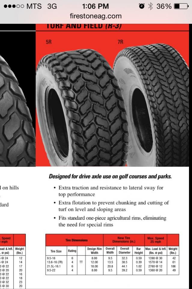

The manual states for the L185T (turf tire I think)
Rear 20x8-10
Front 13.6-16

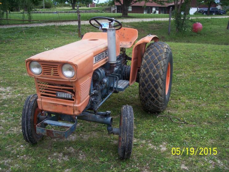

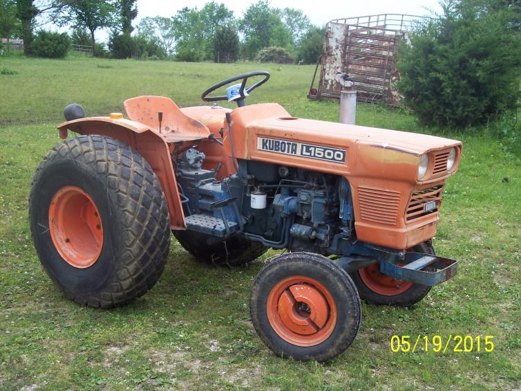

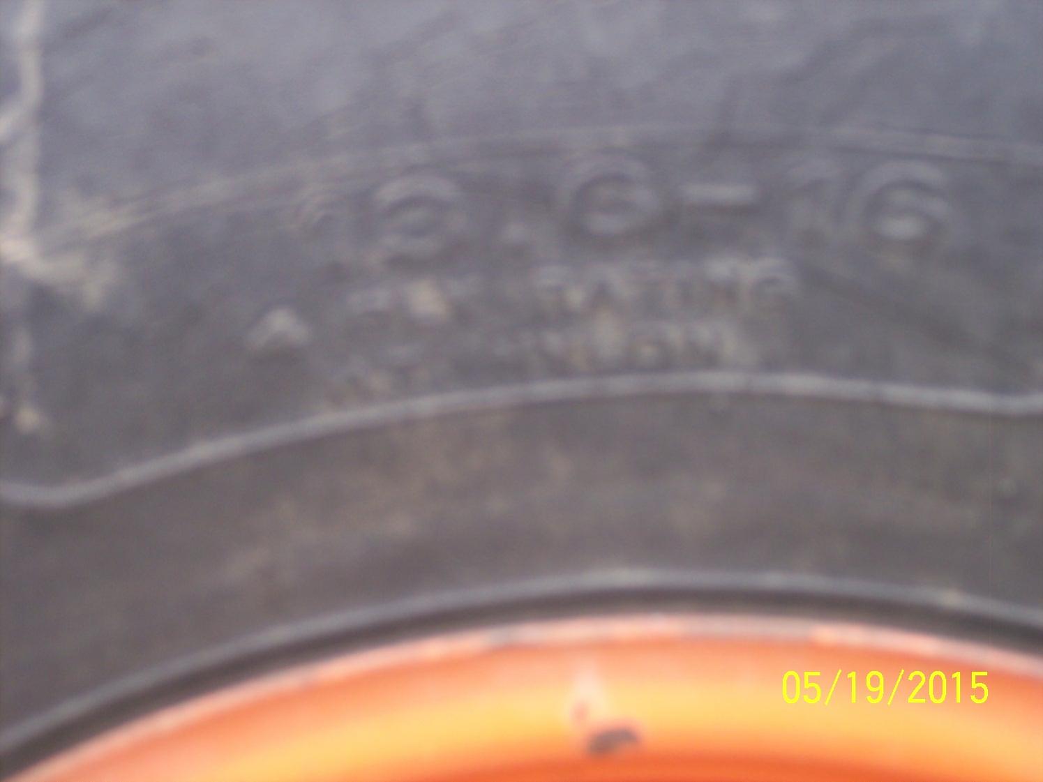

Daren, here's some pictures. Fronts are 4.00x12. Rears are 13.6x16. I bought the rears from a guy who removed them from a B8200. They stand about 38" high. Look nice on the L1500, I think. Please overlook my steering wheel center cap and fancy seat!!
