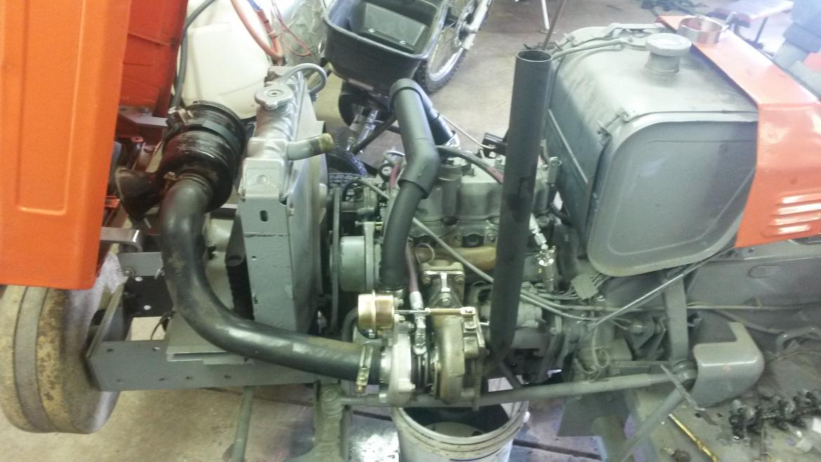

Hello all this is my first post. I just with wanted to share my project with you. Im sure some may totally disagree with this and thats fine, but figured others may find it intresting.
I started with a kubota b8200 that was running driving had working hydrolics and and thats abt it i picked it up in the 600 dollar range.
Check the pictures out in my profile

This is currently running and operational pulling my mower deck it runs amazing at 6psi of boost with no fueling changes.

I spend 150.00 for a used turbo .15/.15 ratio t3 style flang
30.00 for the turbo overhaul parts (didnt need it but did it for peace of mind)
40.00 on 2 hydrolic lines and jic fittings which I used for oil lines
every thing else I fabed myself or had laying around the shop
So like 220/230 if you wana figure in some gas money
well it runs night and day differently I do not have any dyno figure it all seat of the pant and use of tractor it dose things with easy it was unable to do befor is what I based my opinion off of

I will say looks like you did a very nice and clean install with it.;)

Thank you... I do wish I had some accurate befor and after dyno numbers but didnt have that equipment available to be... it is registering boost on the gauge... its a 25mm inlet btw

The EGT was measuring 930-950 at 2500 rpm I was using an IR gun taking temp before the turbo a payro install is next on the list and still currently waiting for delivery
not sure how far off surface temp with ir gun will be compared to internal temp but I wouldnt think its going to be to drastic curious to see myself

I think you're going to find a pretty big difference between the pyro temps and IR temps. My Duramax running at about 30psi of boost will hit over 1350 deg on the pyro....if you didn't change the fueling on the Kubota, I'm thinking you might be a little lean? Not sure how diesels work compared to gas when it comes to boost, but I thought you needed to add fuel where you add boost or you risk running lean/hot and melting something.
As far as hp...I respect wolfman because he really seems to know his stuff....but usually turbos add significant power to both gas and diesel motors. 2 hp on a 19hp motor? I would be expecting more like 5+hp from a turbo and the real difference would be a major jump in torque.
What would you charge to make up another manifold to turbo flange? I have a B9200 and I'd be interested in buying that so I could do my own turbo setup.
As far as longevity of the motor as some people have asked....we all know Kubota's are well overbuilt. And we all know they add on turbos to some models with little or no mods to the motor itself other than fueling. Examples are the RTV's and the larger M series tractors which are offered in both turbo and non turbo models. I wouldn't hesitate at all to put a turbo with a Pyro on my 25+ yr old B9200 and let er rip. The only point for me is that I seem to have plenty of hp with everything I do with it....except maybe climbing a hill in high range....so do I REALLY need the power? ;)

I agree id like to have hard data myself.... what brought this project on was first and for most FUN lol just because I can. But I was having some issue with up hill power while mowing.... bogging exsessive smoke and even a stall out once on a steeper part of a hill.... ended up shorlty after with a valve tap..... long story short I ended up rebuilding my head I installed new guides valves and springs tappet s and push rods..... ran it after that for a few weeks and it was a whole new tractor.... not satisfied with that major improvement I proceed with the turbo.... I can now scalp 2-3 foot grass off with a finish mower up hill no bogging no excessive smoke no end in site with the throttle set at 2400 rpm.... it will do this with the pto set a 540 or 720.... im not sure what the appropriate pto setting is if anyone could share info id love feed back... but seems to kick grass better in 720

And I sure would like to see some pictures of the plumbing too
14,972
4,031
I saw that Mag I was talking about the oil lines and such;)

Looks like he has an oil cooler on the front, which is needed for a turbo.
With that large crossover, there might be space in there for an intercooler and with louvering the hood and electric fans, you might sneak another HP or two out of it, also lowering your EGT in the process and making your engine run cooler as well as more efficiently.
You aren't looking for HP gains in a diesel anyway, you are looking for torque gains. Your HP tends to only go up slightly with a diesel turbo, but your torque goes up amazingly.
By the way, you will need to adjust your fuel feed to work optimally with the turbocharger if you haven't already done so. With more air now the need to increase the fuel to bring the stoichiometric ratio back into balance or heat will melt your cylinders down with a lean mix. Watched a buddy do a turbo on a gas engine and did exactly that...

I would agree 100% about increasing fueling rate, 900-950 is to hot, a Pyrometer probe straped to the exhaust manifold will tell you where you're at with heat soak, doesn't have to be in exhaust stream.
Doubling the oil capacity and a good size oil cooler would be prudent.
Charge air cooler wouldn't hurt.
I was thinking about doing something like this with junkyard parts. Sizing the turbo to the engine displacement is critical if it's going to last.
