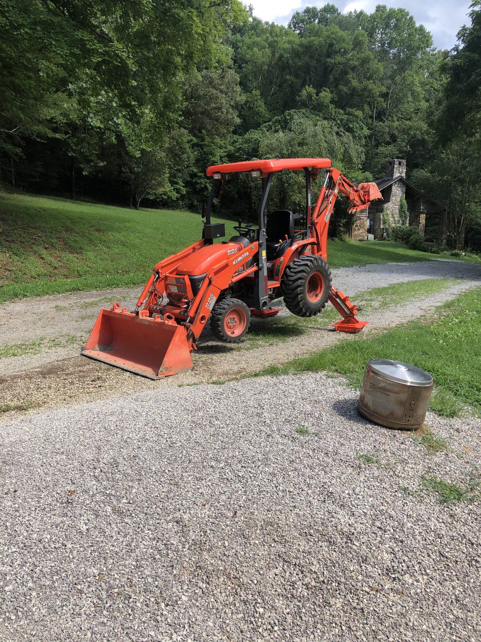

True TLB's like M62's, L47's, B26's, and the older M59's, L48's, L39's, L35's, etc. are Swiss Army knives in comparison.
For my personal use, I know that I would never trade my L48 TLB for a Mini-Ex, and I DO have another tractor loader as well.
