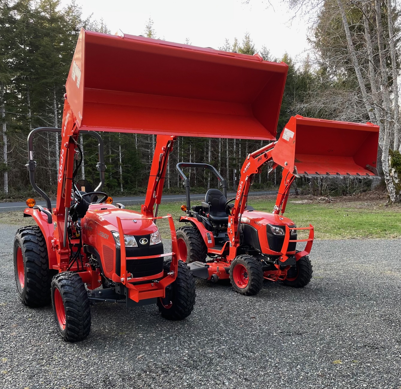

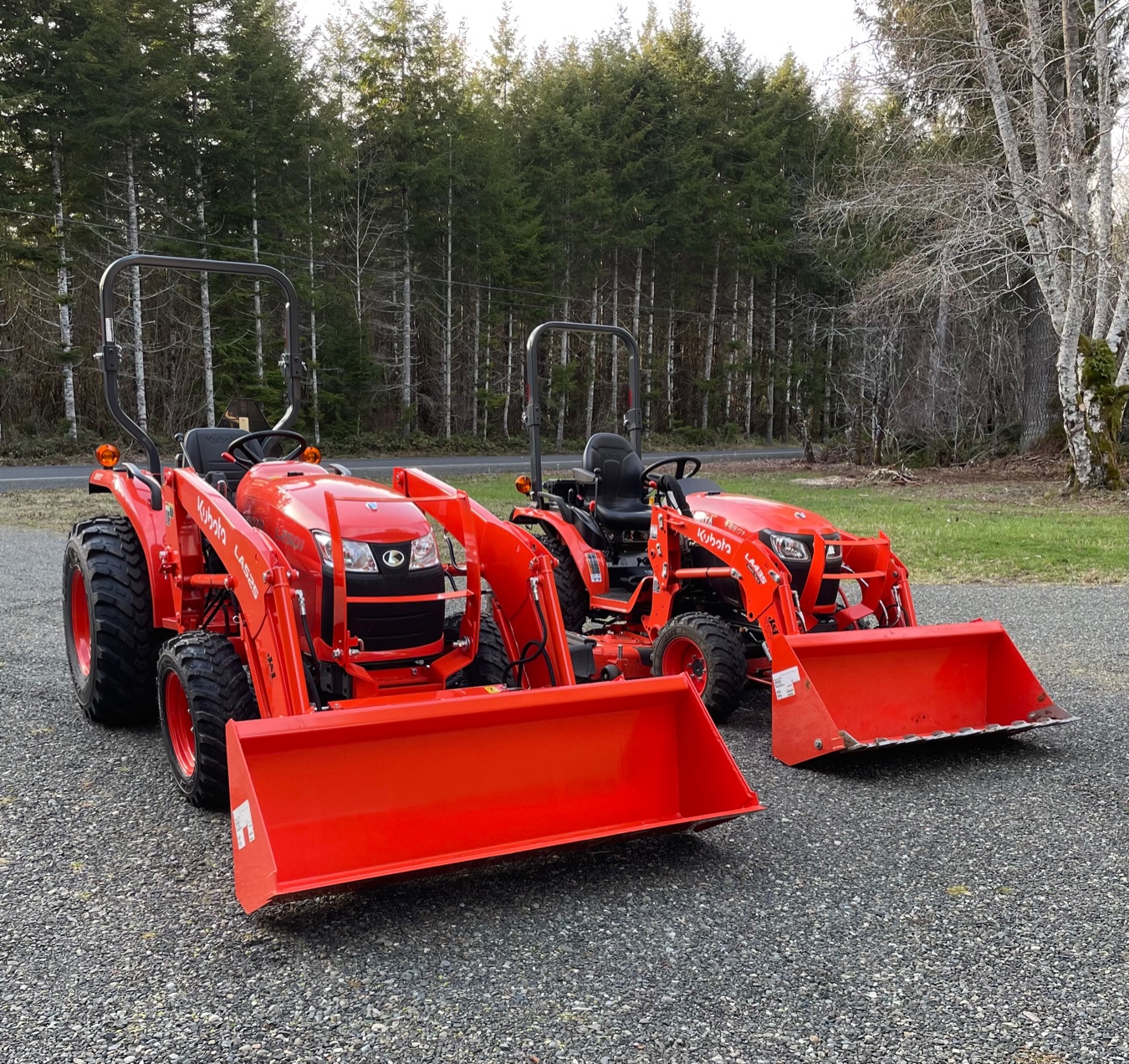

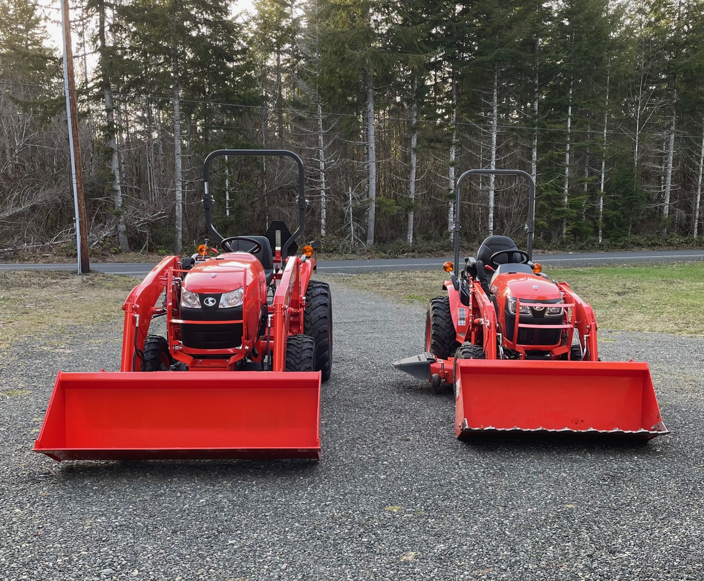

First off, the B2601 is a great tractor! I was seriously surprised with the amount of work I was able to accomplish with that tractor! I will now and continue to recommend it to neighbors, friends, coworkers and forum members.
However, speaking from my personal experience working on my property, Yes! The L2501 / L2502 is a worthwhile upgrade from the B2601 and one I would recommend and seriously consider.
Here are the two beasts together!
I use my tractor to grade and level land, till dirt, move dirt, move brush, skid logs, transport trees and logs, make trails through the forest, maintain our gravel driveway, remove stumps, run a PTO powered wood chipper and to load and unload miscellaneous materials and products from delivery trucks.
The B2601 simply lacked the lift capacity, the size and the weight required for removing medium to large stumps, carrying logs, carrying stumps and the heavy ground engagement work that is needed on my property. The L2501, has been able to perform all the tasks the B2601 struggled with, or could not accomplish, in addition to getting the work done quicker.
Depending on expectations and the tasks the OP has planned, the L2501 / L2502 could be a very worthwhile upgrade.
Mike
That is exactly the kind of post I was hoping to see BEFORE I has to let go of the idea to upgrade because of the price difference. šŸ˜‚.
It's nice to see them side by side. The difference is real.

Here's one more for you;
IMG_3655.jpg There's certainly a difference in size, weight and capacity between the two tractors.
Mike
