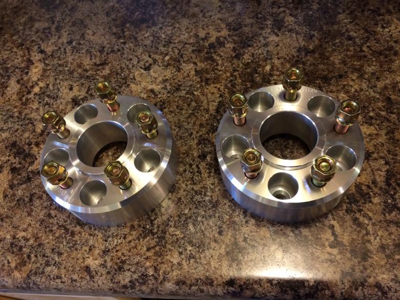

Figured I'd post an update....I've not had any issues with the 3" spacers from Motorports-Tech at all. However, we recently had a lot of dozer work done and this spring I'll have a TON of slope mowing to do and while I haven't been on it yet (trying to get the young grass established) from eyeballing it looks like some of the slopes are a lot steeper than I've been mowing (20-25*), so I've added wheel weights as well as stepped up to 5" wheel spacers from same vendor.
I've had them on a little over a week but haven't mowed since. Will mow today and try the combo of them and the weights out on the slopes.
My TnT setup allowed the RH QH handle to get up into the tail light and busted it. I removed them both to keep from happening again. Yea, it looks BAD, but I am going to make a cap plate and mount in their place to tidy the tail up a little.
I will admit that I was a little concerned going to 5", but replacing wheel bearings would be a whole lot cheaper than a tractor roll over or a funeral :(
Pic of "before" with 3" wheel spacers, R1's set all the way out.
First new 5" spacer on.
Both new spacers installed. It's 72" from outside edge of tread (not sidewall).

she's spread wider than a prostitute looking at $100 bill! :eek: --- now that was terrible - I should not have said that !!! I bet it will take the pucker factor right out of sideways mowing!!!
