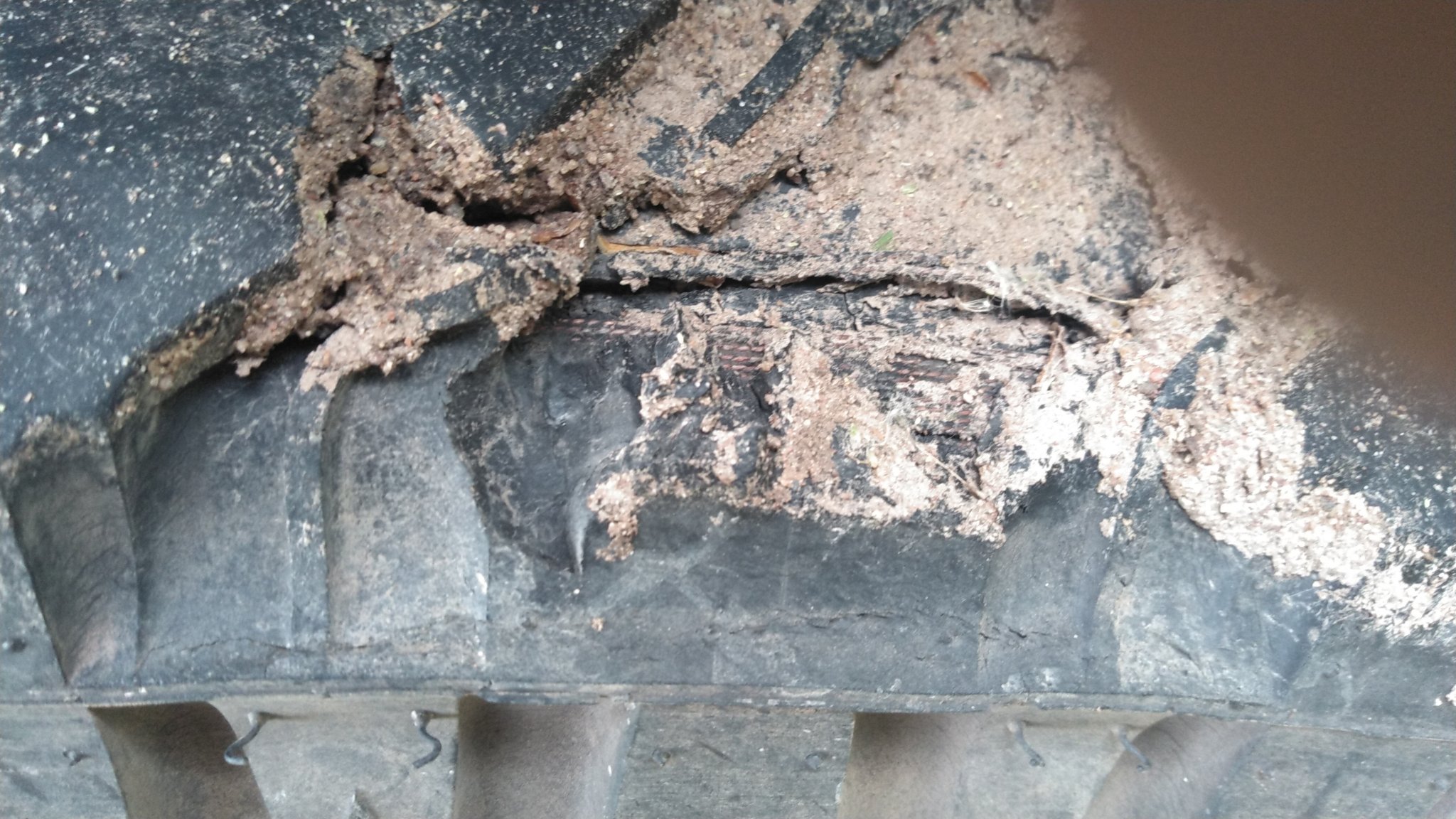

Yep. I put 35" Nitto Trail Grappler M/T on in 2017 right after buying the truck. Tire tread to tire case seperation at 33,000 miles. Only on one tire. Didn't trust driving it so went to put on the spare. That was a no-go.
Fortunately I bought 5 aftermarket wheels. Left one in storage. Now I have to buy a spare tire as my factory spare is 17" and aftermarket wheels are 18".
Anyway. Check your spare usability. If I'd have been in the dark alongside a hiway somewhere, it could have been ugly.

Not to start a pissing match, but that looks like impact damage from the pics, that’s not just tread separation.

It's all good. If you look at the outer tread on the one picture that shows more of the tire you'll see tread seperation along the edge in several places.
I could literally lift the tread away from the casing at several places.
I don't fault the tires, as they have been great tired and are past warranty. And they didn't blow apart.
I heard a flapping noise before I saw the problem, and I stopped twice to check the tires once I heard it. And everytime I checked, the missing tire tread and the raised section was side down. I only finally noticed it when I got to my destination.
I did go with another brand to replace them. And I'd still recommend Nitto or Toyo tires.
I did, but it’s all good! What did you go with? I rungeneral grabbers on my SD have been happy with them.
