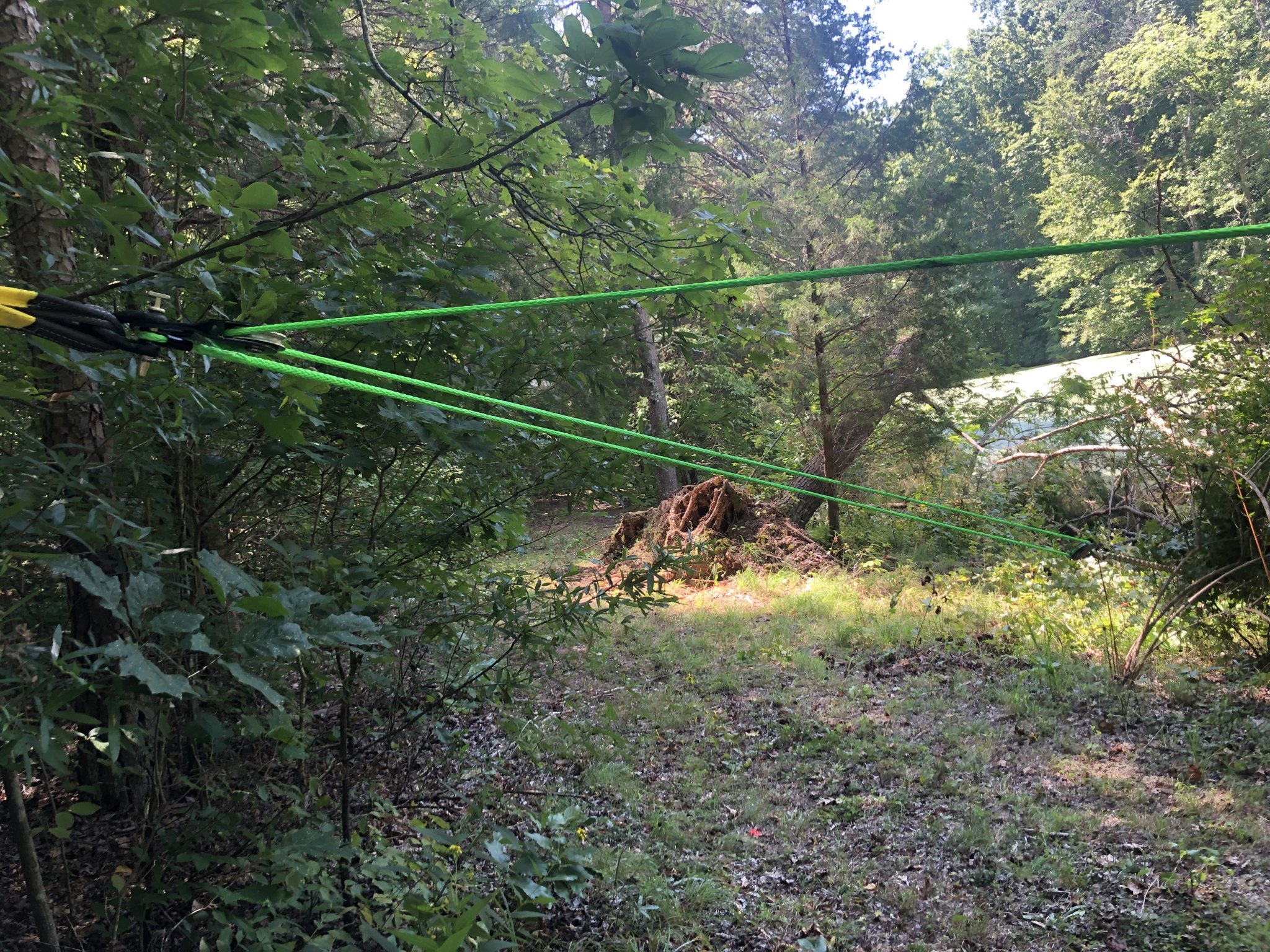

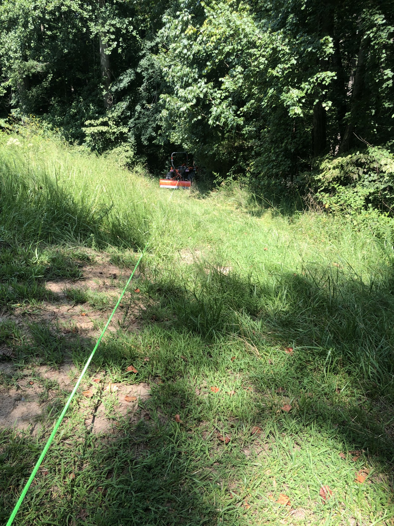

I use Sterling Atlas 5/8 rigging line. Very little stretch but limber enough to tie knots easily. 19,000 lb breaking strength and very easy to work with. I can use it in my 5:1mechanical advantage pulleys one of which has progress capture. I set up the pulley’s, anchor to the tree and a stump or other adequate anchor point and pull by hand or with the tractor. I put line thimbles on the ends when needed and hook up with heavy carabiners or shackles to avoid over-stressing the line at connection points. I use snatch blocks when I need to redirect a line.
Putting the mechanical advantage together (two double sheave pulleys) is probably one of the best investments I’ve made for falling trees in tight places And giving me the right amount of tension.

Just a tip if you are using rope under high tension…. When you are rigged up , either get a real line dampener or get a pair of ankle weights and put them around the the line on the end that will be coming at you if a line fails. The dampener will push the line to the ground instead of the line being a bull whip coming at you. Should be part of every rigging kit.
