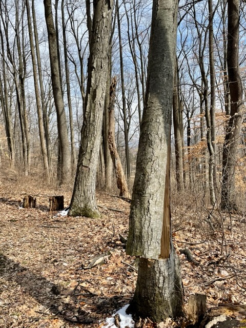

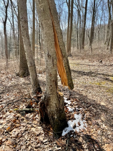

View attachment 76986 View attachment 76987 View attachment 76990
One thing that comes to mind looking at those split trunks: If dealing with a heavy leaner, lightning struck, or hollow where a split like that is anticipated as a potential problem, consider wrapping the trunk with a stout chain and tightening with a load binder to prevent trunk splitting. Have done that several times with 3/8” grade 70 chains and appropriately matched load binder.

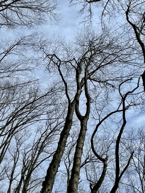

Thanks for the info and a winch is a great addition in those instances. Here I decided to use power (tractor) after conventional methods proved dangerous, be out of the fall zone (needed long line).
Additional info: I left this one for a few months with up to 50+ mph winds and seriously hoping mother nature would do the job. Not a chance, as it turned out to only be slightly rotten low in the outer ring section. The rest of the tree was solid and firmly intertwined up top. It is next to a campsite and wanted to save the other tree and I am trying to preserve the diversity and like the cherries :)
Hindsite & lessons learned:
  1. I should have bound it after Plan A where I got it pulled straight back up & unstuck with the rope puller, then tied it off and gone to conventional methods with the saw & felling. I guess I had the tractor and wanted to "use it"
  2. I have to upgrade my line "arsenal" and get a snatch block for direction at least... Thus the post/survey here.
