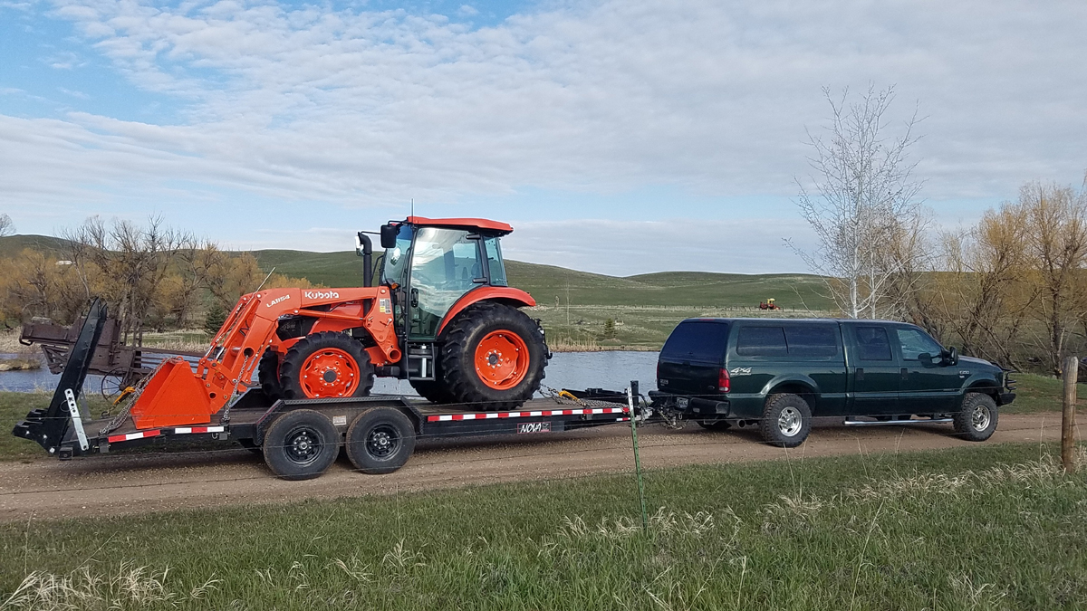

I just did that this past Monday pulling an 11,000 lb trailer from Sheridan, WY to Kalispell, MT. It took me 9-1/2 hours with one stop for fuel, and to let the dogs out to pee. The toughest section was the 6% grade out of Missoula that's something like 4 miles long. I was only able to maintain 55mph with my foot to the floor and in 3rd gear.
That pic really shows how big that bad boy is!
My B6000 would fit in that scoop!
Don't blame that one stop on the dogs!! ;)
Just curious, it's there a reason you backed the tractor onto the trailer?
I'm hauling a similar load shortly.
Two reasons. Firstly, if a stone flies up and brakes the glass, it's a lot cheaper and easier to replace the rear window than the front. Secondly, with the weight distribution of the tractor the tongue weight is easier to set up and adjust vs. driving on forwards.
I went past Belgrade on my way home.
Oh, and HST tractors are a lot easier to back onto a trailer compared to geared tractors. At least that's my experience.
