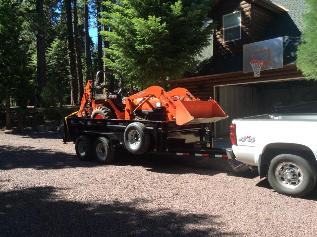

I have a 3/4 ton Chevy HD...and tow a 14,000lbs rated dump trailer with my L2800. I bought a tongue scale to adjust my weight distribution hitch...and the trailer position of the tractor with implements.
Tows great, stable and with electric brakes...feels safe.
However, in high elevation over a pass...I paid a buddy with a huge dually diesel Ram to tow it so I didn’t fry my tranny for that one haul in 100 plus degrees.
I like having large margins of safety with that much weight...
