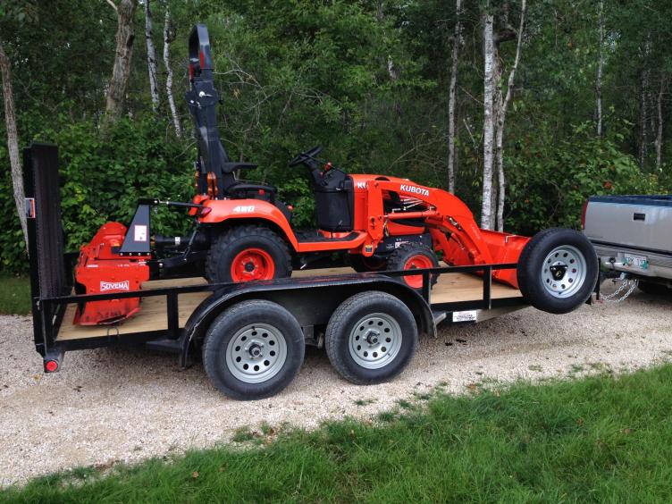

I picked up a 14' double axle trailer to haul my bx2370. I wanted a 16' but one was not available until October. I might actually trade this one in for a 16' when ones available, just to have the extra room on the trailer. Here's a picture of the tractor on my 14'
I would look for a 16' as it will give you more flexibility down the road.
Good luck!

Glenn,
that fits nicely ....I agree that extra 2' makes life a little easier for other goodies!
Ever notice that a few inches forward or a few back change the dynamics of the hauling? On my 14' - I can feel that slight difference pulling it if I am smidge too much forward or not forward enough!:)
