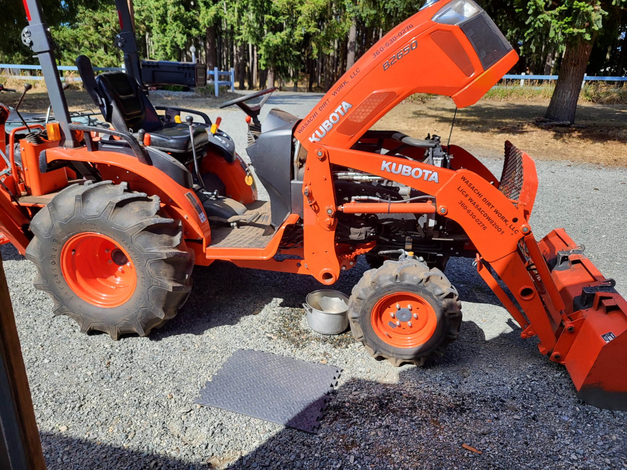

UPDATE:
Turned out to be a partial obstruction at the fuel filter feed line......
10 min fix.....
Back to work for me!
fj40dave
Sep 24, 2009
425
257
Yelm, WA
UPDATE:
10 min fix.....

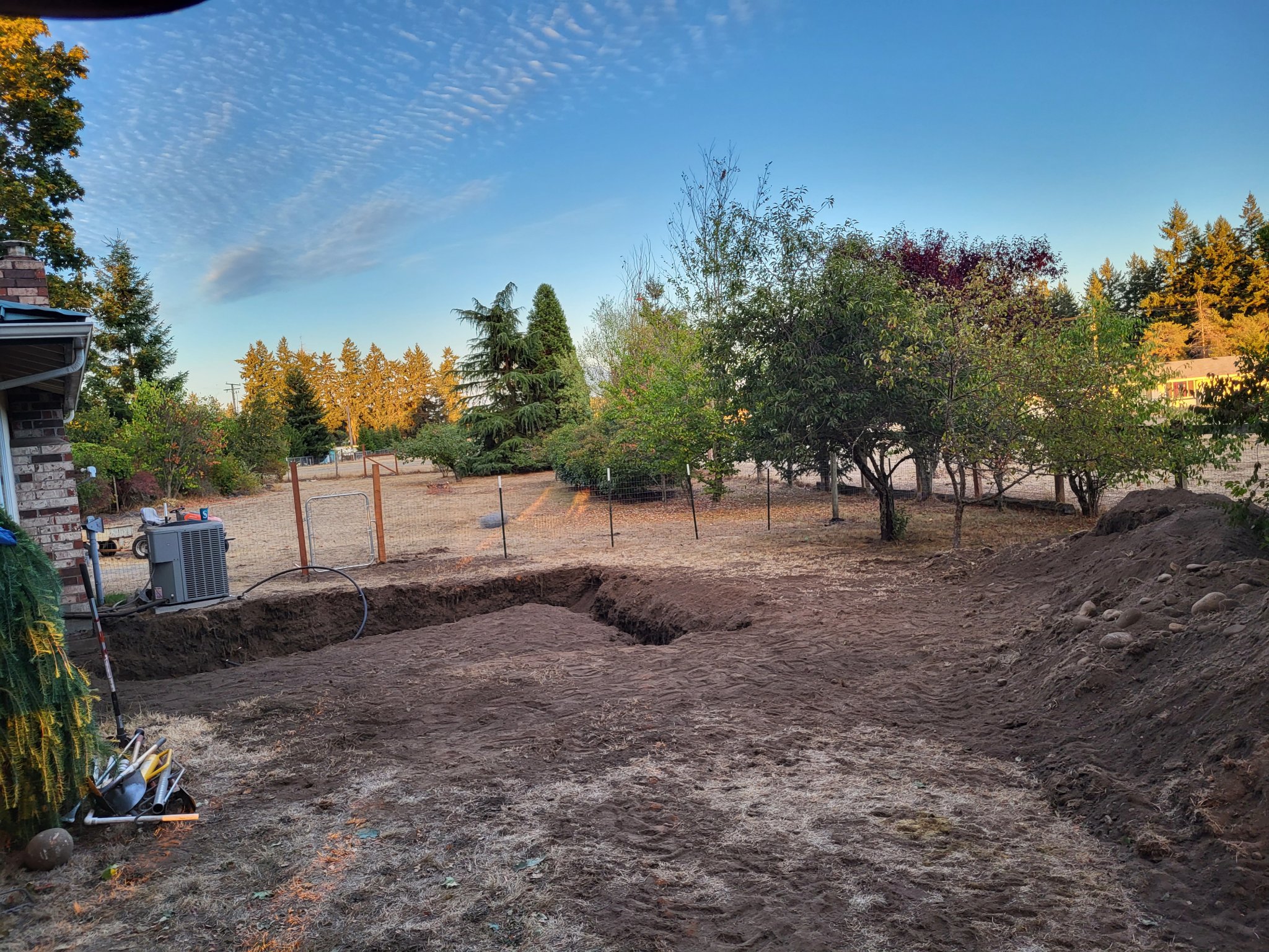

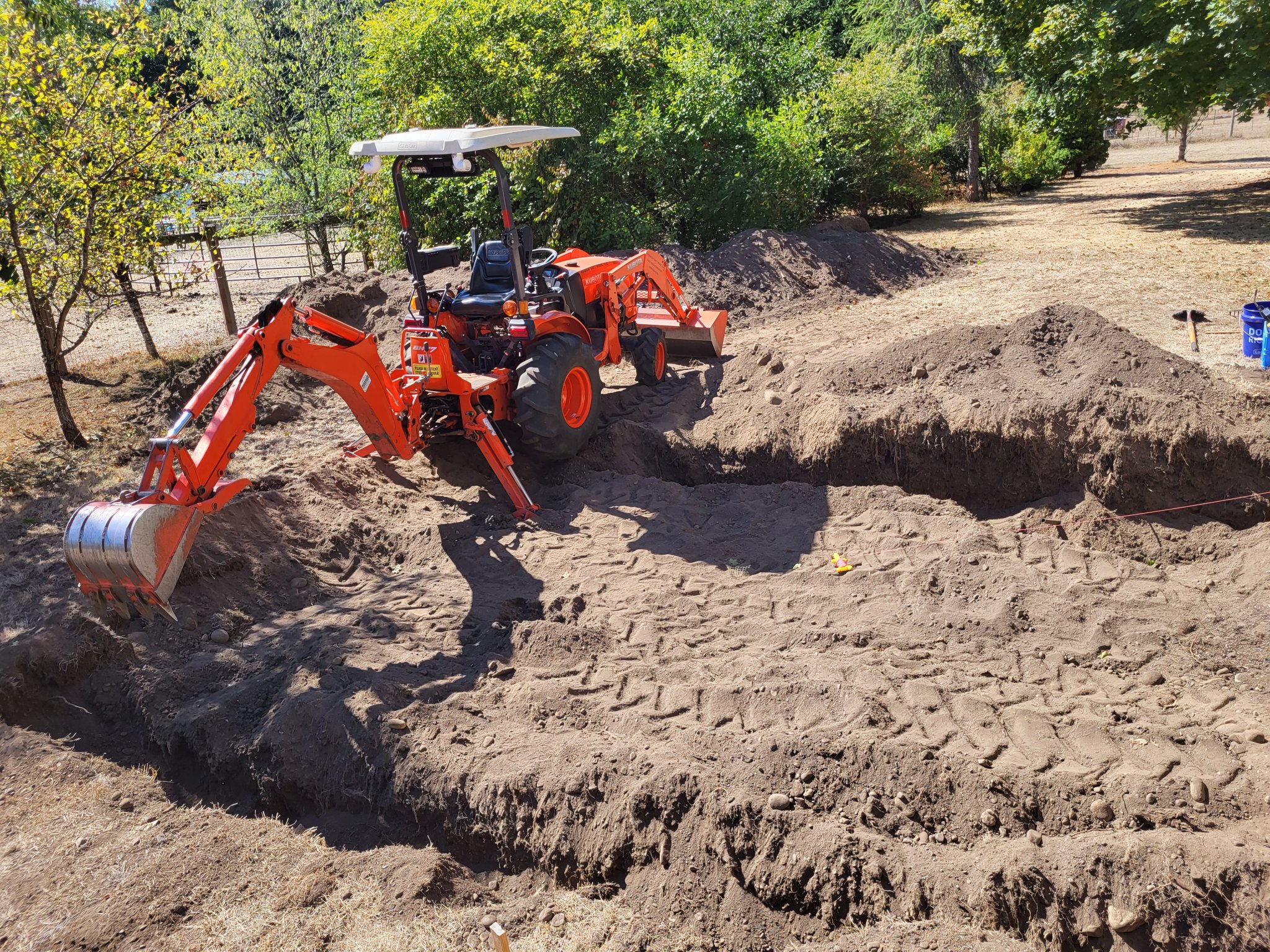

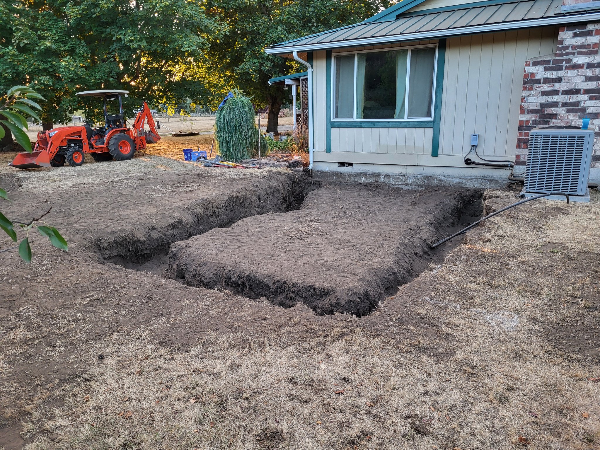

Got the addition foundation dig-out done after my little fuel filter issue this afternoon. :)
