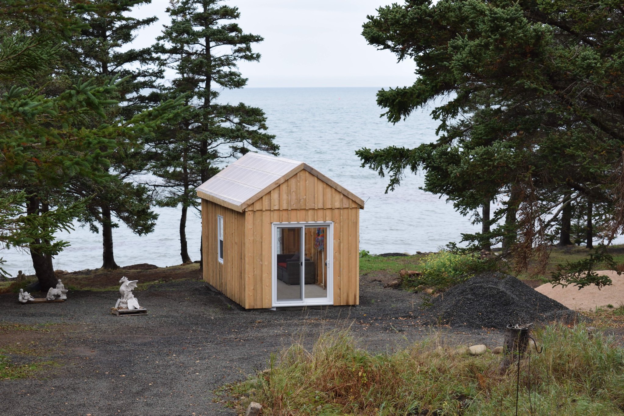

I have a quick question on roof trusses I am building for the small shed so the span is 9 ft wall to wall and 10 ft overall. I am building the truss in the picture but realized that most of the pics show the top chord passing by the bottom chord and I started and would prefer to leave the bottom chord pass by the top chords. like in this picture. I will use strapping and hurricane braces. the building will have strong wind pressure and some snow. I am using clear plastic panels for a roof. 24 inch trusses with 24" strapping

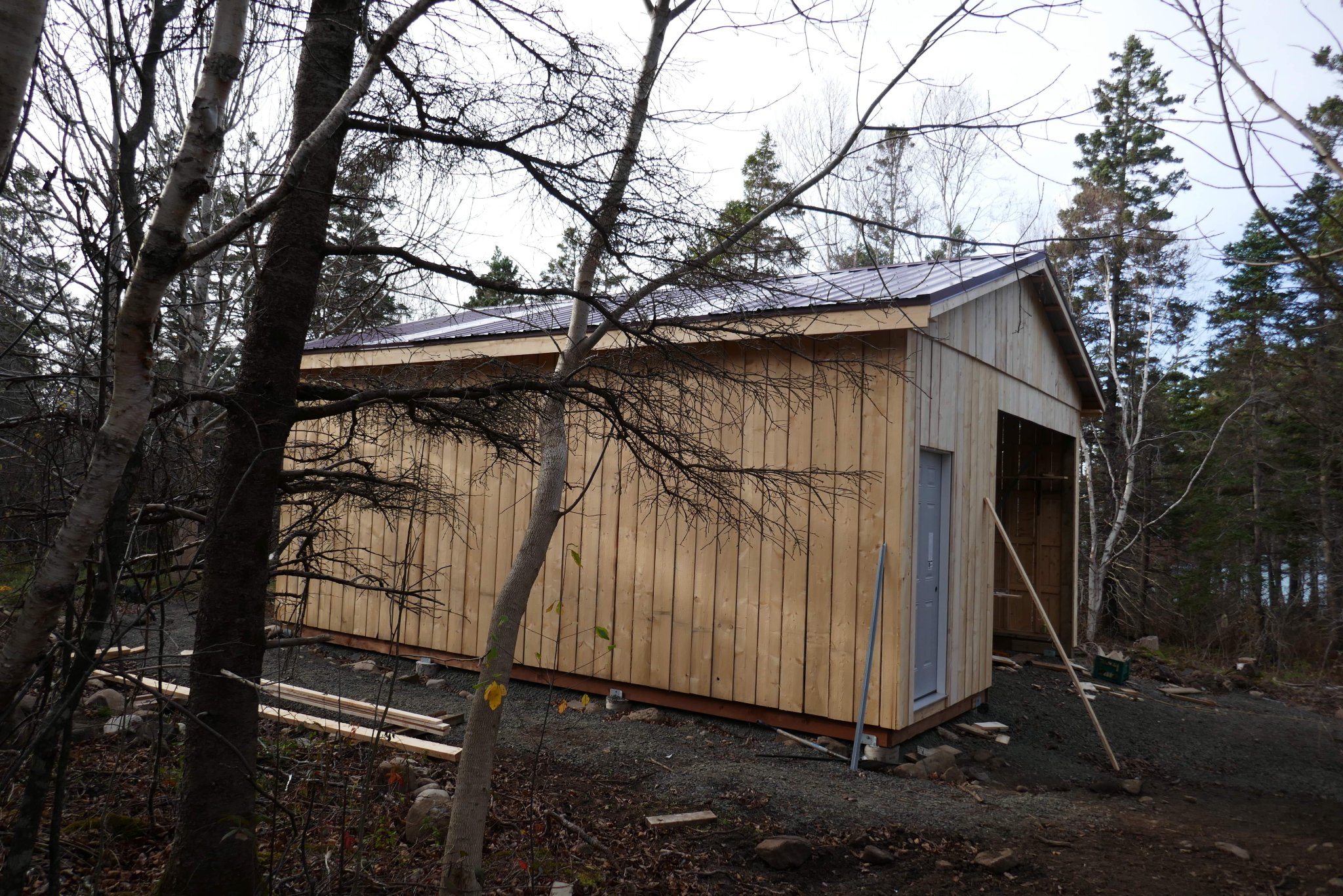

Update -I still have to put up the battens and the sliding door to build but the cost of the building is done overall. the 20 x24 ft building cost just over 11000.00 all in. The lumber with the exception of the trusses all came from within a mile of my property the trusses were purchased and took 4 1/2 months to get. I did put in two clear panels for the roof to get some light in the shed. I wish I had used the steel roof guy for the clear panels on the small shed. it would have saved quite a bit of money. DSC_0074_01.JPG DSC_0075_03.JPG DSC_0075_03.JPG P1000605.JPG I am including a picture of the small shed with clear plastic roof. Even with hiring an engineer (which was a great experience because I learned a lot from him) using rough local lumber saved a considerable amount of money

Update -I still have to put up the battens and the sliding door to build but the cost of the building is done overall. the 20 x24 ft building cost just over 11000.00 all in. The lumber with the exception of the trusses all came from within a mile of my property the trusses were purchased and took 4 1/2 months to get. I did put in two clear panels for the roof to get some light in the shed. I wish I had used the steel roof guy for the clear panels on the small shed. it would have saved quite a bit of money. View attachment 90702 View attachment 90703 View attachment 90703 View attachment 90704 I am including a picture of the small shed with clear plastic roof. Even with hiring an engineer (which was a great experience because I learned a lot from him) using rough local lumber saved a considerable amount of money

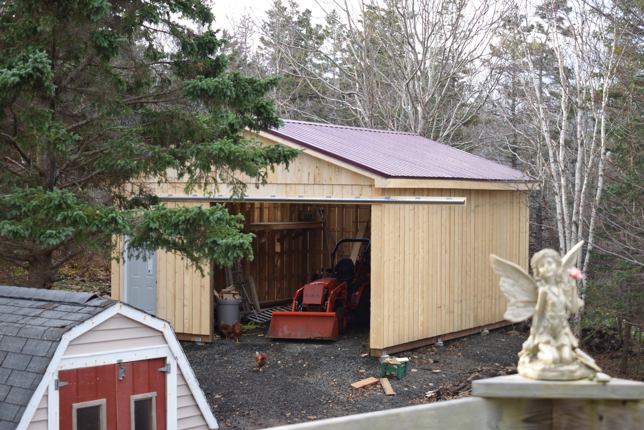

the county building inspector came out today and approved the building for final inspection. all that is left are the battens and door knobs. New home for my tractor and attachments. The van is back in the garage for the first time this year.

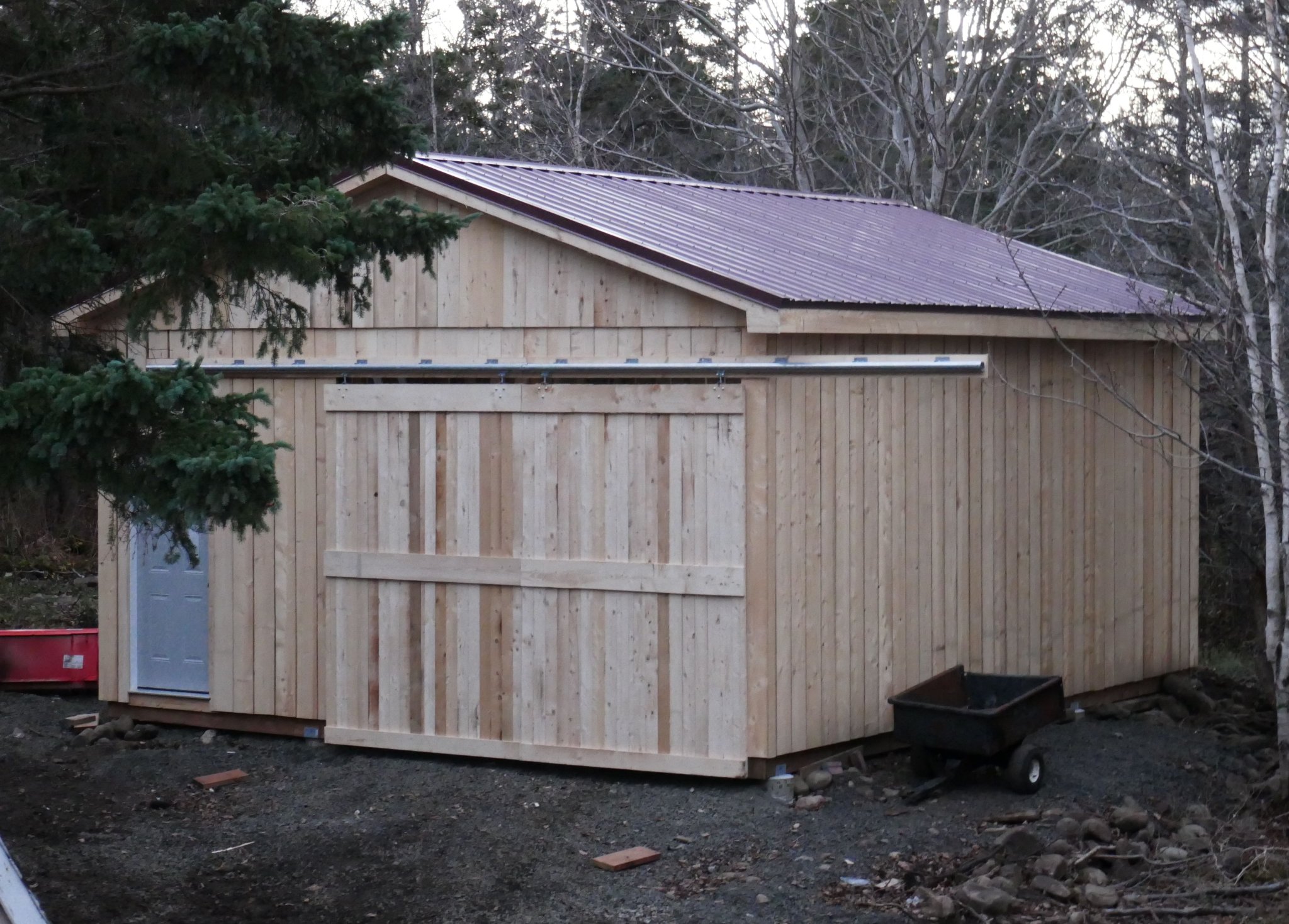

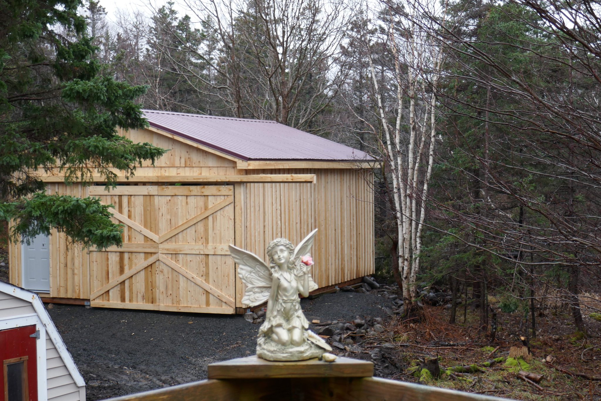

I had to hire an engineer to use the rough sawn lumber instead of store bought. The engineer designated big foots so I was able to use them with sonotubes instead of a footing. It gives me a gravel floor and because i leave my chains on year round the gravel floor is better than concrete for me. I was pretty new at using the backhoe but after clearing the stumps and leveling the building site and digging the 11 holes for the bigfoots I am much better with the backhoe so it was a good learning experience. Here is the last pic with the battens and the sliding door rail cover and the door bracing done. that will end it for this year.

Really nice shed. I have an old carriage house (shed for horse carriages) that im debating on refurb or teardown. Its all built from on property pine from the 1900’s. Just really low clearances. Current thought is a pole barn next to it for the tractor equip and refurb it as a small shop.
love the look of your shed.

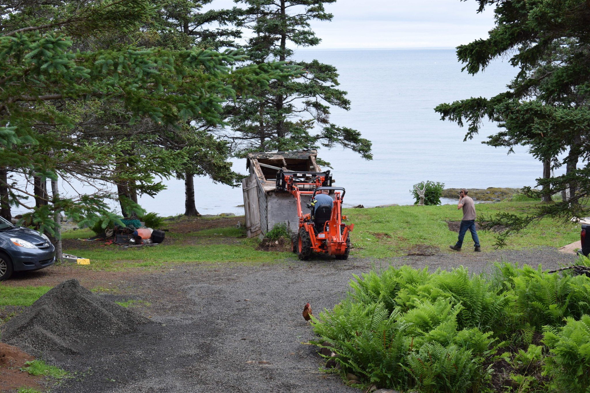

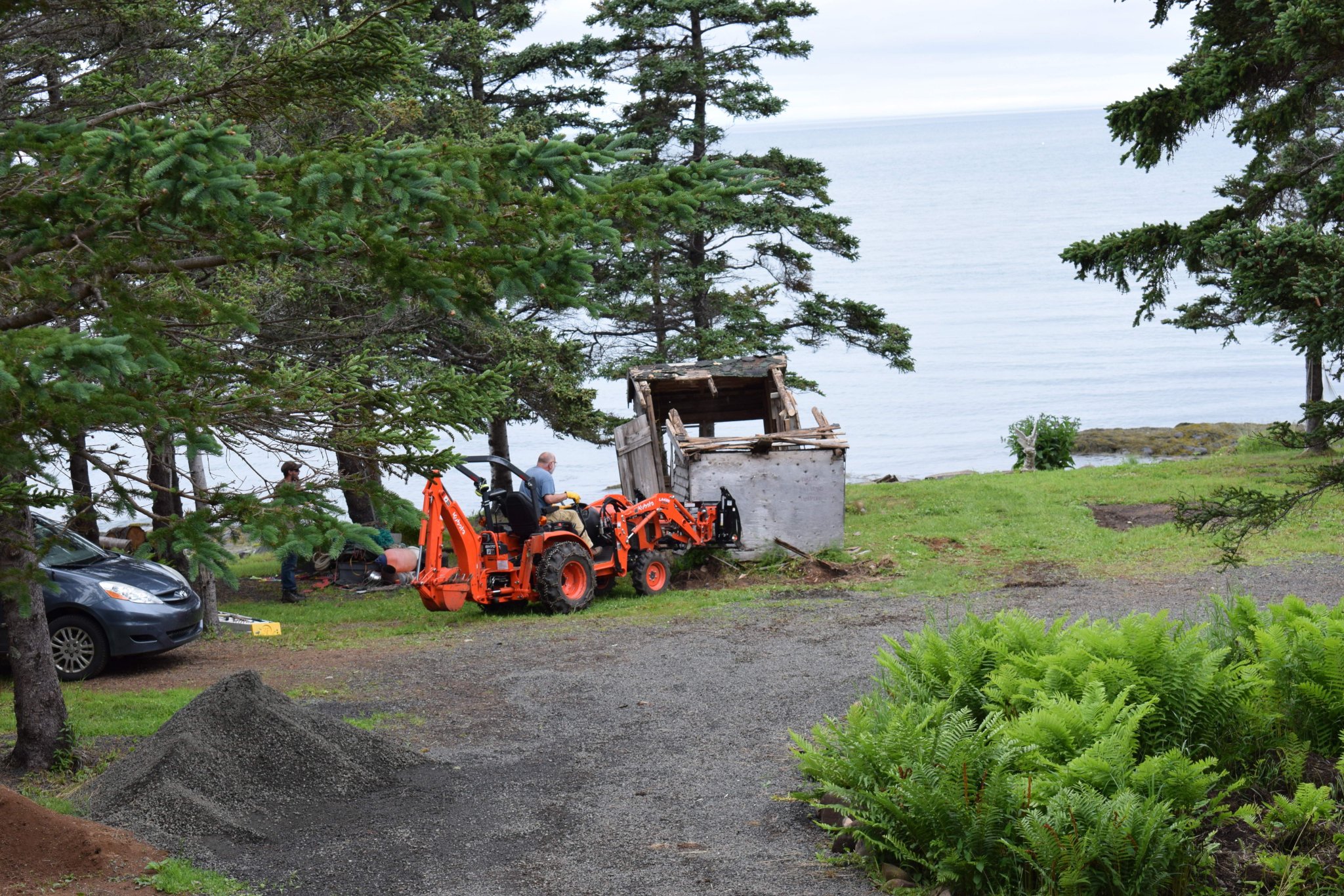

Thank you . I kind of had the same issue with the small shed I built in #22 above. The local guys built a camp in that spot when they were kids in the 1960s but it had a rotted wood floor and very low ceilings so I ended up tearing it down and building the new shed. It is a lot more functional now and mouse tite so better for storage. here is a pic of tearing the old shed down. They are changing the zoning here on ocean front property so we bit the bullet and made the improvements this year before the regulations came out. DSC_0071.JPG DSC_0073.JPG DSC_0073.JPG
