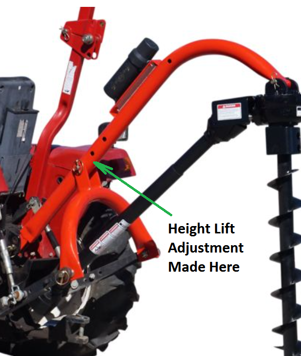

Pics would help. Surely there is a solution....but might entail modifying the attachment point on the auger arm.

For posterity sake.
The height adjustment is built into the main arm in some form. Glad you got it sorted out.

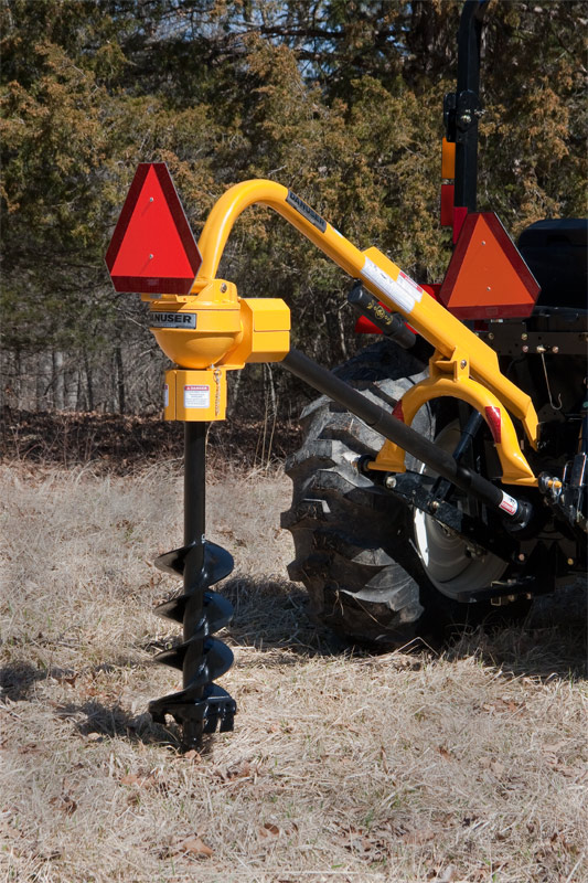

Flint - This is what I have https://www.danuser.com/attachments/auger-systems/pto/model-g2040
It does not have adjustment holes on the boom like the photo you posted, just a single hole.
Easily remedied. Weld another pivot point just behind the factory one if what you are doing now becomes unsatisfactory. Enjoy your auger and be careful with it.
Don't let anyone get near the auger itself. Been some horrible accidents over the years involving PHD's.
