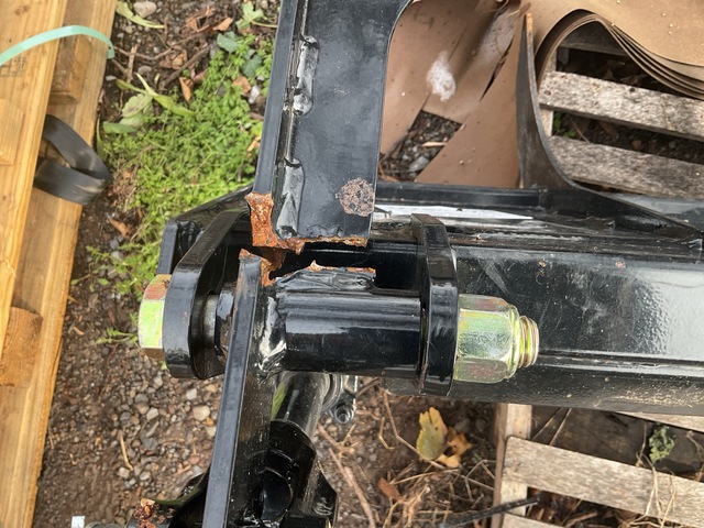

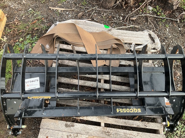

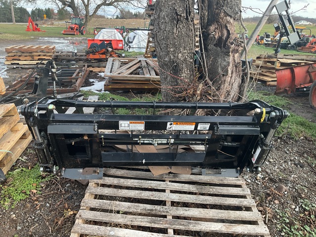

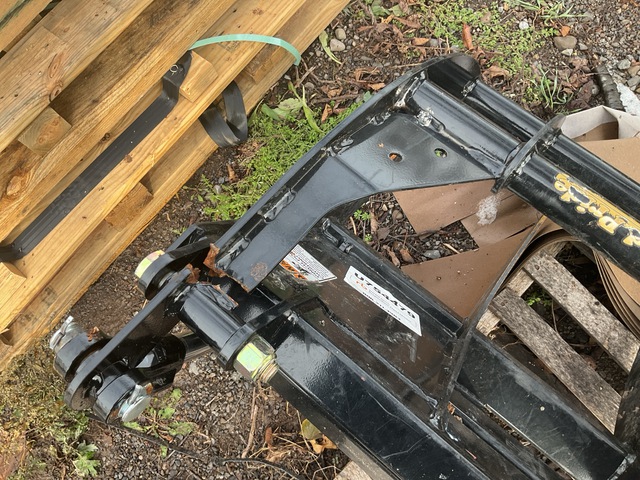

Time to bring this back to life. Below are the pictures of a LandPride Grapple that was used on a BX tractor. I can't decide if it was abuse or poor quality that killed this LandPride Grapple. What are your thoughts? I think that I might have to add some reinforcements to my LandPride Grapple.
Auction comments on damage: KTAC SALVAGE| Cause of Loss **Collision,- using the grapple to pick up a log and while doing so, the grapple snapped** LAND PRIDE SGC0554 /SERIAL #2038567
grapple 7.jpg grapple 6.jpg grapple 5.jpg grapple 4.jpg grapple 3.jpg grapple 2.jpg Grapple 1.jpg
BX23-S,57 A-C D-14,
13,957
6,353
My vote is probably bad design and poor welds. The failure is at the 'pivot' point of the arms, where straight steel and round steel are to become one.
I cant think of how operating the grapple could cause that damage. What I don't see is ANY grease let alone Zerks in the last picture. It is possible the 'tube' section was 'rust welded' to the shank of the bolt.
Ideally that 'tube' should be 3x thicker and have a Zerk.
One of those 'have to see it ,to tear it apart, to see why it failed.
3,724
6,996
Picking up a log may have been the last thing it did, but suspect raking with the lid had something to do with that. If not, just a design that relied too much on a bad weld.
