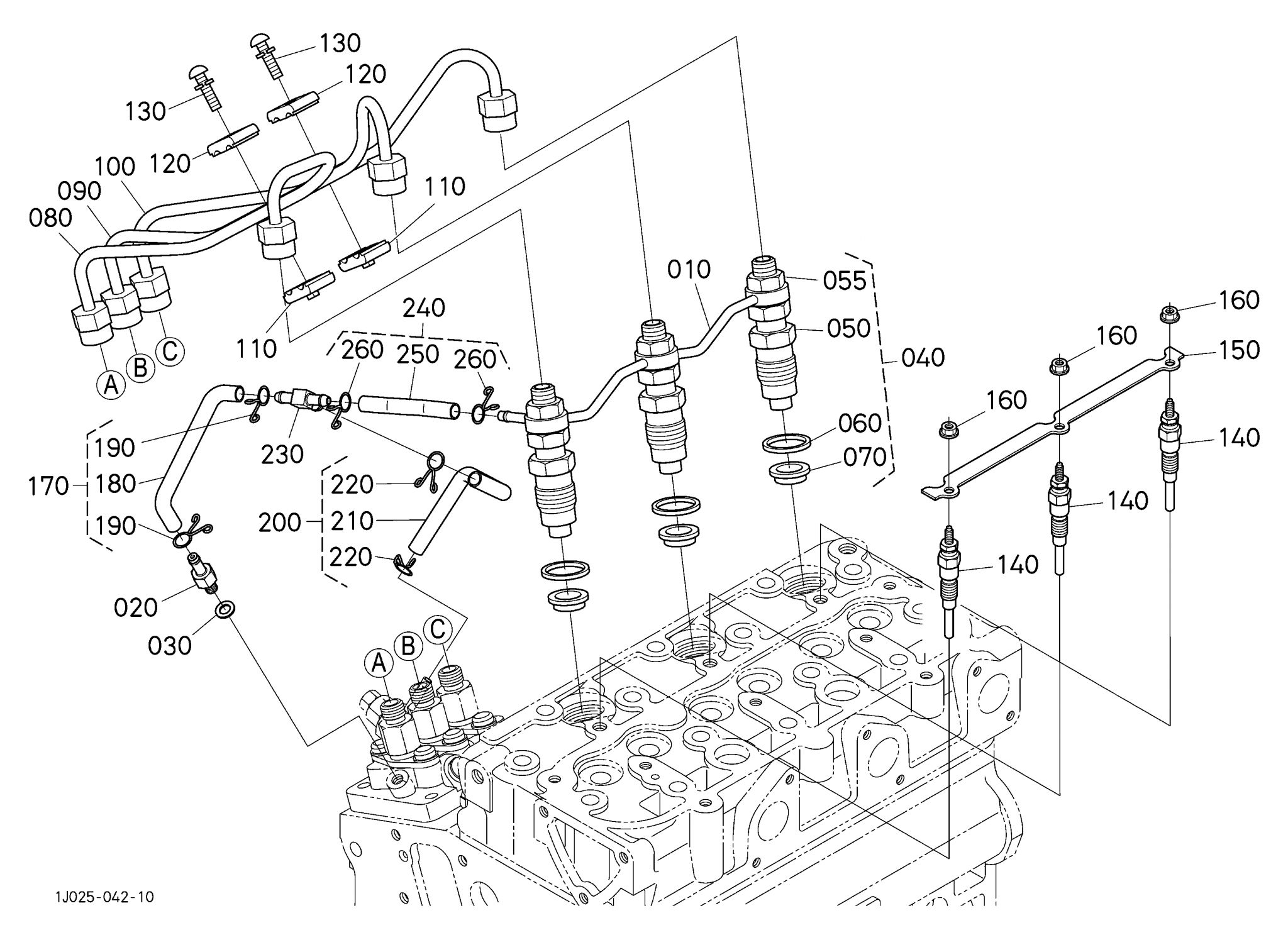

This is from the Kubota parts page.....though it appear he excess fuel goes back into the injector pump ? tube 210 kinda between 'A" and 'B' ports of the IP ??
, GreensvilleJay, to try to help. I don't think that is the diagram for my bx23. I have discovered that the rubber tubes I replaced labeled as overflow tubes. There are also overflow tubes that go from the nozzles and those tubes are all in a line. That line ends at the muffler/exhaust area with a larger rubber tube that runs all the way back to the fuel tank. Tomorrow, I am going to run some compressed air into that tube to make sure it is not clogged. Up to that point, everything seems to be freely flowing. But, I don't know for sure, so we'll see. Thanks for the tip! I'll report back when I learn more.

I think D2 and Jay are making good points. The steel lines are more likely to be the input of fuel, and the flexible rubber are returns. Before you start blowing compressed air anywhere, make sure you are not blowing anything into your injection pump! I’d hold off on that experiment until you know exactly where the leak is. You could create an expensive problem.
Do you have a shop manual? mine gave a verbal description of the fuel path with some diagrams. Between those and the Messick’s parts diagrams I could figure out how it was supposed to work. I recommend printing out the relevant parts pages and tracing things out. Colored pencils are really helpful!
The fuel pump may be on a separate page in Messicks, or may be with the engine parts. Print it out and see if there are any little arrows. See where part 210 goes relative to the inside of the fuel pump.

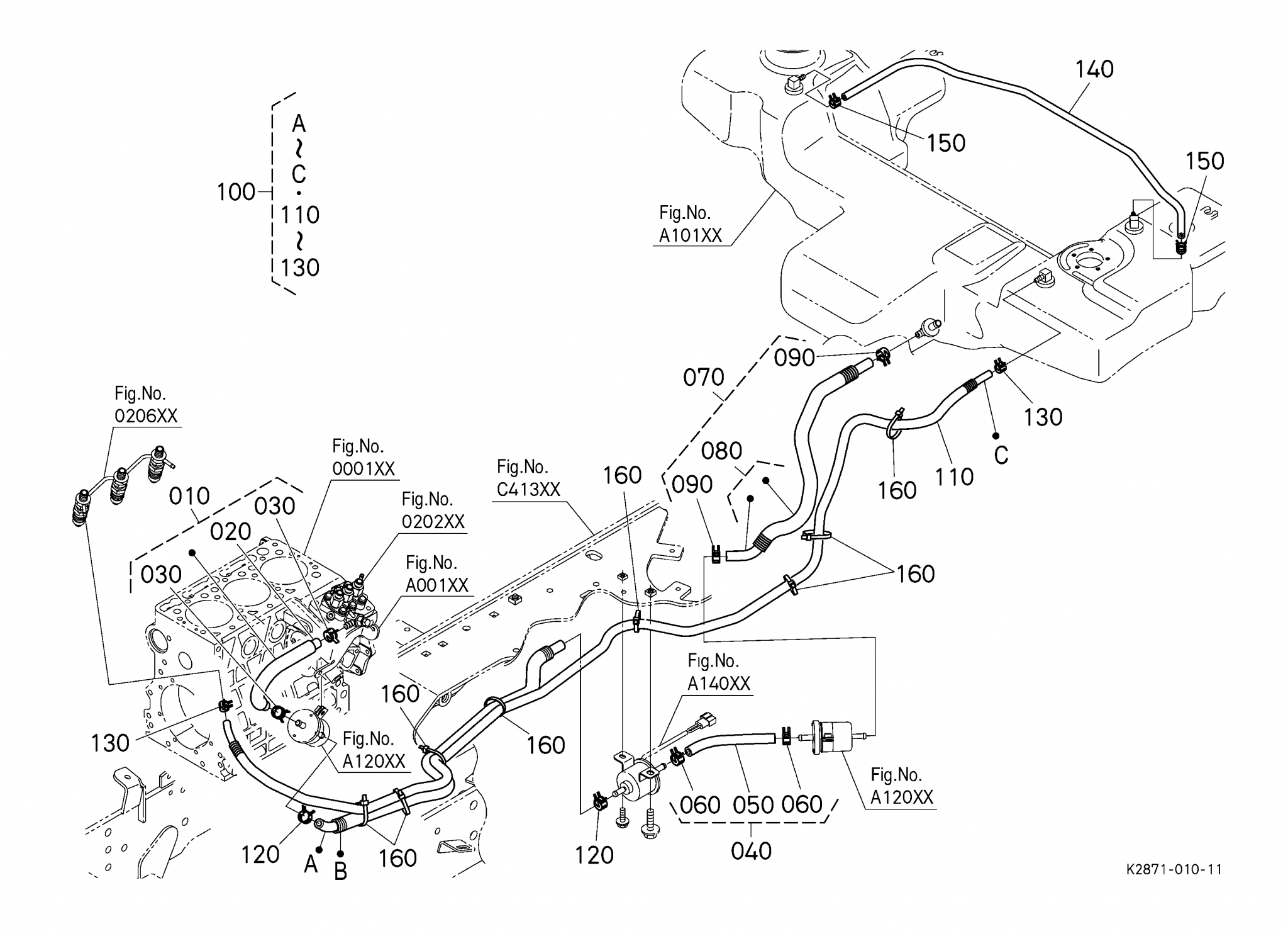

OK.....here's the fuel tank and lines drawing... #110 is the 'return hose'(my name) FROM the engine to the tank. It's attached on the FRONT injector. The 3 other hoses you replaced are on the rear injector.
I'd disconnect from the front injector and 1) see if fuel drips out of the hose then 2) blow into it.
2 might be hard as fuel will be in the line, but <5psi shop air or bicycle pump would help !
If possible have someone 'man the pump' while you listen near the tank for 1st some gurgling of fuel(purging the line), then pisss of air(line empty).
IF that doesn't happen then the fitting(follow 110->C->130-> TANK in dwg...) HAS to be plugged. How ? I have no idea but I do KNOW the steps to get to it( 'book' 1/2 day, not hard just a lot to do.....)
Now IF it IS clear, then the only thing I can see would be that an injector is blocking flow in the 'metal rail' section. You could disconnect hose at both ends of the 'rail', lightly blow and air should pass through.
sadly it's a process of elimination, good news is it's NOT the dead of winter and a ice storm.
hope this helps
