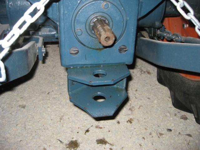

Hello,
Does anyone know where to find a trailer towing hitch for a Kubota L185? The receiver is shown in the attached picture. Thank you!

That isn't a receiver for a hitch, it is the hitch, The tongue of the trailer would go in the pocket and you would put a pin in it.
Now you could make a receiver that could fit in the pocket and extend it back to make it more usable, most just use a three point receiver to move trailers.

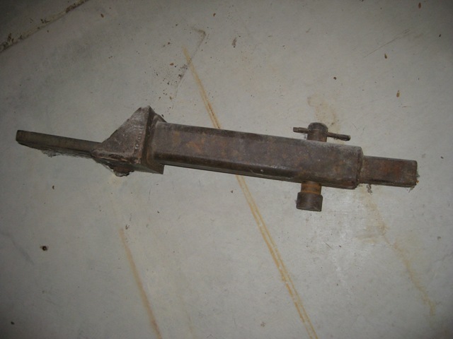

Years ago I bought L210 with the same kind of hitch set up seen below. It came with this drawbar. I have no way of knowing if it is original or not, I doubt it, but it works. The smaller ends fits in socket in the hitch and the pin drops down into the hole to hold it in. As you can see the pin has a head on it that will fit into the top hole of your hitch, but not allow it to drop through the drawbar. The cotter key keeps the pin from jumping up so it keeps the head of the pin snuggly in the top hole of your hitch. This could easily be a hair pin instead of a cotter key depending how often you want to remove the drawbar. You'll probably not find one, since I doubt if it is original, but you may be able to have a machine shop/welder copy this one. If you wanted too, you could even put a bushing in the lower hole of your hitch to keep the pin from moving back and forth. The flat extension piece on the end was just bolted onto the main part. I doubt if that part was original. Hope this helps.
