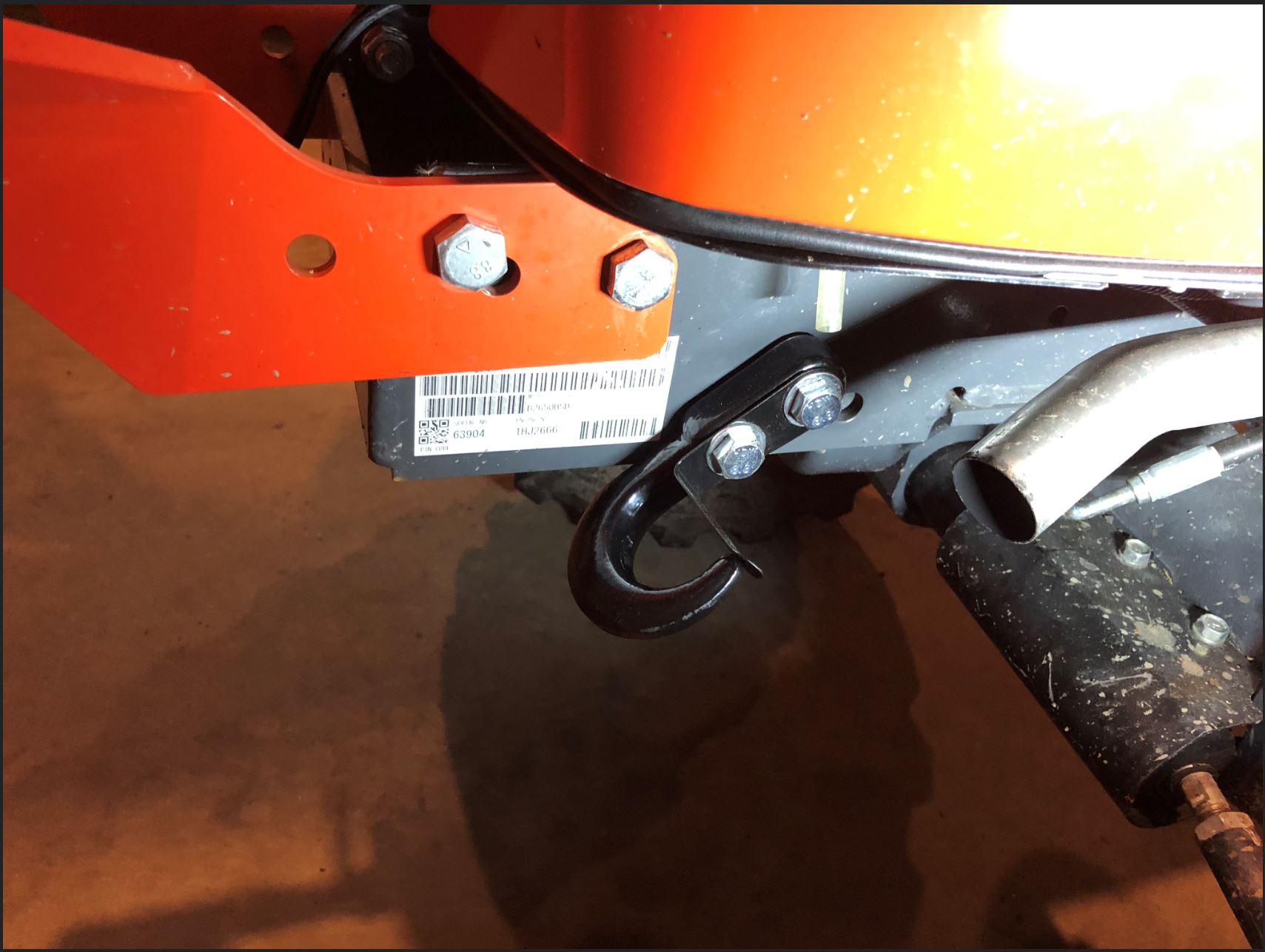

3,709
6,057
about $9 from harbor freight. no drilling, they fit perfectly. I put them on both sides and it works well for chaining to trailer.
