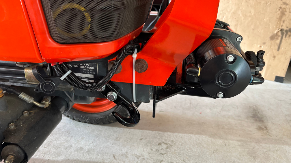

I used the HF tow hooks as well. Serves dual purposes...tie downs, and winch rope return off snatch block.

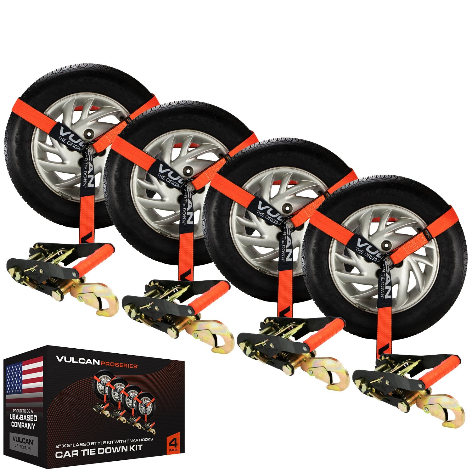

I must cheat. I just use lasso type tire ratchet straps to hold my B2650 to the trailer. Rock solid, and no sharp edges to chafe the straps. Each strap is rated to 3,300#. Well above the weight of my little machine. Strap goes on each corner.

I’m sure they work I’m lazy and slapping a hook on and ratcheting looks easyer than using those. I might be totally wrong.

I couldn’t agree more on a larger machine! But with my little B2650, it’s a little bit of a challenge to use chains from a point on the frame. I did that for a while, but I had to have it perfectly positioned on the trailer so my chains would have a straight shot to the tie down points. The bucket, tires, or rear implements would often obstruct my clear shot to the tie down.
Since I started using the tire straps, that’s no longer an issue. Good solution for smaller machines.
