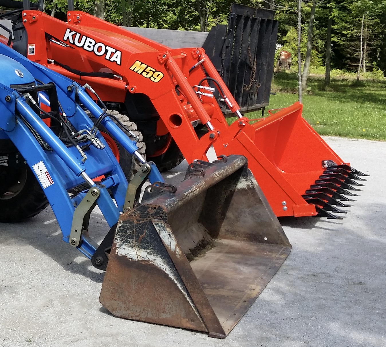

I bought one of those over the bucket tooth bars when I bought my M59. I took it off after trying it a couple of times and found it was only good for getting jammed full of grass and roots and making a mess. I took it off and it's been in the corner of my barn since.
I'd go welded on teeth or try the piranha bar that bolted flush to the bucket. The over the lip style sucks.

No no, it's really good you might like it!
I just don't like how it hangs down about 4 inches below the bucket edge. It's a universal bucket tooth design so there is a gap all around the tooth. On the bottom edge it's basically a hook. All the crud gets stuck between the tooth and bucket edge.
I'll sell it to you for what I paid for it in 2015. Probably half price of what they are selling for now post covid!

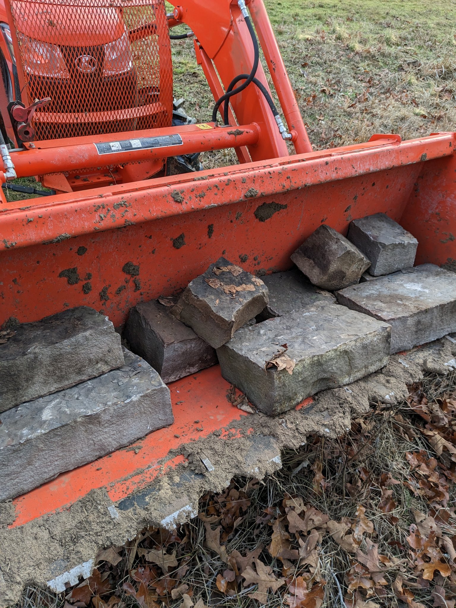

I have been pleased with my BXpanded Piranha bar. It arrived sharp, and it remains sharp despite being used in hard red Georgia clay with lots of softball to football sized rocks for over two years.
Same here. There may be others just as good, but I have zero complaints about my Piranha. It works very well, and it's no big deal to take it off or put it on.
Make a night and day difference when digging.

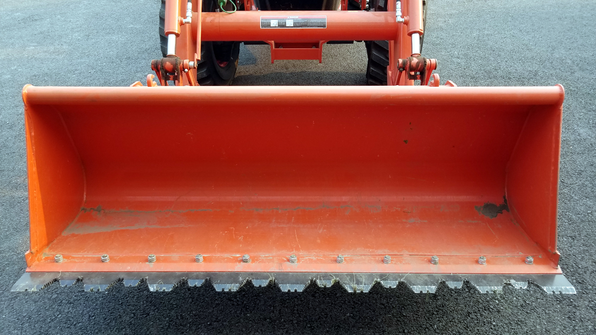

I could honestly see that working for applications the don’t involve back dragging or dealing with vegetation. For my purposes vegetation both above and below ground is part of the issue. I can see why that would be less than ideal for roots and grass. Likely no more effective than the gap toothed grapple I already have. And I thought about using the grapple but it’s a long bottom style that’s great for carrying brush and logs but not great as a root rake style for raking roots being it has to be curled pretty far forward to engage the teeth. It also won’t move dirt so I’d be swapping grapple/bucket constantly if I don’t have something on the bucket to more adequately deal with roots.
I am happier with this

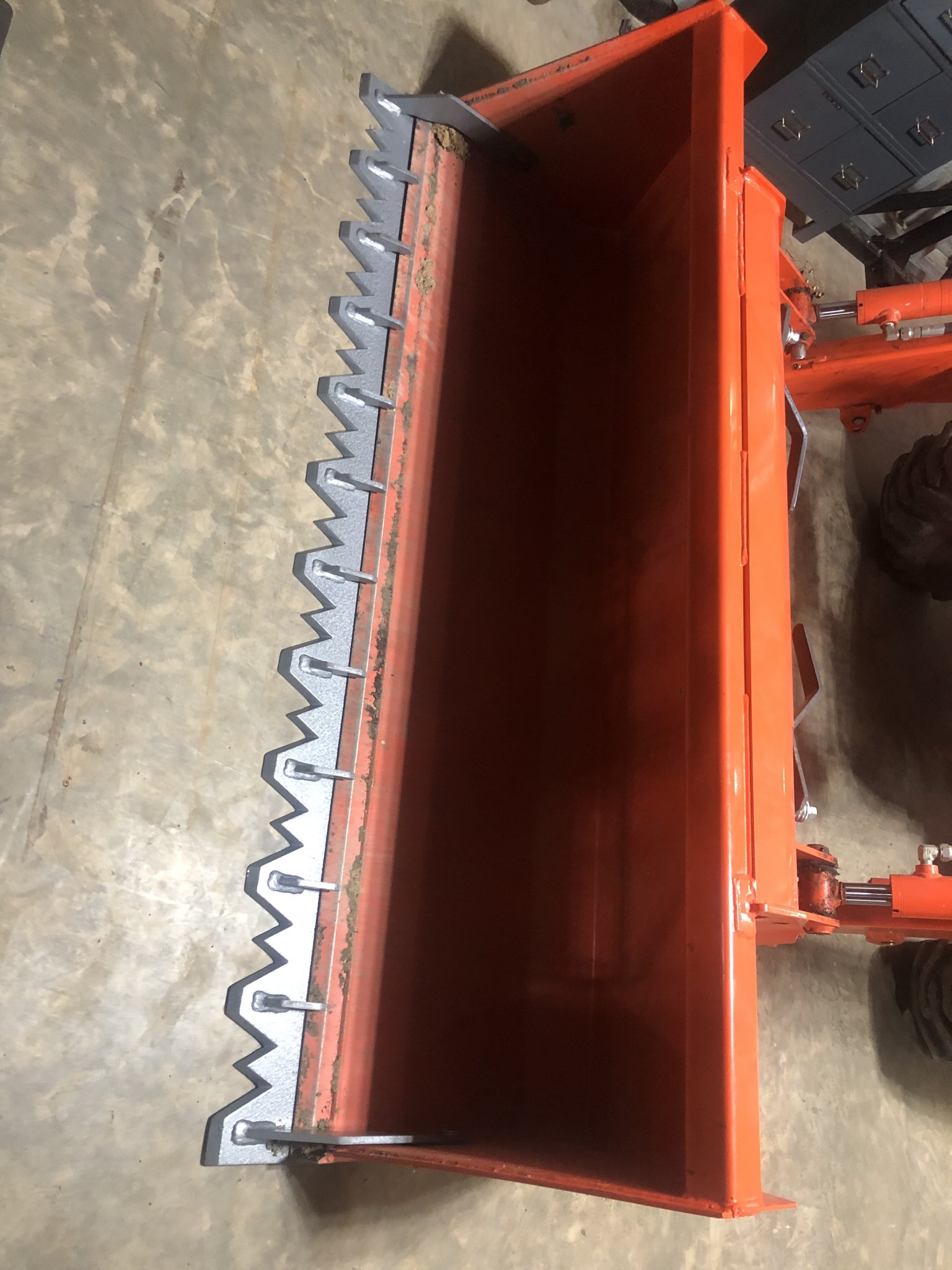

I started this so I suppose an update is appropriate. BXpanded Pirahna arrived today. Didn’t take time after work to fully install but had to at least see if it fit. Fits perfectly. Just need to punch a couple of holes in the sides of the bucket and it should be ready for action. I have a few projects for it but nothing immediate. If I can remember to do it I’ll follow up with a comparison of performance with and without the tooth bar. I have high hopes for its ability to cut roots and pop out small (3” and under) trees.

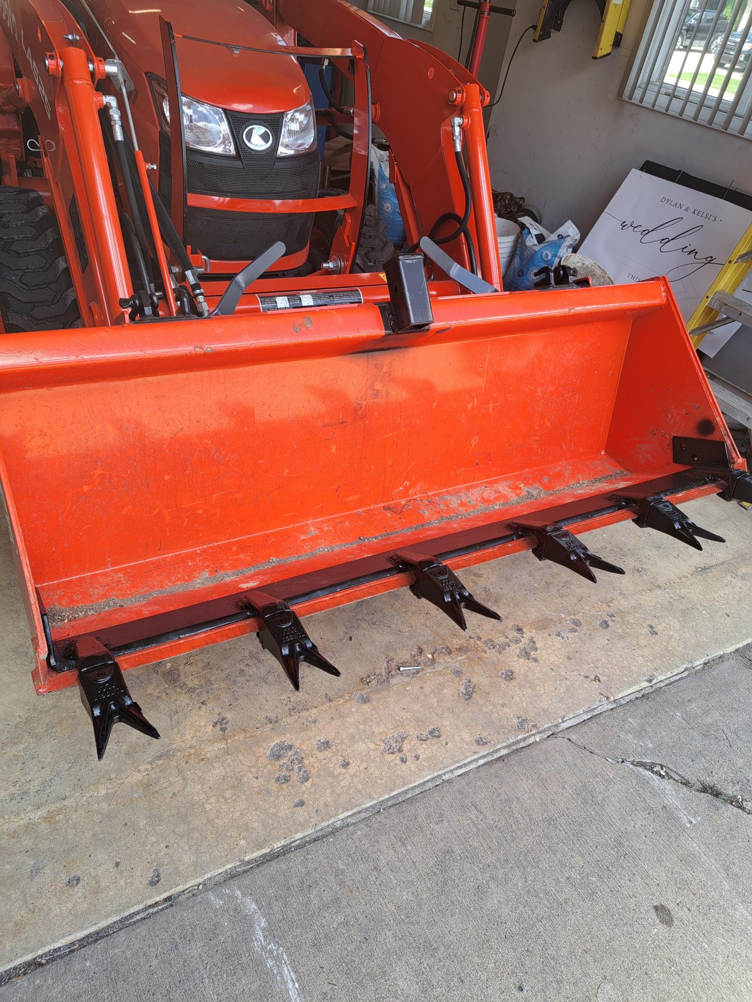

I have a Heavy Hitch toothbar and like that I didn't have to drill any holes in the bucket; just held in place by screwing down the retaining bolts. I also like that the teeth on it are replaceable making long term use and maintenance easier compared to the others.
