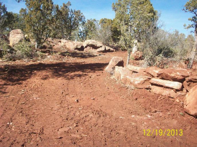

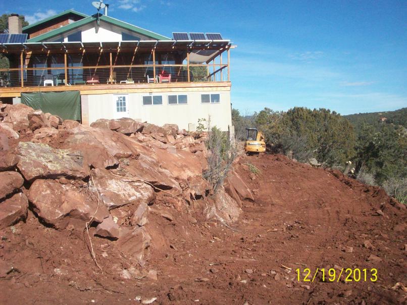

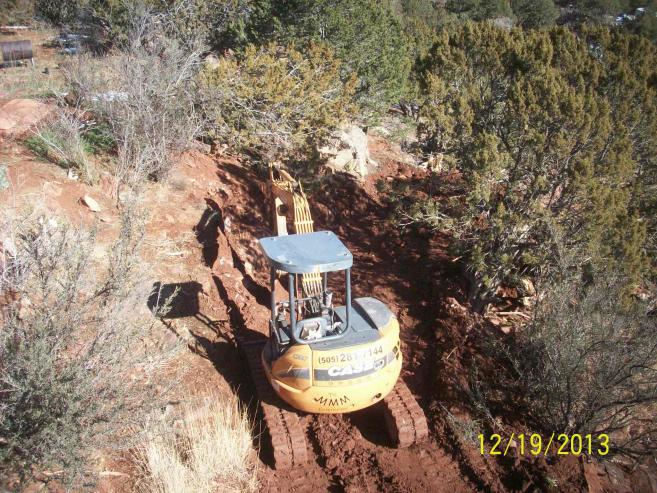

Attached are two pics to give you an idea of kind of terrain I'm talking about. I borrowed the contractors tractor to move a large rock on the third pic. I don't plan on working with boulders of this size with my tractor! The red dirt is calichi (?) clay that turns into snot when wet!

If you plan to move boulders the size of the one in the bucket of that Case front end loader then the biggest L series Kubota makes wont be big enough for you. You're probably looking at a good 800-900 pounds for that one bolder. That Case has a 6500lbs lift capacity.

Thanks for your reply. No, I hope my days of moving boulders of that size are over! The Mini Ex contractor did all that heavy work so all I got left to do is to work with smaller size rocks.

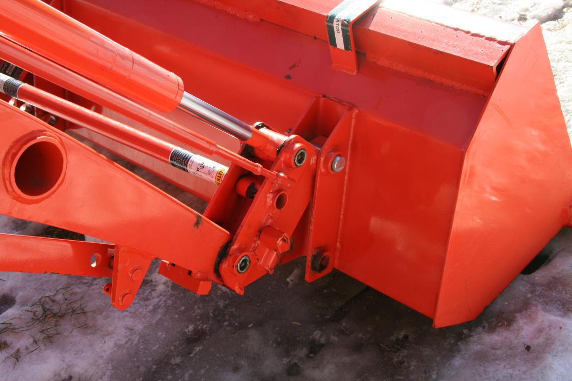

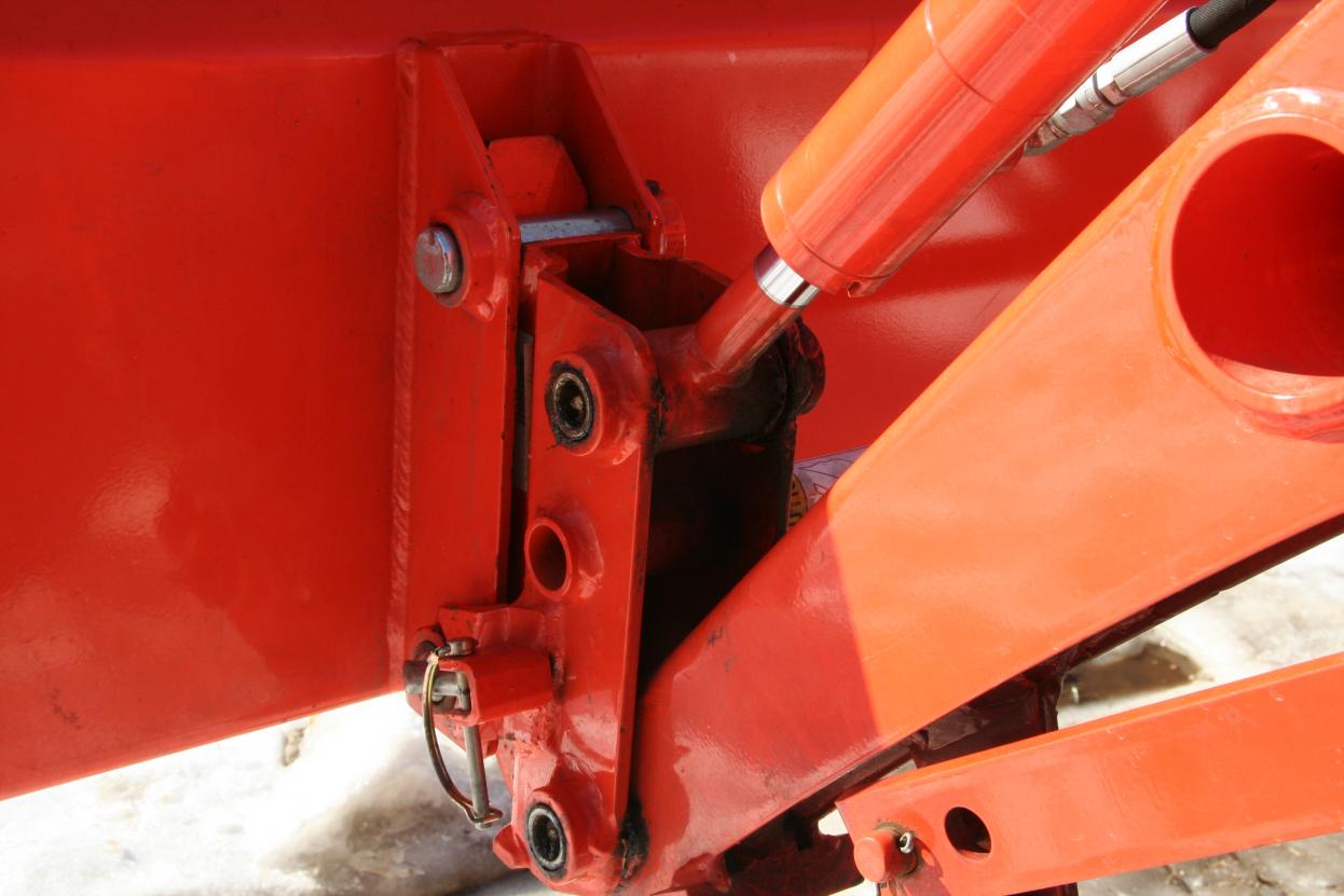

There is a kubota quick coupler for the bucket and forks. It is not the "skid steer" style coupler. It uses the original pins of the bucket and forks. You leave the top pins in place. The coupler has a hook that the top pins sets in then you manually put the bottom pin in. I have it on my 2012 B2920 and it works great. Simple and easy to use. I have both a bucket and the Kubota adjustable with forks. It takes a few seconds longer to use than a "skid steer" style coupler that has one handle to lock and unlock the coupler, plus you have to walk from one side to the other. When it warms up here a little more, I will try to get some pictures of it and post them. I like it, the kubota forks a way better than those clamp on forks. You can see the fork better and the clamp bolts will loosen up as you use them and the forks will move around on you.

Ok, thank you gents for the explanation. I agree, I prefer the Kubota forks over the clamp on type. I believe the quick coupler stays on the tractor and you simply swap the forks or the bucket as needed. Correct?
Seems like the 2920 does not have this feature, however :(

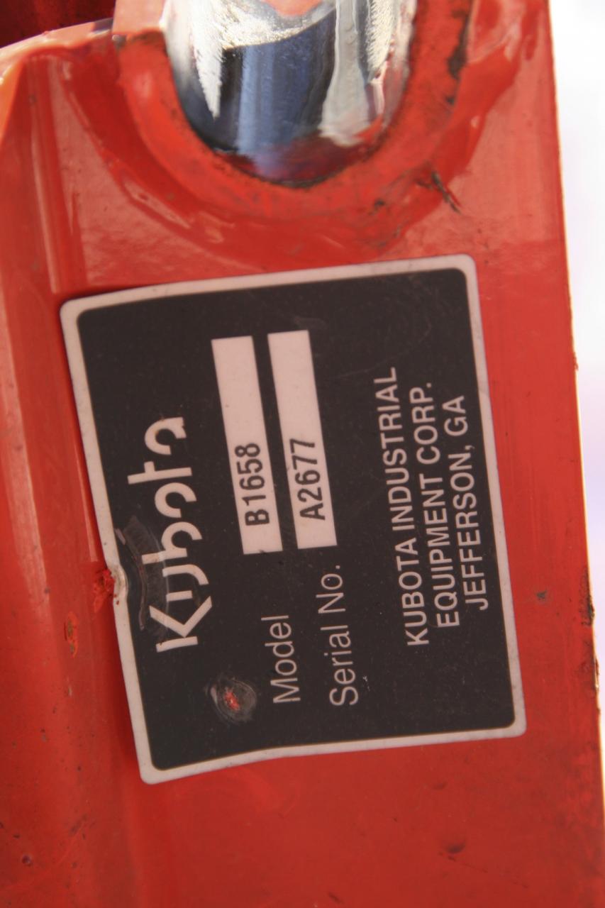

Here is some pictures of the Kubota pin type quick coupler on my B2920. The quick coupler unit does stay on the loader all the time. I swap between my bucket and forks all the time with ease. I included a picture of the model number plate.

With the hills that I have and from the pictures that you have what ever you do get the hydrastatic (HST) transmission. When using it in the hills you never have to clutch it or go into neutral. Much safer.. Also spread your tires out as far as possible and have them loaded, filled. This will give you better traction and better stability. And last but most important read every thing you can on safety, ALWAYS carry you loader as low as possible. You would be surprised at how fast you can be up on two wheels even with the bucket 3 feet above ground level (been there, done that) Good luck
