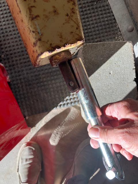

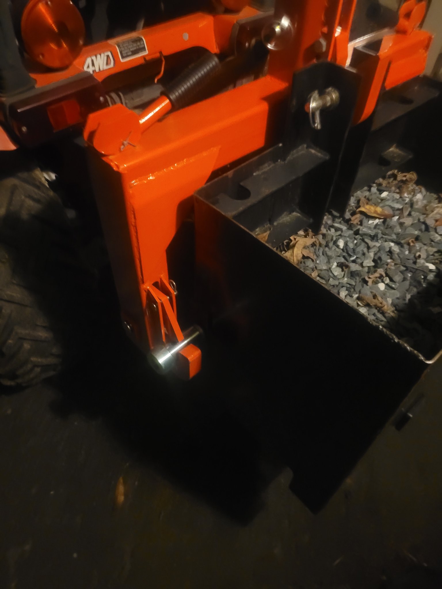

Got my bushings in. Seems these bushings are for larger tractors, not type I. Slid this big hulking piece over the smaller pins on the ballast box for now but not fond of this. Will try to figure this out. Pics for you to view.

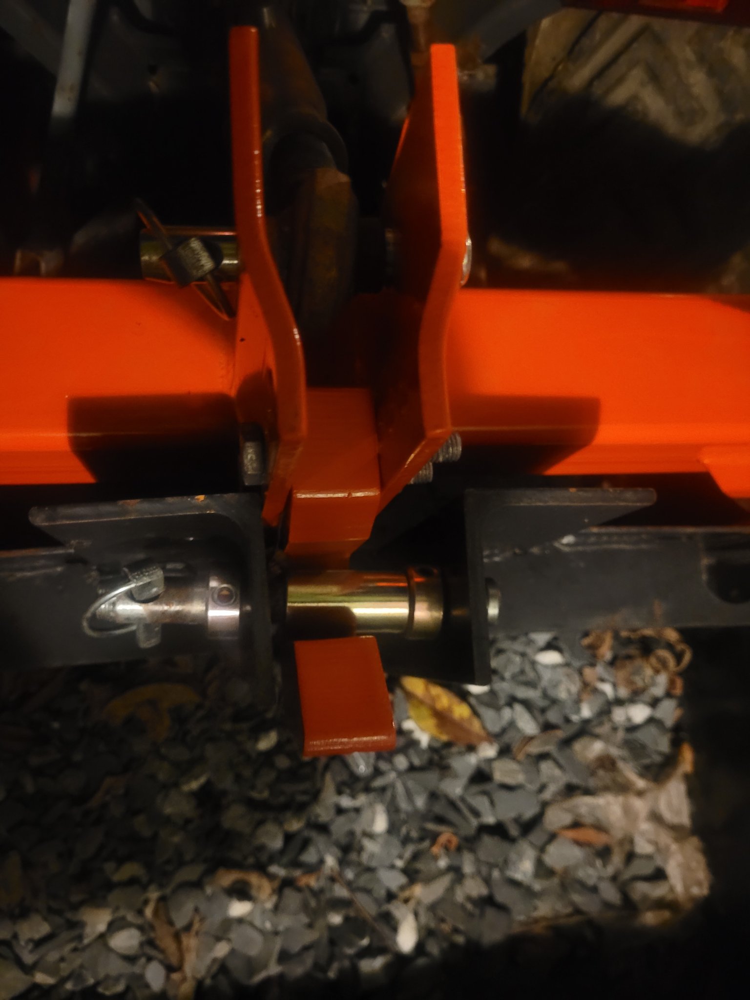

They're on backwards. Fat end goes out. Did you drive spring pins in?

If I go the other way, it will slip off. This pins to pound in don't pound it. Tried. Need king kong to pound them in. Am looking at trying a different way though. The sleeves that came with it doesn't go inside the big arse piece thats shown in the picture.

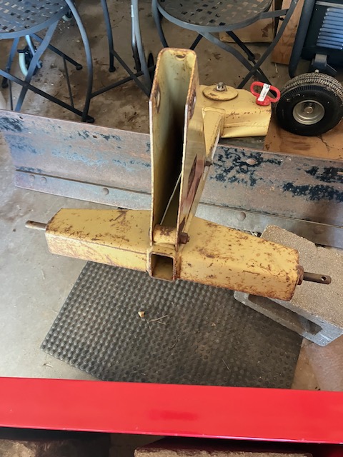

My back blade can't use any of the stuff I bought. Thinking of getting a 30 inch rod to run through to use.

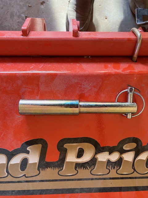

Those posts (pins) are meant to connect direct to a 3 point hitch. However, if you are using a quick hitch, many quick hitches have a larger "U" that may require a slip-on Bushing that's held to the pin with a roll-pin.
Once the Bushing is installed (on that implement) you never remove them, the implement is always ready to connect to the quick hitch after. Once this is done this way, the pin with the circlip (lynch pin) is not used with "this implement" at all.

Thanks for the video. I'll verify tonight but think I was sent class II bushings from what the video show.The ballast box has smaller post with a thin bushing.

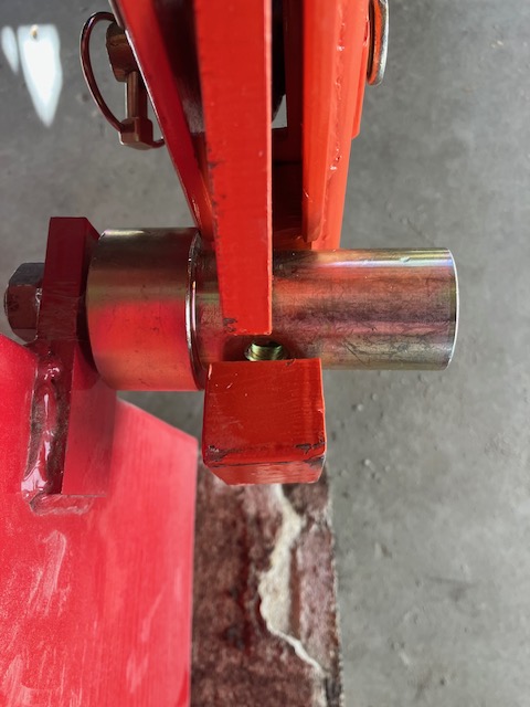

Very possible you got the wrong bushings. For future reference which helped me early on, Class 1=Cat1, Class2=Cat2. Your BXs 3-Point is rated Cat1.
Some implements are universal which can be used in both Cat1/Cat2. A way to spot this is they have three ears on each side at the lower 3PH connection. This is where the long pin/short sleeve is used, and an additional (larger inside diameter) short bushing slipped over that.
When it comes to implements, there a several ways to make it work. This is where you might benefit from physically "seeing" all available at your local Tractor Supply or other Farm and Implement store.

Here is a pic with my index finger all the way in. So, this is a class II?
