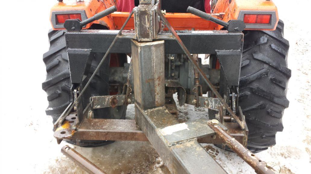

I just have them on the front's, I have an odd set of shallow double treaded low profile flotation tires on the rears. I have chains for them but need wheel spacers to clear the fenders. I also still need to ballast them.
They have proven to give me excellent traction on both the snow and Ice.
Rear tires
